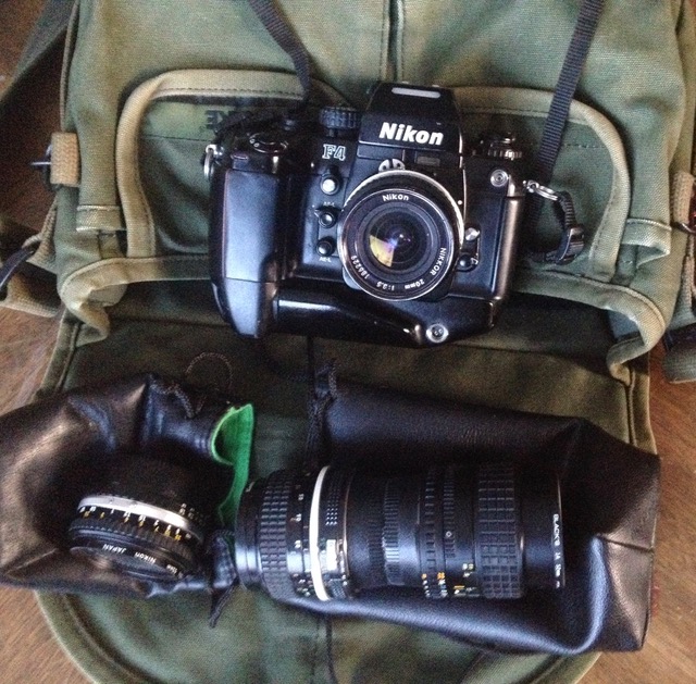

Here's my recent film kit, in a Domke 803 satchel. Lenses are 20f3.5, 28f3.5, 50f1.8E, 100f2.8E.
Two of the rear caps are glued together for the 28 and 100mm lenses on the right.

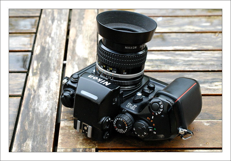

More F4s porn:

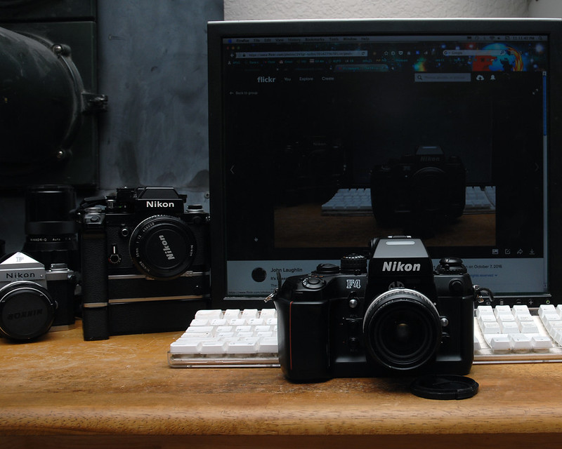

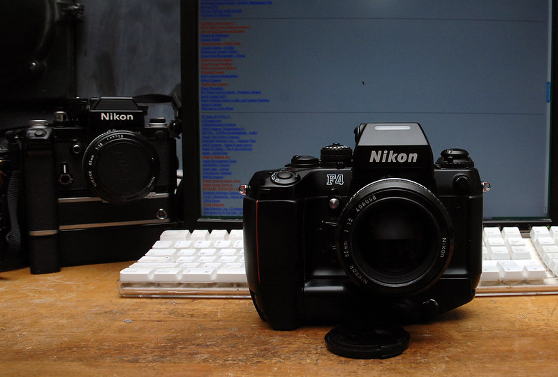

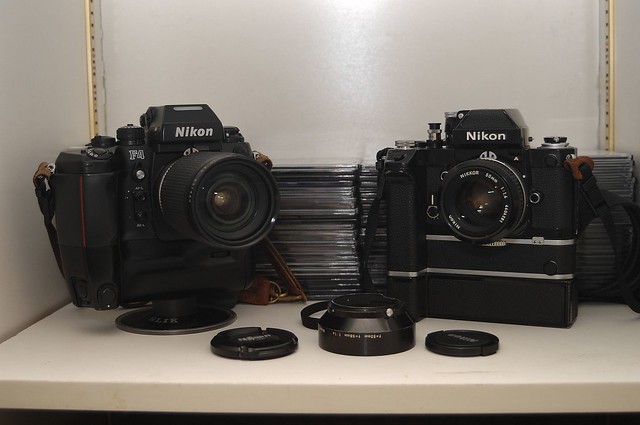

Mine in the various configurations it has been in...
Stock configuration, with 55/1.2 AI hanging off the front - just after being picked up last fall:
With MB-23 pack and a 35-135 AIS Zoom-Nikkor (photo taken about 6 years ago - between then and now, it belonged to another APUG member, then bounced around the Seattle area before winding up at Kenmore Camera a few months ago, this time with a working LCD illuminator):
And, as it sits now, with the MB-20 and my old 24/2 AI mounted:
Common theme seems to be that there's a motor driven F2 in all of the photos...
-J
