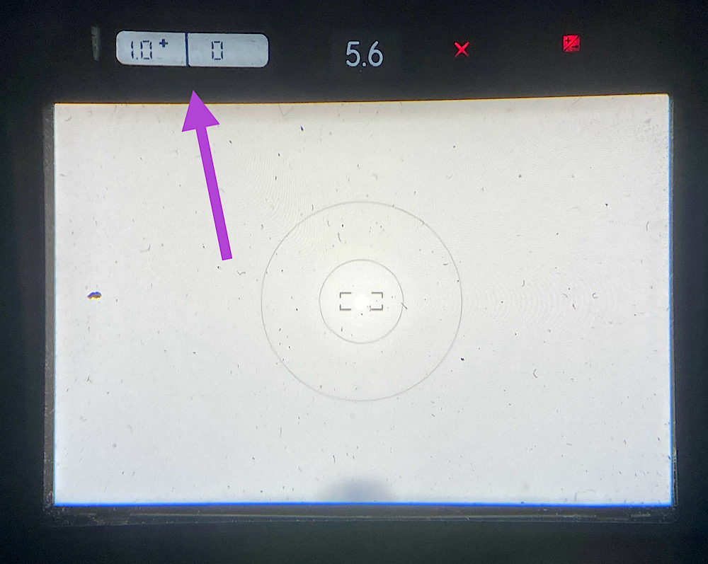

Clearly used extensively, signs of use, but with a flawless viewfinder LCD at the top and a LCD at the bottom with only a small dark spot.
Unfortunately, the fact that the LCDs can get black and colorful spots over the decades - the so called „LCD bleeding“ - is a weak point of the F4.
The two automatic programs and shutter priority do not work. The camera exposes everything with the smallest aperture that must be preset for automatic shooting. So an irreparable damage, at least for me.

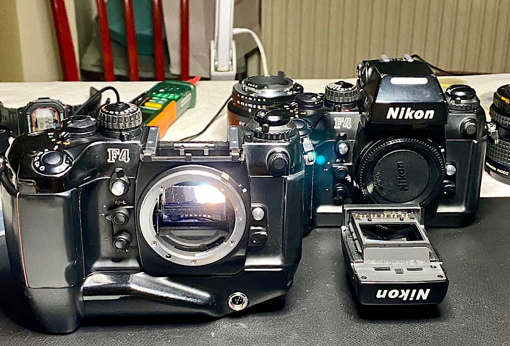

Since I have a second F4 that works, but both LCDs are badly bleeding, I decided to replace the LCDs.
The bottom LCD
was easy to replace as I only had to exchange the DP-20 viewfinder which is intended to be exchanged with other viewfinders. The LCD is integrated in the viewfinder and shows, among other things, exposure time, aperture, exposure metering mode and adjustment for manual exposure setting.

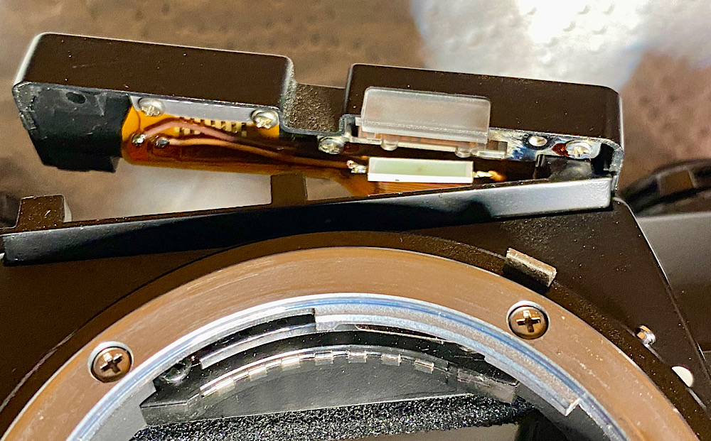

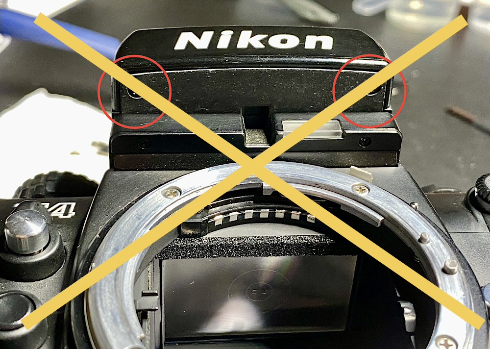

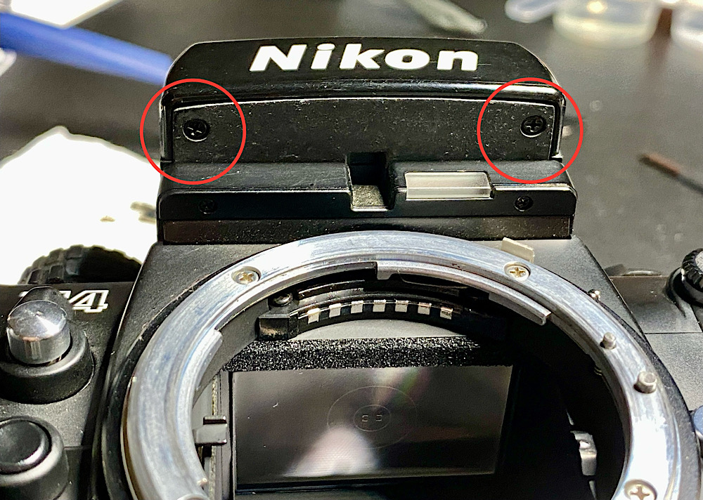

To access the upper LCD (on the left), these screws are loosened.

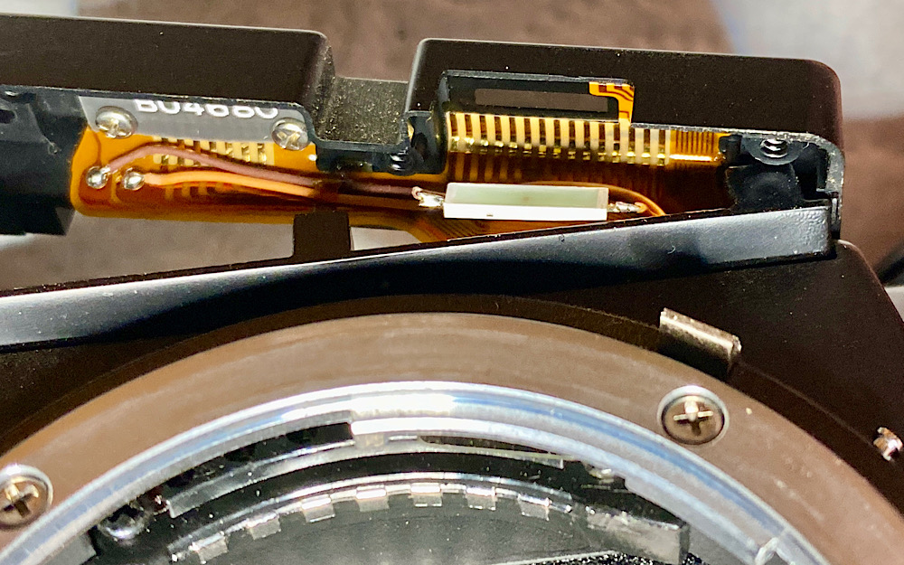

The unit with the LCD, its electronic illumination, the prism for light entry and the LEDs for focus and exposure correction (on the left) hangs on a flexible circuit board after the screws have been loosened. The bottom cover is already detached.

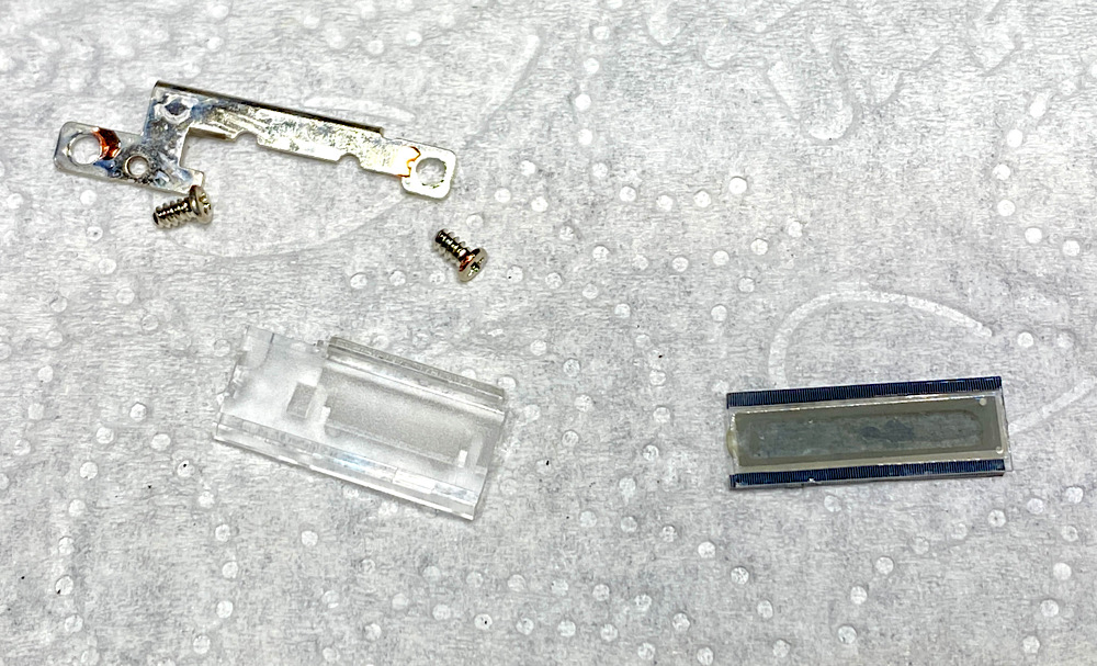

The LCD lies with its conductive rubbers on the contacts on the flexible circuit board. Above this is the prism, which is fixed by a bracket with two screws. The bracket, prism and LCD are already removed here.
The electronic illuminator lies on the prism and hangs on two cables. It can be seen here, the bright flat cuboid.

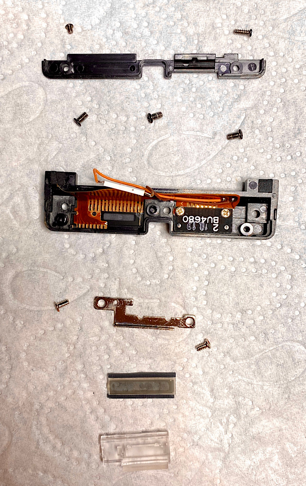

All disassembled parts at a glance.
These are the components from the donor F4. Only the LCD (defective) is from the acceptor F4.
Since the camera has already become a spare parts donor, I disconnected the unit with the replacement LCD in order to be able to work on it better. For this I cut the flexible circuit board.

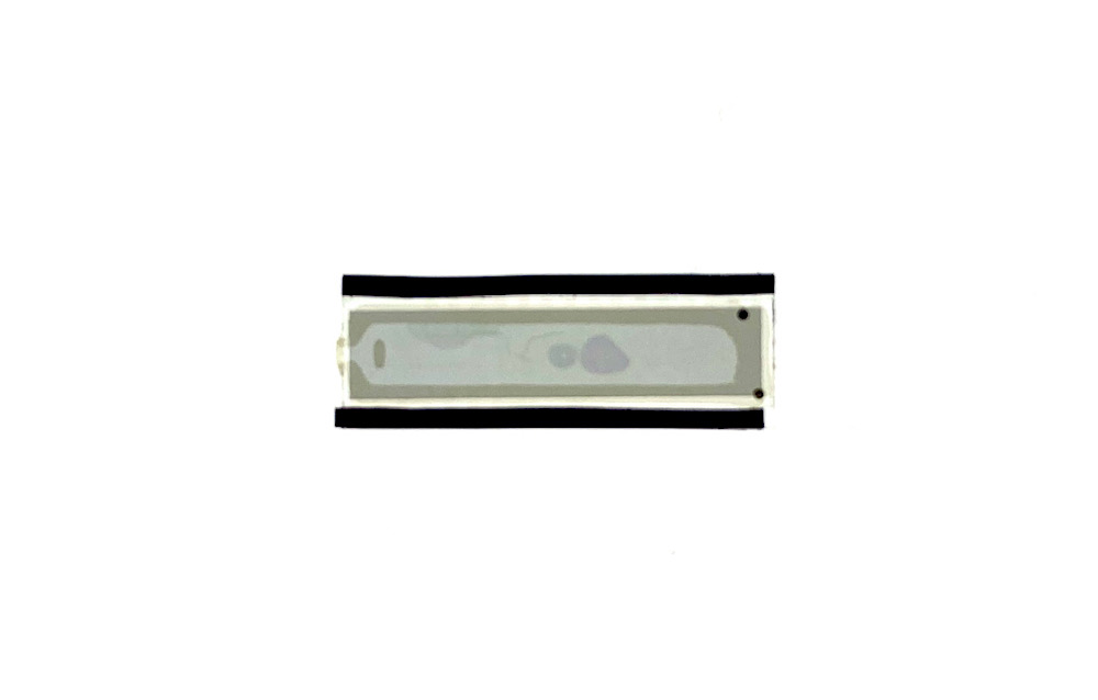

The broken display. If there is voltage, the light gray spots turn black. This means that the digits can no longer be read at this point.

On the left the spare F4S and on the right the F4 with two - almost - new LCD.

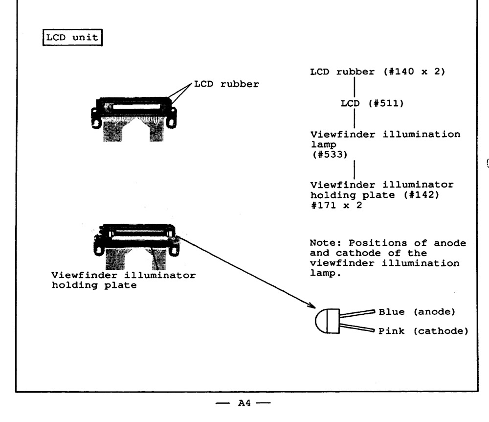

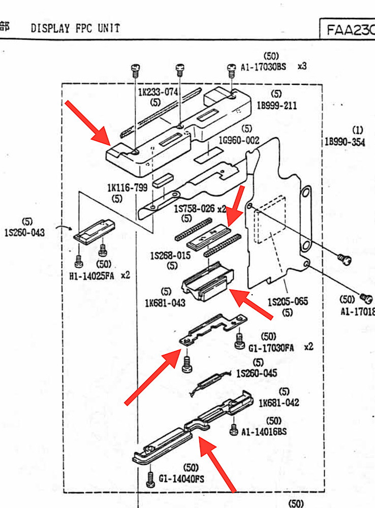

From the service manual for the Nikon F4 (page 9 in the PDF). Only the marked parts need to be removed or detached.
The LCD is connected to the contacts on the board via two conductive rubbers and just rests there.
On my F4, the conductive rubbers stuck to the contacts a bit, so I carefully lifted out the LCD with an angled probe.
Be careful not to detach the conductive rubbers from the LCD and ensure that the LCD is then installed sideways accurate to side. In my example I saw impressions of the contact rows in the conductive rubbers, which helped with orientation.
The flexible printed circuit board, on which the entire unit hangs on the housing after loosening the three fastening screws, is robust but must not be bent or pinched. It can be pulled out carefully a little and then pushed back into the housing.
It's best to study the setup on your donor camera and take photos/notes as always.

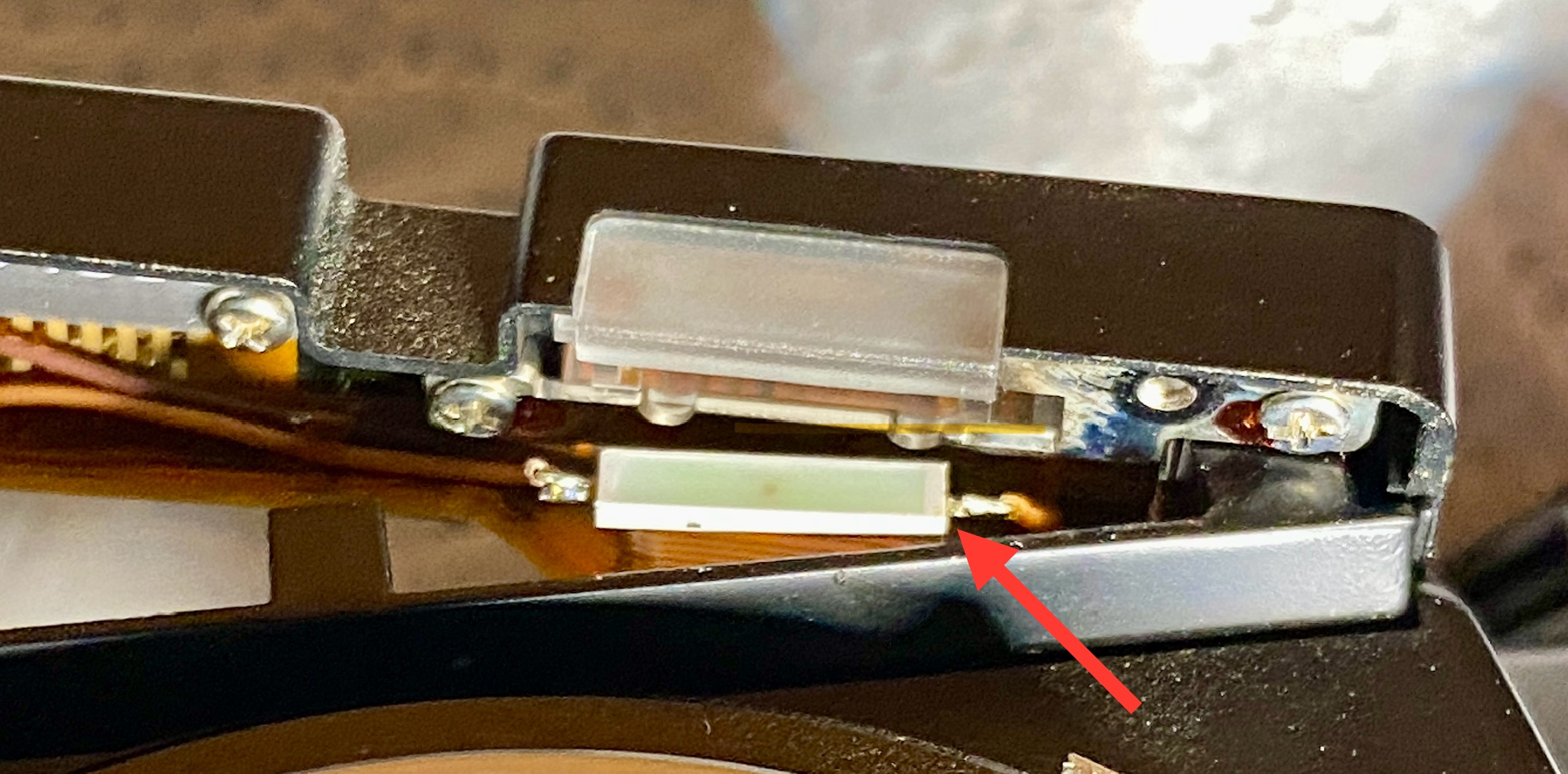

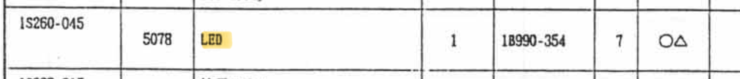

The electronic illuminator is interesting. I think it's an LED behind a turquoise green cover. The light source is point-shaped. Maybe @koraks knows more about this.
The larger LCD in the DP-20 viewfinder has its own illumination, which is also turquoise green. This is also likely to be an LED, as the anode and cathode are labeled.

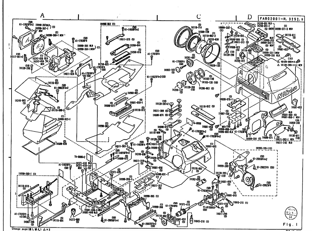

(Page 15, PDF)

The LED, the small dot in the middle of the illuminator, is probably cast into the turquoise green mask.
