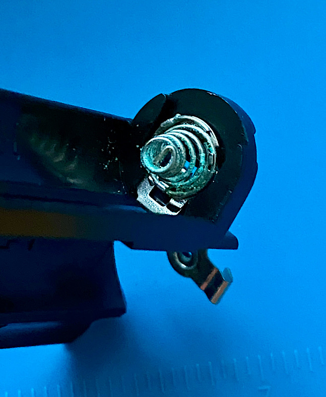

  • The battery holder is badly damaged and corroded. This would explain a problem with the power supply.

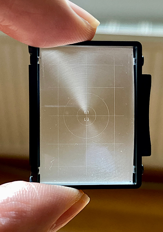

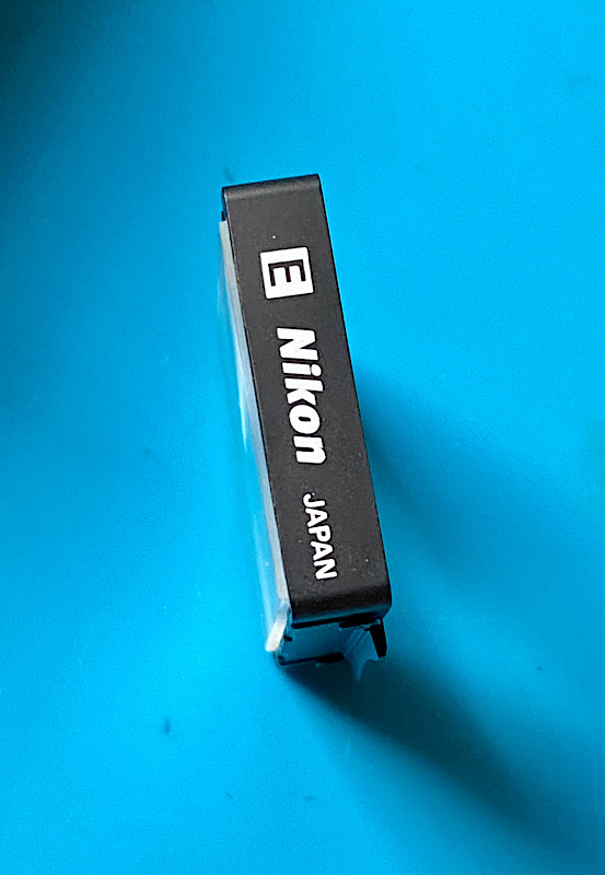

  • A focusing screen E is inserted in perfect condition.

  • I have a replacement for the battery holder.
