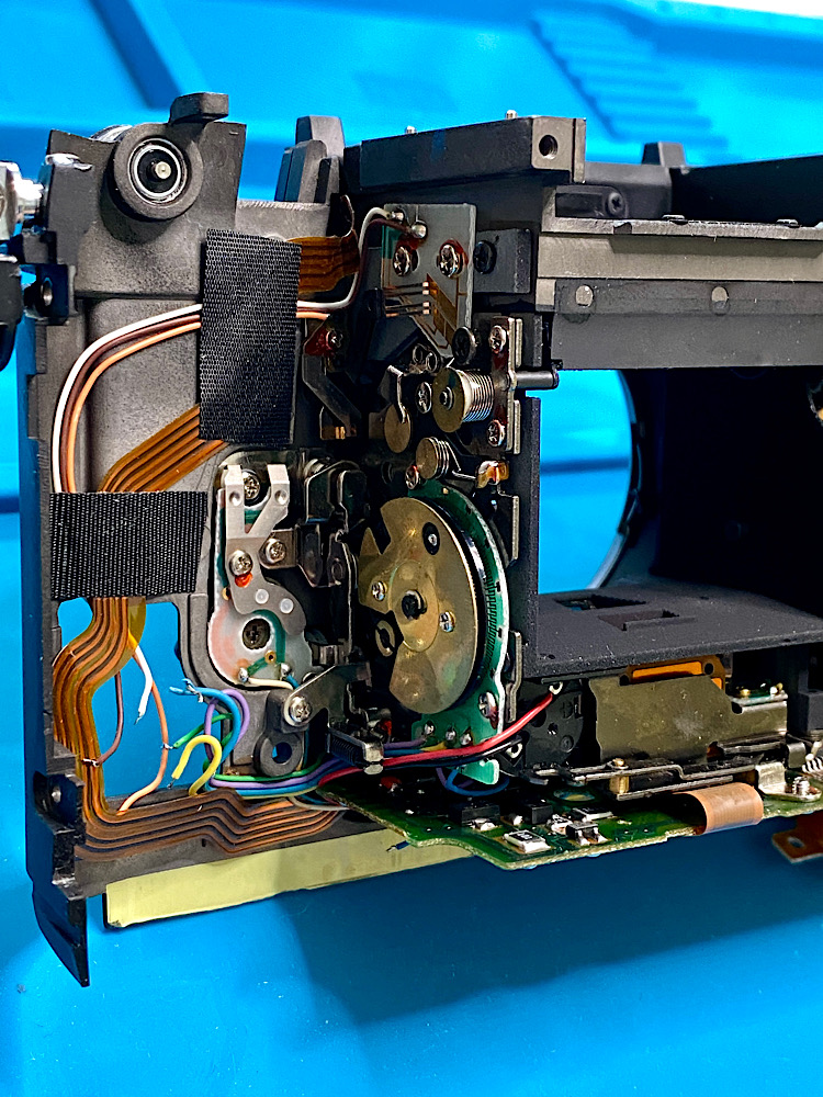

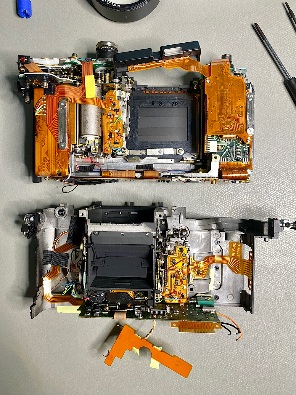

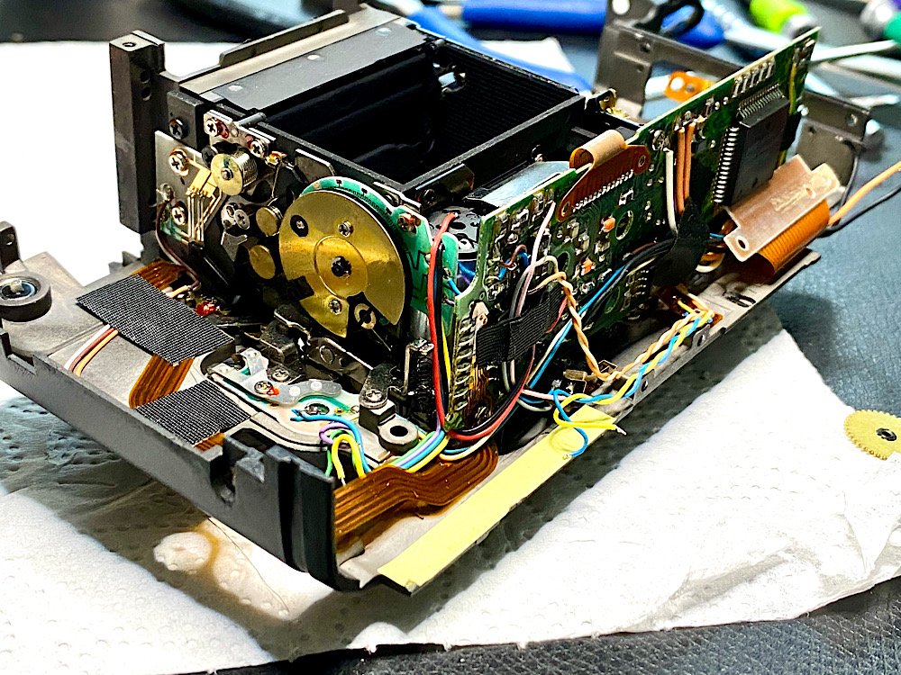

Thanks! I’ve seen your posts on the aperture lever regrease and I’m considering following it to do both the regrease and service on the AF motor if possible. Ebay has F4s for parts very cheap and that’s the option go to for I think.

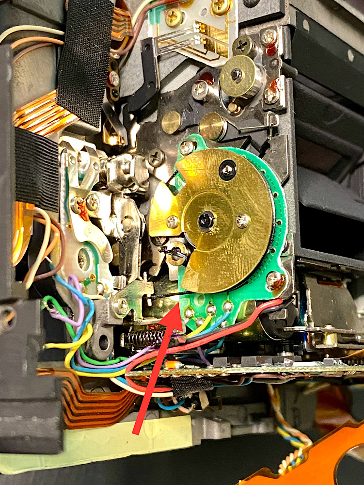

AF coupler area in the mirror box:
Please ignore the arrow.
For more photos of the interior, see my various posts on the Nikon F4, F4S and F4E.

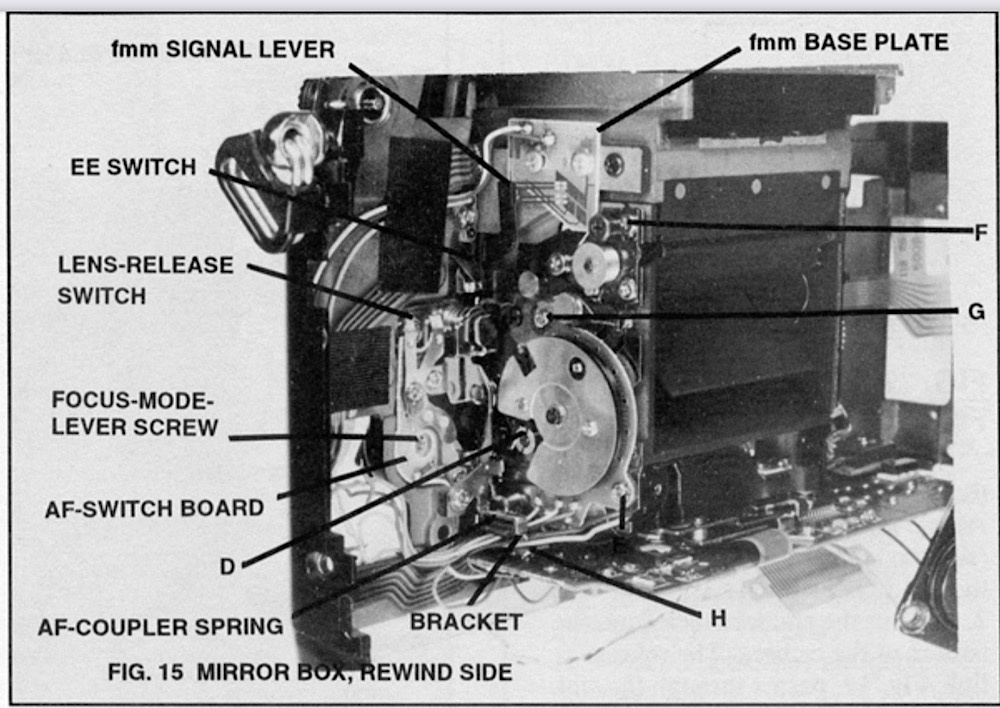

As far as I know, the AF cannot be adjusted without Nikon software. See the SPT repair article (link above) and the Nikon Service Manual for the F4:
