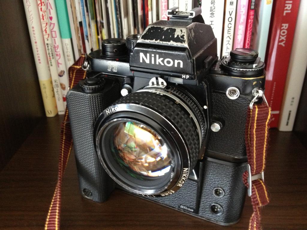

sangetsu
Apr 28, 2009
214
東京
I have the F, F2, and F3. I had an FM3A, but I never bonded with it. I prefer the bigger "pro" bodies. All of mine have seen decades of use with no repairs or service required.
