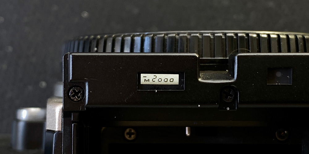

With my most beautiful F3/T (never used before), I had to watch the LCD display in the viewfinder slowly but steadily disappear.
At first, only individual digits failed - eg. the plus sign was no longer displayed in the event of overexposure.
Well, I could get by with that, although not ideally.
But then all the digits started to fade.
Today I saw that whole digits are no longer displayed completely.
This nice F3/T could therefore only be used with an external exposure meter or for the closet.

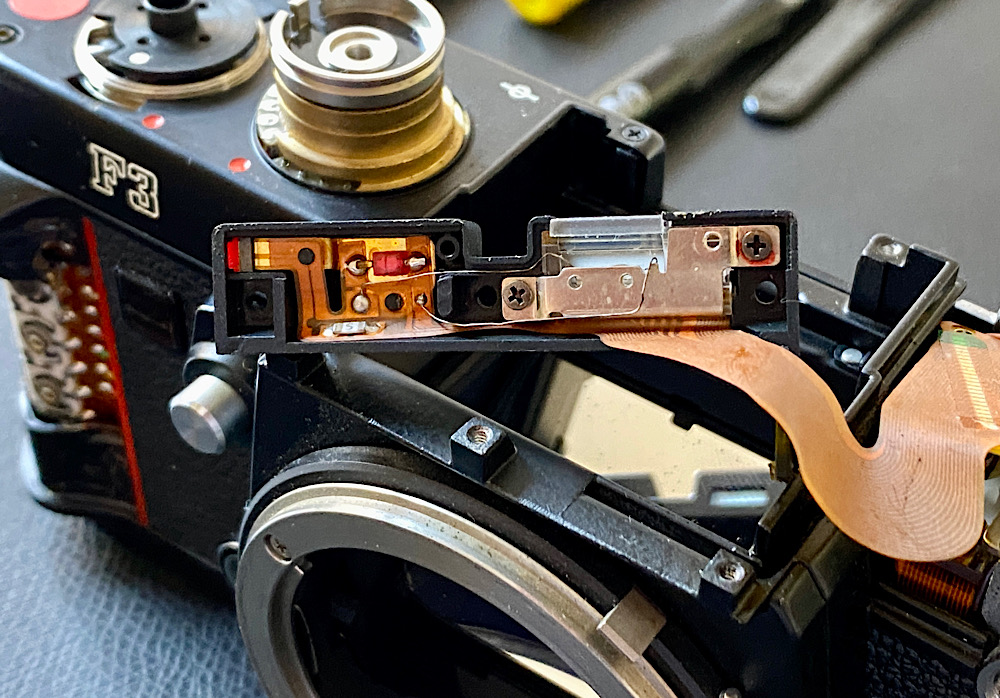

Here is the unit with the bottom cover already removed:
In detail - the famous red button for illuminating the LCD on the far left.

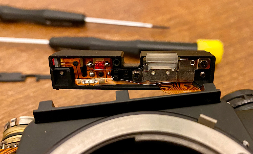

On the right the still covered LCD block with the light inlet to the outside for the display:

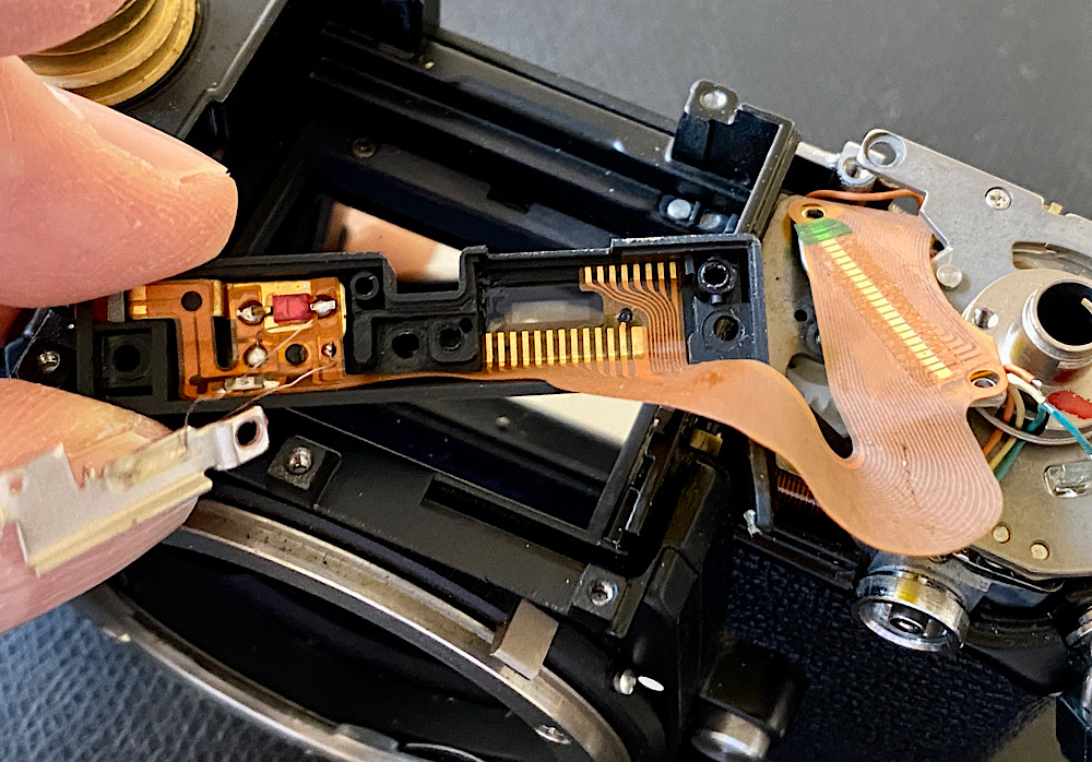

After removing the cover plate, the LCD block can be seen:
The LCD block can be easily pulled out.
Below the contact strips located on the board:

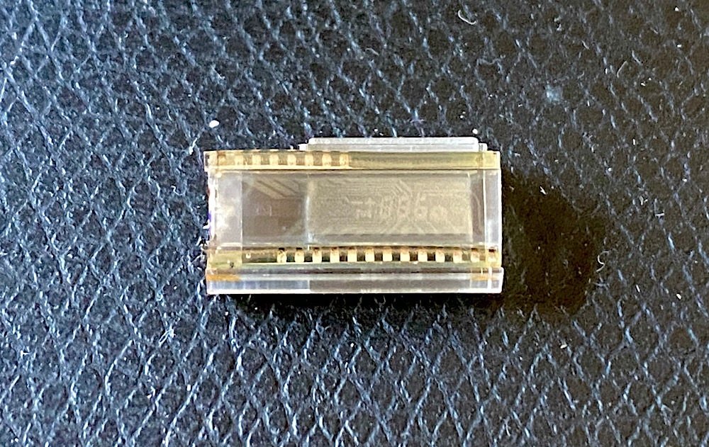

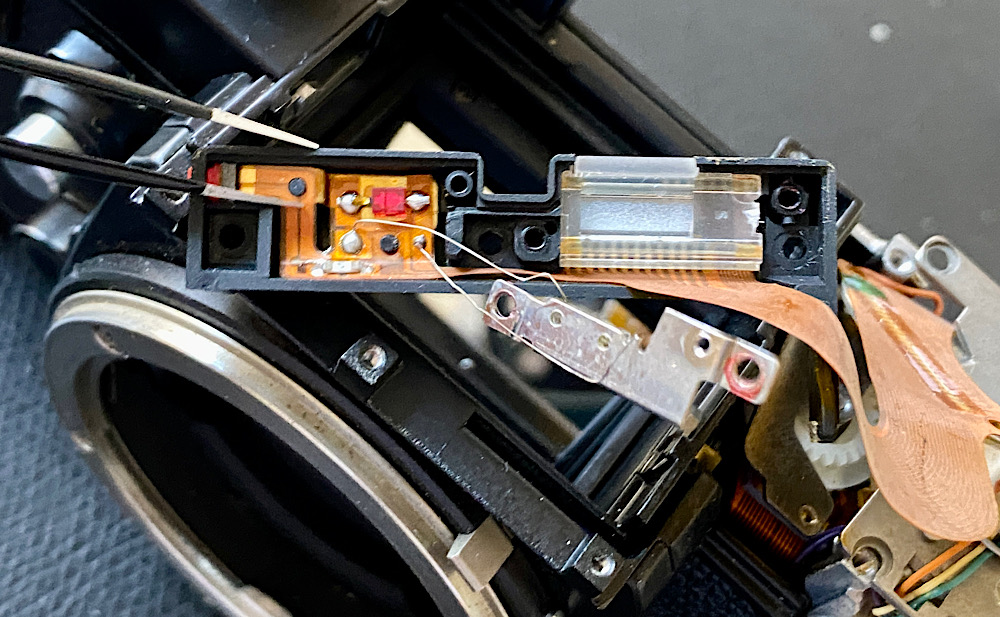

The donor part for my F3/T.

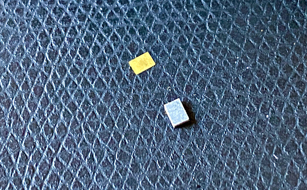

Above the two rows of contacts on the LCD block two strips of soft, transparent plastic are placed:

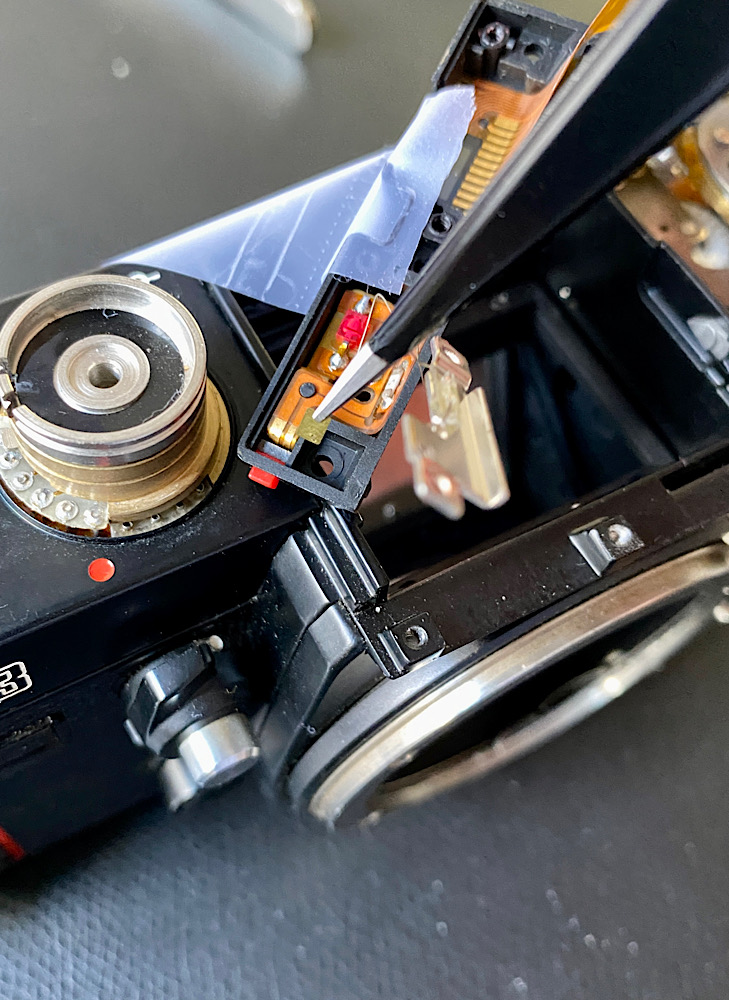

The piezoelectric element (below) with contact plate for the viewfinder illumination:
The contact plate comes back into place.
Simply insert, no further attachment:

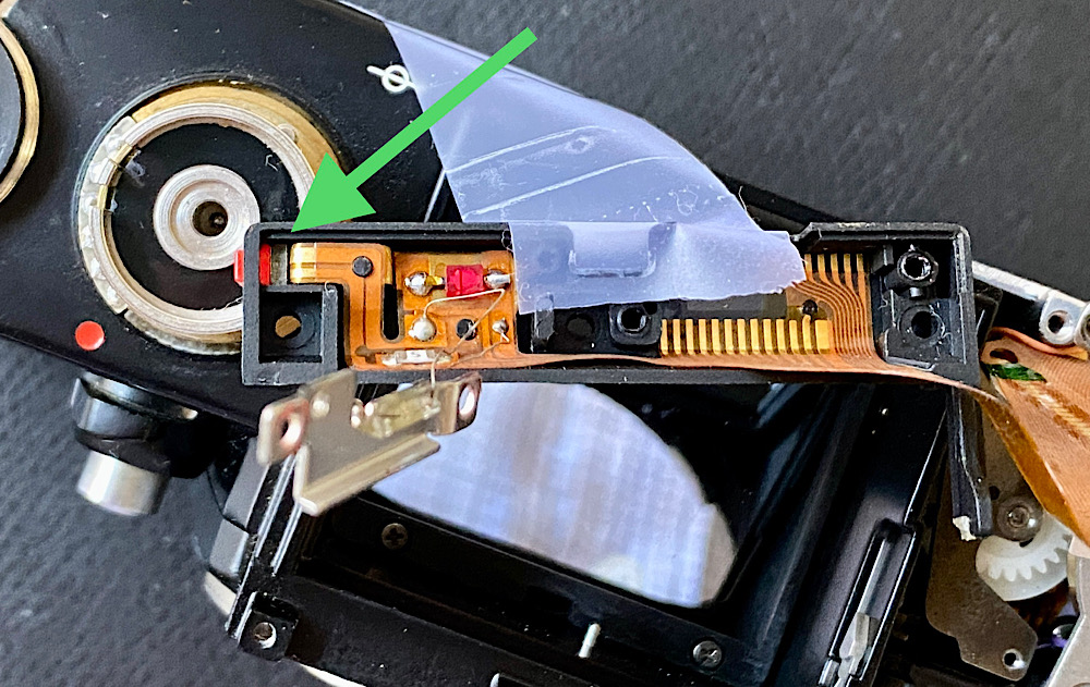

The arrow shows the position of the small plate between the red push button and the gray piezoelectric element:

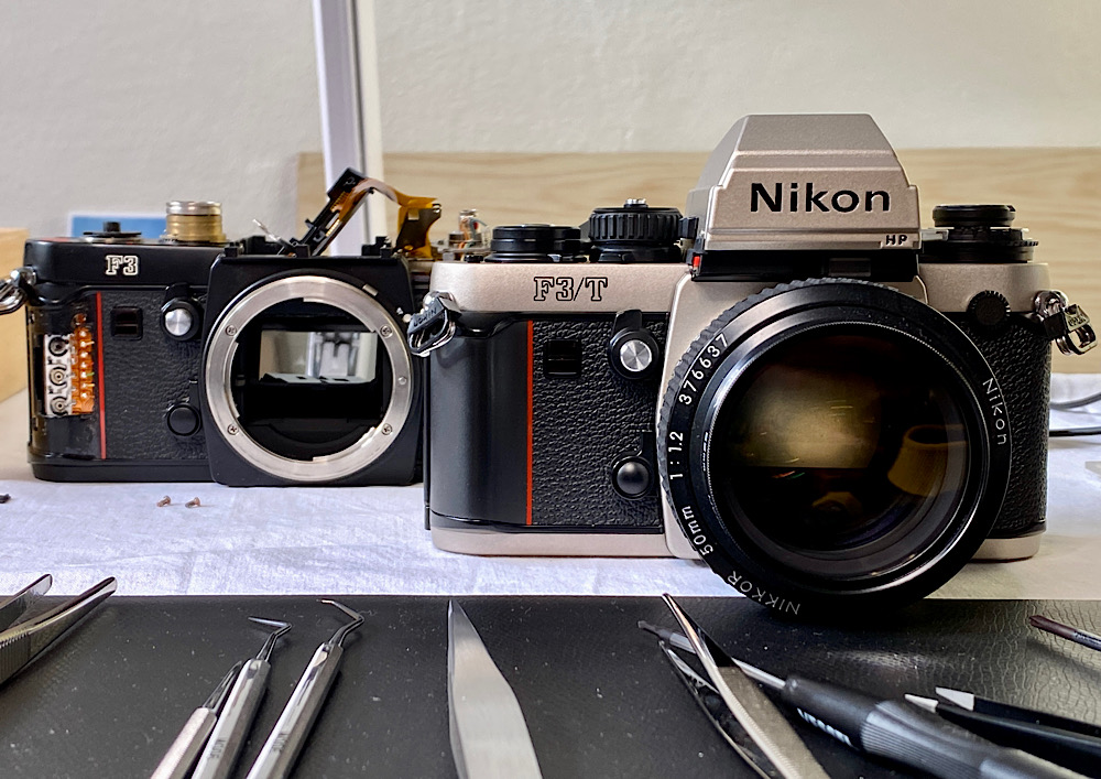

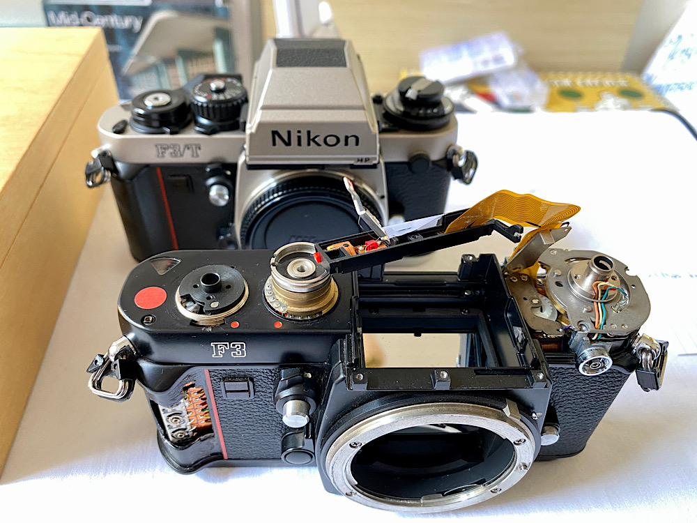

The donor in the front, the recipient in the back:

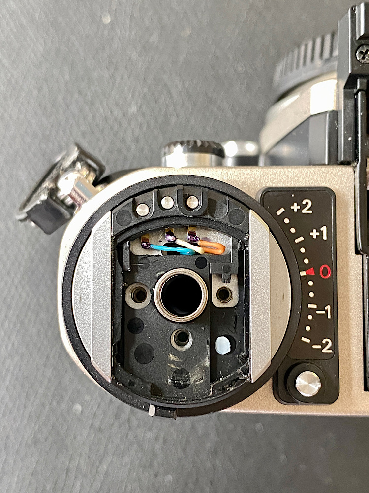

I worked my way to the left case cap on the F3/T to be able to pull out the LCD assembly with the flexible circuit board a bit.
These three lightning contact shoe cables must be unsoldered:
The donor LCD is installed in the F3/T and the left housing cap, the override with the flash contact shoe as well as the rewind crank are installed.

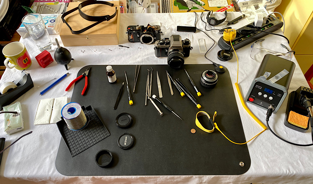

My mobile workshop:

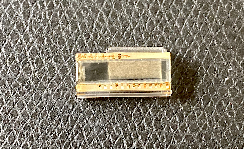

The defective LCD with obvious signs of decay on the contact rows:

I wonder if a broken LCD can be fixed.
This one seems to suffer from a kind of dissolving contact pads what causes the brownish discoloration. Chances to repair this might be low.
Anyway I have another spare LCD block which looks good. It is broken down in its component parts consisting of the display, two conductive rubber stripes, another rubber stripe, a cover plate, the prism for the illumination of the LCD and screws.
As I own several F3 I will try to replace with this as soon as a LCD goes bad.
The complete electronic circuit for the Nikon F3 as a factory new spare part:
The black unit on the left side contains the LCD block, the tiny bulb for LCD illumination triggered by the infamous little red button and the red flash-ready LED mirrored into the viewfinder.
The good news is that the LCD block is an independent part and can be replaced.
For the swap the LCD block has just to be pulled out after some screws have been released.

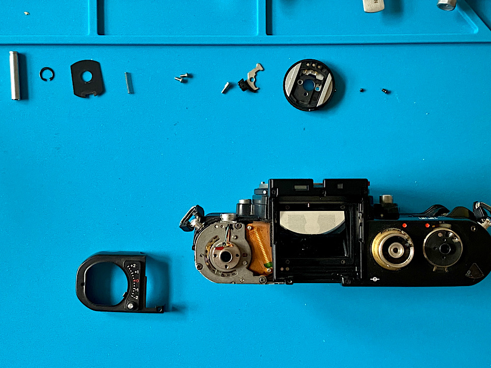

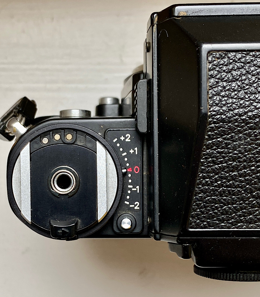

The left top cover on the F3 should be removed first to free the part of the flexible print circuit (FPC) where the unit is mounted.
Removing the left top cover on the F3
Please note that the rewind crank on this F3 is already off.
The crank can be released easily turning it counterclockwise while blocking the film rewind fork in the film cartridge chamber with a screwdriver.

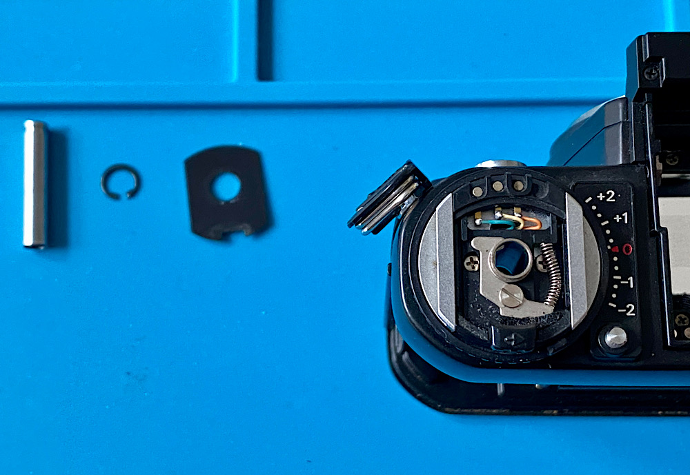

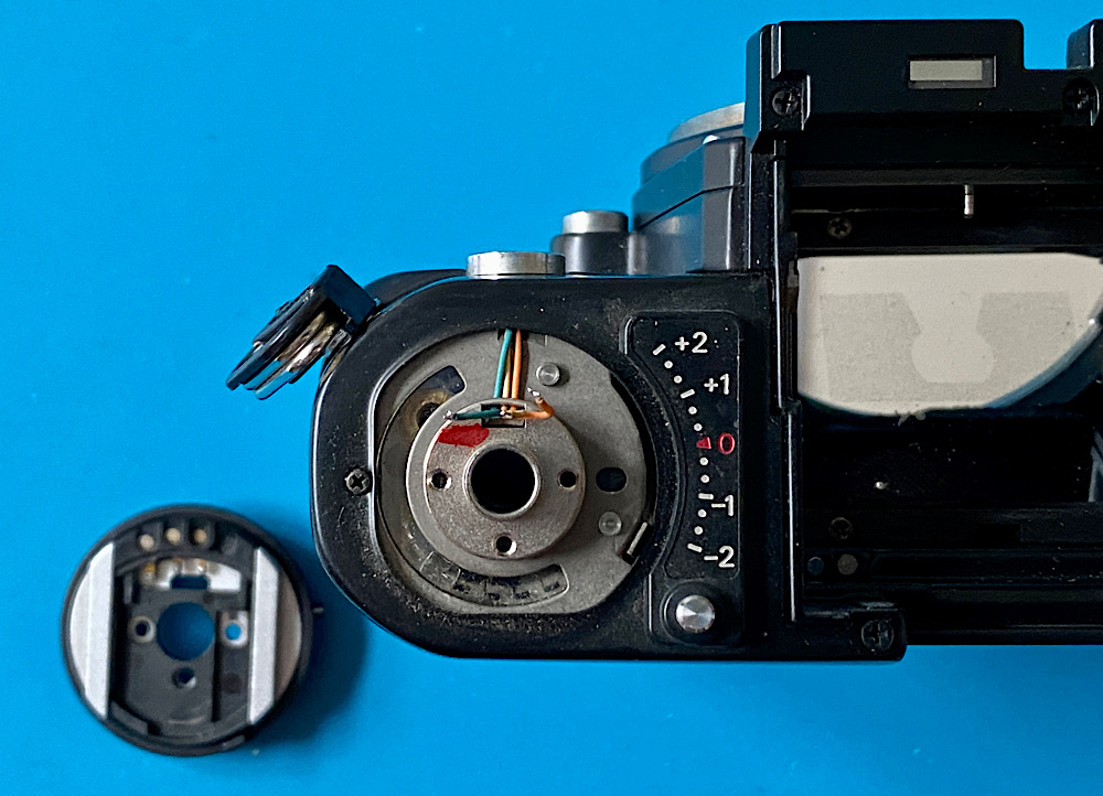

After loosening the snap ring, the cover plate on the flash contact shoe can be removed.
The silver sleeve falls out of the film cartridge chamber.

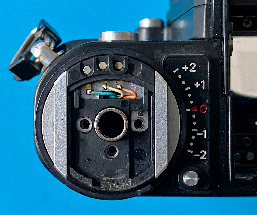

Detailed view after having removed the cover plate.

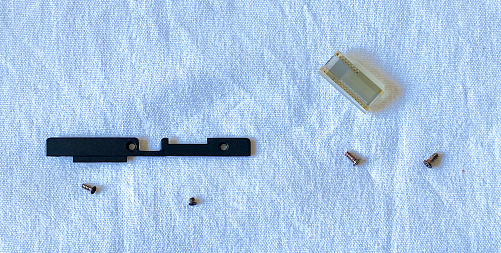

The locking mechanism of the rewind crank must be removed so that the two screws underneath for the flash contact shoe can be loosened.
The parts dismantled so far.
The lightning contact shoe is now only held by three cables which I desoldered.
The flash contact shoe can now be removed.
Once loosened, the left top cover can be pulled off with a bit of careful wiggling.

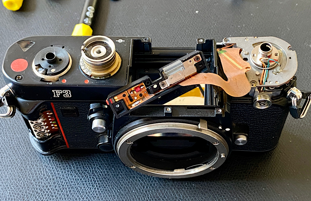

Completed

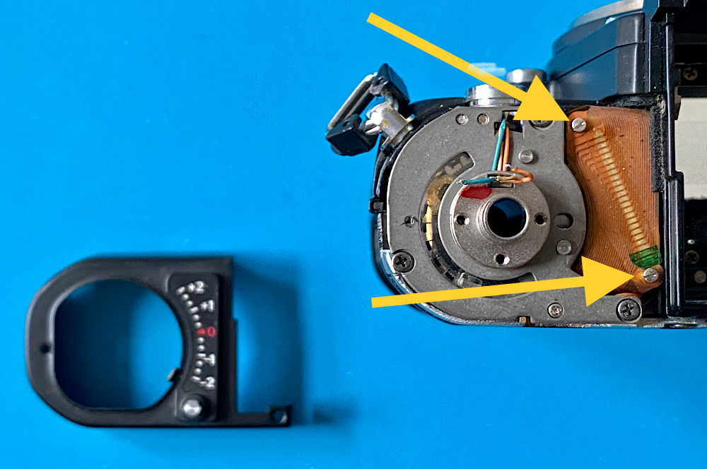

These two screws hold the FCP.
After releasing the delicate FCP the unit is conveniently accessible.

To access the cover plate on the LCD block the unit has to be removed (three screws on top).
The plate held by the two screws below the unit is trapped.
Anyway if you do not dismount the left top case you have no clearance which might cause stress to the delicate FCP:
Before installing the LCD, I cleaned the two rows of contacts on the flex circuit board with isopropyl alcohol.
The anxious moment - was the transplant successful?
Yes!
A high-contrast LCD display now shows all digits again!
My resurrectedF3/T, almost written off, is back in full force :smile:
My mobile workshop:
