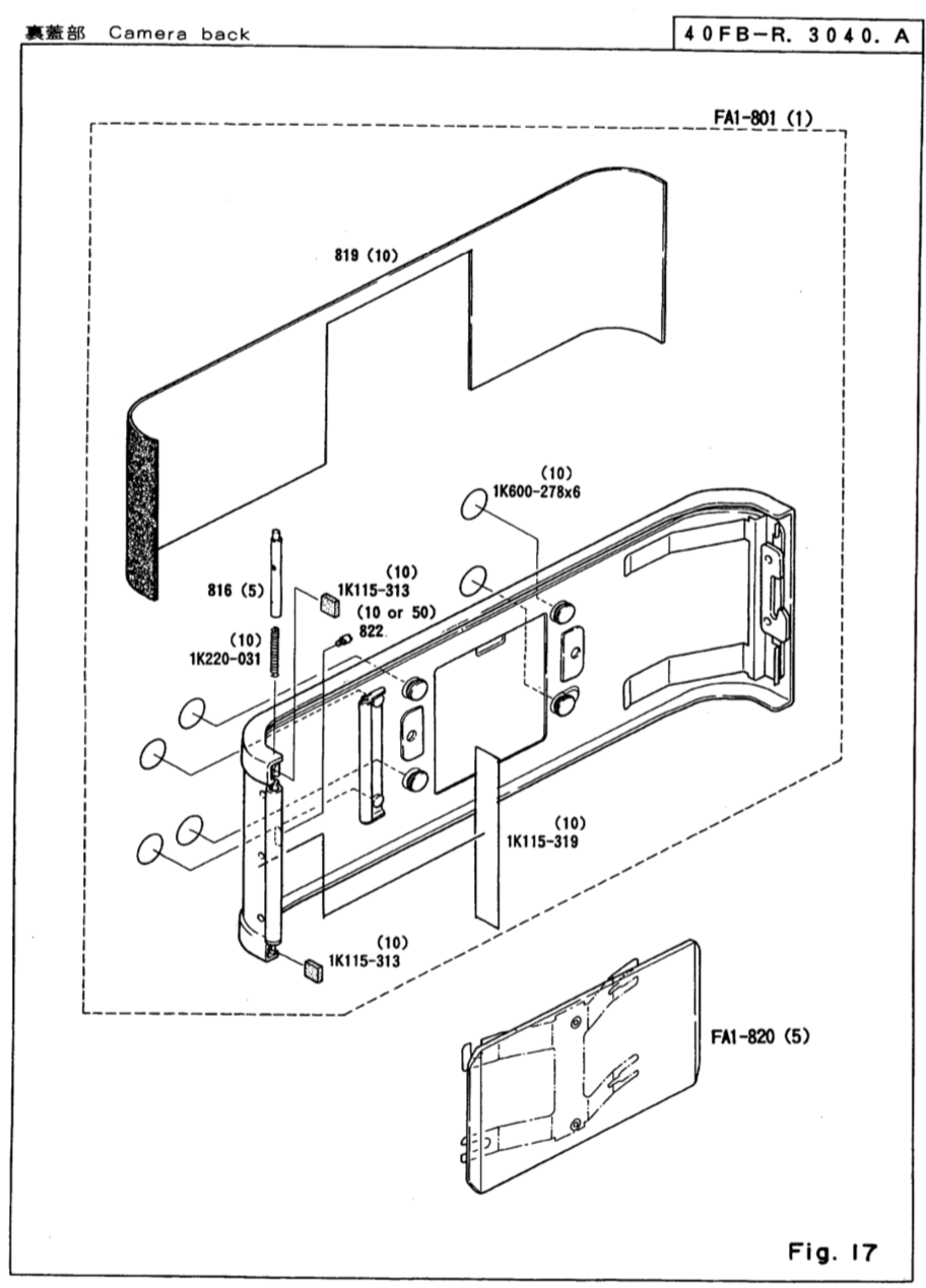

I have searched extensively and looked at parts diagrams but cannot find a part # for the plain back which seems a hard part to get. My as new Nikon F3P came with a MF-6 back which has a small tab sticking out the bottom to be used with the motor drive. I've asked a few camera repair shops for the part but no luck so far. I think the MF-14 databack would work but they are also hard to get mint and is not my first choice. Does anyone know the part # or potential sources?

To answer the original query, hoping it's not too late, according to the F3 Parts List found on learncamerarepair.com, the part number for the back door itself is FA1-801. The pressure plate has a separate part number, which is FA1-820.
By the way, if you're still wanting a plain, original back, another potential source is Kiwi Camera Service in Orlando. The owner, Michael Livera, has quite an extensive collection of parts/parts cameras. I know that he does have stuff for the F3, but you'd have to ask him if he has the regular back in stock. Good luck!
