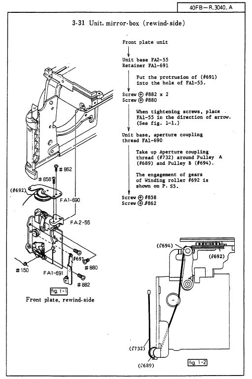

There's, also, another potential internal problem... the physical connection between the aperture ring and the resistor. These cord-driven connections and their pulleys sometimes get gummy and glitchy.

The F3 has one single FRE (Nikon called it Functional Resistor Element) it is located under the rewind knob and is moved by the ISO dial and the aperture coupling on the lens mount via string/pulley. I think there is one bad spot on this FRE. Sure finding the replacement part as well as taking if apart is not an easy task. If you move the aperture ring and ISO dial a lot it may (or may not) fix the problem. I am pretty sure that this is the problem but I wouldn't know how to fix it though.
Thank you! Yes, I've learned a lot about how the metering system works today. I had heard about the problem with the FRE on the F3--particularly how it can be broken by an impact, or when overstressed when a flash is mounted there and it takes a bang. (Good lord, I know that was a long time ago in technology terms, but having the rewind, a fairly delicate bit of the metering system, and the flash mount all crammed together concentrically *doesn't* seem the wisest of design and engineering choices.)
I'm hoping that with a bit of exercise, the problem will clear itself up (as it shows signs of maybe doing) and the FRE isn't permanently damaged. And even if it doesn't resolve on its own, it appears that I can use the camera with medium speed or fast film and it won't cause a problem, as he "bad spot" won't be in my favoured range of aperture settings.
