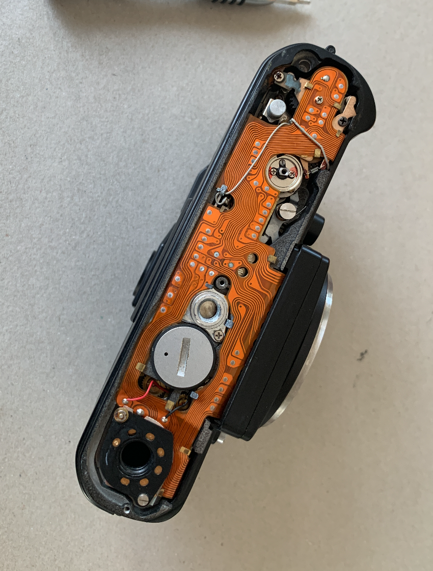

On the off chance, would cleaning and poking around in here do anything?
I wonder if it's simply a bit of corrosion or dirt on an electronic part that's blocking the signals?
I'd prefer to revive a camera than throw it to the heap!

I think it's extremely unlikely. Of course you can always give it a try. Some sort of knowledge of electric repairs, a service manual and corresponding tools would be a good start in my opinion. That's what I did with Olympus OM cameras.

You need the service manual. If you can't find one on the net let me know. I know I have the pdf copy somewhere. There is some point in there you can measure the voltages. It can pretty much tell you what's wrong. To fix it it is another thing.
I would add that if you can check and verify that the camera would function perfectly fine in manual except the meter indication is always +. If this is so the problem is entirely the metering circuit. The signal from the photocell is fed into a logarithmic amplifier to convert linear light brightness into a voltage that is proportional to the EV (EV is log of the light intensity). Then this voltage is fed into a subtraction amplifier that subtract the voltage generate by the FRE (which is the resistor that connect to the aperture coupling and ASA dial). This resulting voltage would then be fed into the meter display and the shutter speed control circuit. If I remember correctly all these votages can be measure with only the bottom plate removed and the manual would tell you the values you should expect to see.
Now that I am saying it. The problem could be entirely with the meter display. Because if the voltage fed to it is correct but it still display wrong then you still have correct automatic shutter speed in A. Try that. have the camer inside where it's relatively dark and fire the shutter in A settings and see if the shutter speed is long?
To me it sounds exactly like a cracked FRE, I would check for damage on the rewind side of the camera. For such a durable design and tool, this corner is a surprising subtle weak point.
