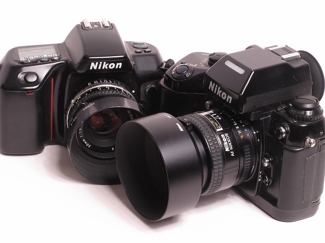

I own and use both the Nikkor 50mm f/1.4 D AF lens and the Nikon 50mm f/1.8 Series E lens. Both produce sharp images.
The Nikkor 50mm f/1.4 works best for me when...
1. I need auto focus
2. I need the extra 2/3 f/stop of light gathering
The Nikon 50mm f/1.8 Series E works best for me when...
1. I need to put a low-cost and expendable lens on a low-cost and expendable body
2. I need to carry a small lightweight lens with a small lightweight Nikon SLR.
Nikon 50mm by Narsuitus, on Flickr
