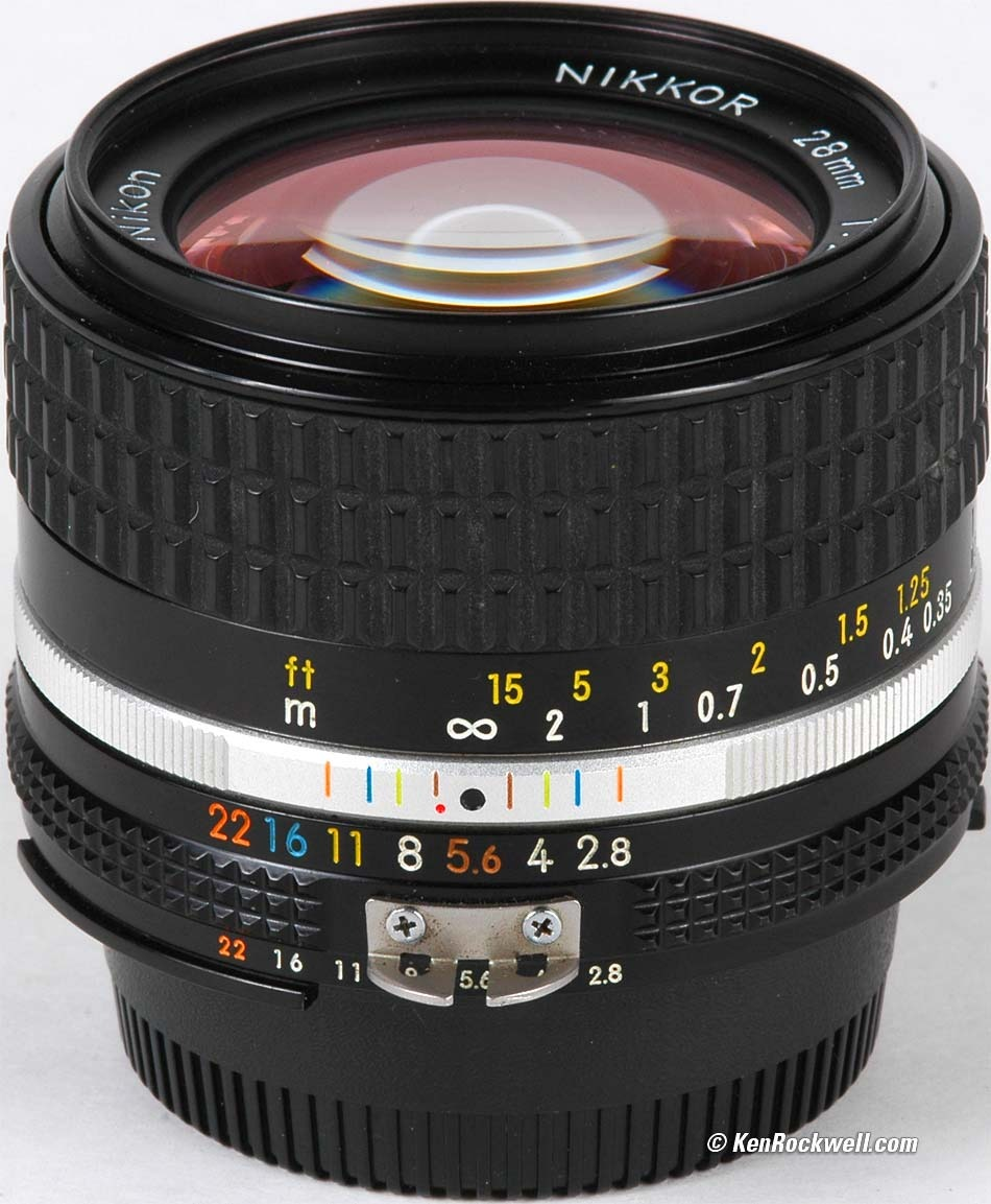

AI lenses and other attachments have a raised ridge on the edge of the aperture ring, closest to the camera body. These engage the meter coupling lever on whichever AI-compatible body you are using. Extension tubes have a moveable ridge that's linked to the ridge on the lens you have attached. This transfers the maximum aperture setting to the camera's meter. This shot from Ken Rockwell's site is a good illustration (ridge at the bottom starting between the 16 and 11).

Yes thanks, I understand the ridge
Yes thanks, I understand the ridge - it's a pity there isn't a picture of the tubes though, how they engage. I'll look for the PK 11-13's 👍
