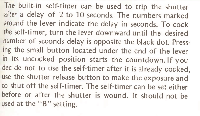

Nikon F2 self timer issue, seems to be working earlier , but now shutter releases imeadiately, can the shutter be half cocked somehow, not sure why it worked before, and what is correct position Sutter release T or middle position?
Shutter should not be in T or B position.
Hey thanks for the info, no user manual here, just bought this great F2, and still learning, thanks again for the support, what a great site
