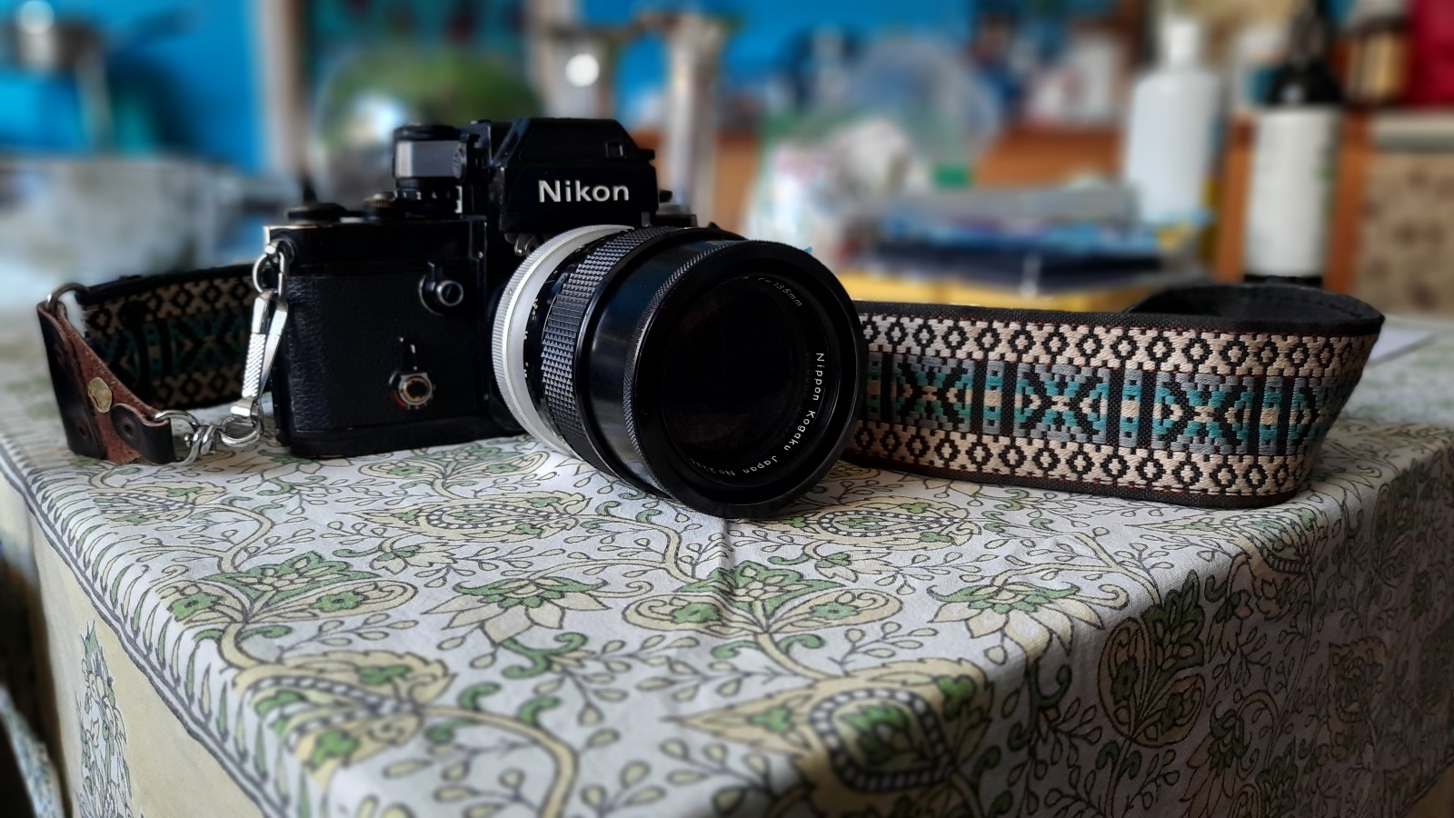

I got really lucky. The one that @SchwinnParamount was kind enough to give to me looks like it was relatively unused except for a little brassing where the strap connectors are. And the silver body that I picked up this past weekend doesn't have a scratch on it except for the bottom and they are superficial. The silver one still has the PC cover on it as well! The black one is scheduled for service by Sover next February/March.

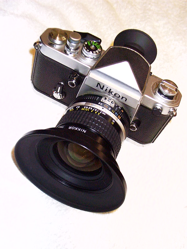

Over the years, I have owned and used the Nikon F, F2, F3, and F4. All are excellent cameras. I currently own and use three F2 and two F4 bodies. I no longer own or use the F or F3.
The F2 is my personal favorite because I prefer manual/mechanical cameras vs. automatic/electronic cameras. I prefer the non-metered prism on my F2s because they have no electronics. I have owned and used one of my F2 bodies since 1971.
Nikon F2
by Narsuitus, on Flickr
Everyone needs a f2 I have 3, one in sexy black with a matching retro strap. A great fashion accessory, women and me won't be able to leave you alone.
So the F2 is the Hai Karate of cameras?
Well hey there sailor. That’s a mighty big...... lens you have there.
If prices rise on the F2 next week, we’ll have nothing but this thread to blame.
