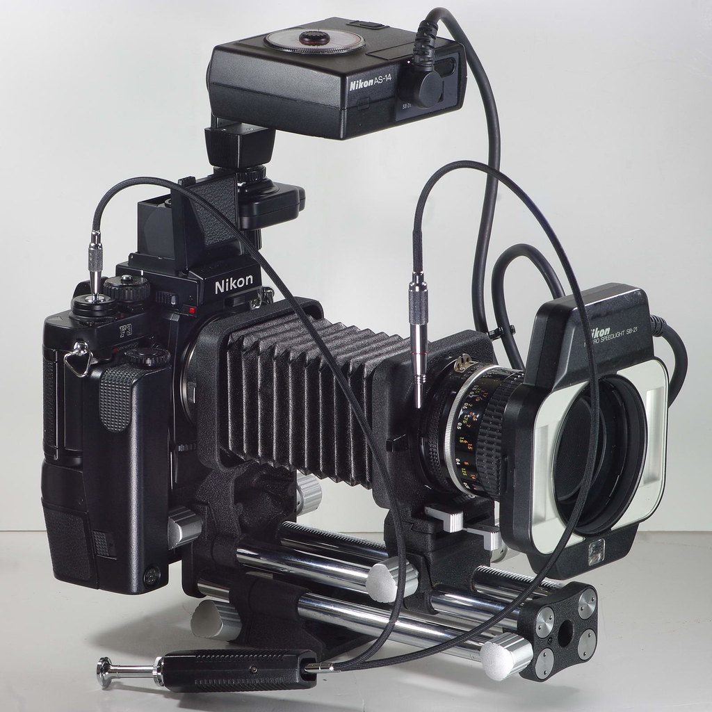

I think that both finders are best for people who wear glasses - or need more eye relief, given the 0.80X magnification provided by the DE2 viewfinder and 0.75X by the DE3. I believe all normal Nikon finders have a sub 0.90X magnification.
Nikon F3 - DE2 & DE3 by Les DMess, on Flickr
As much as I appreciate the 100% coverage I would prefer near to lifesize magnification better.
