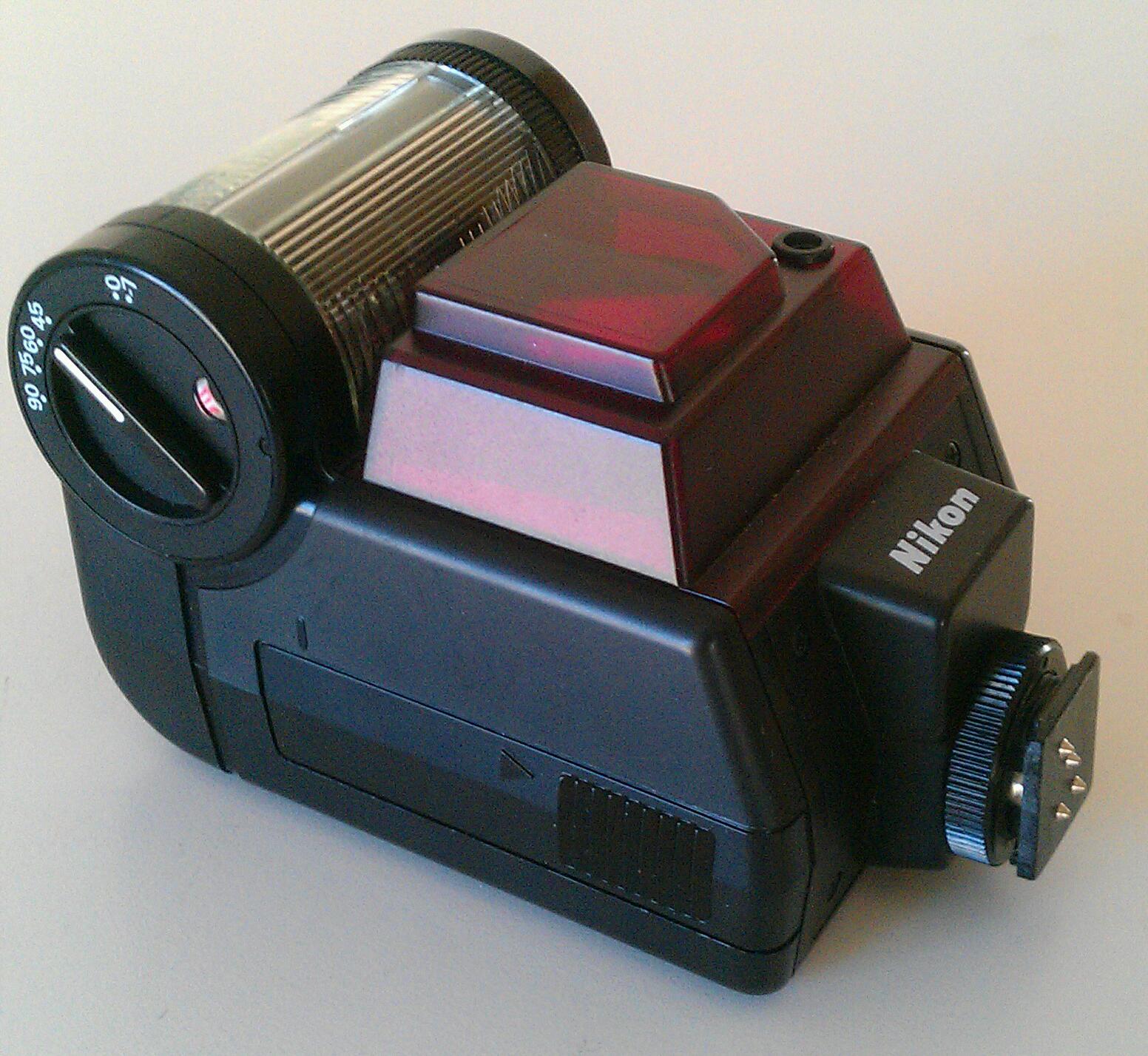

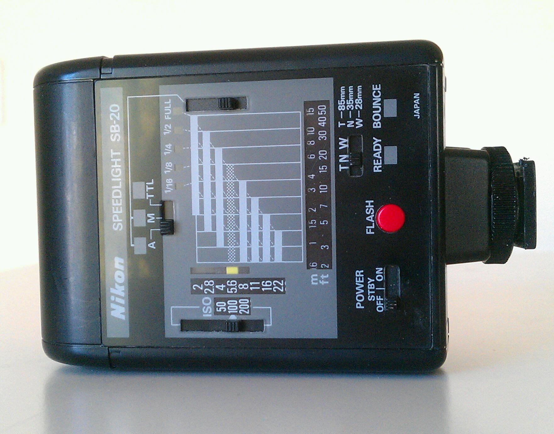

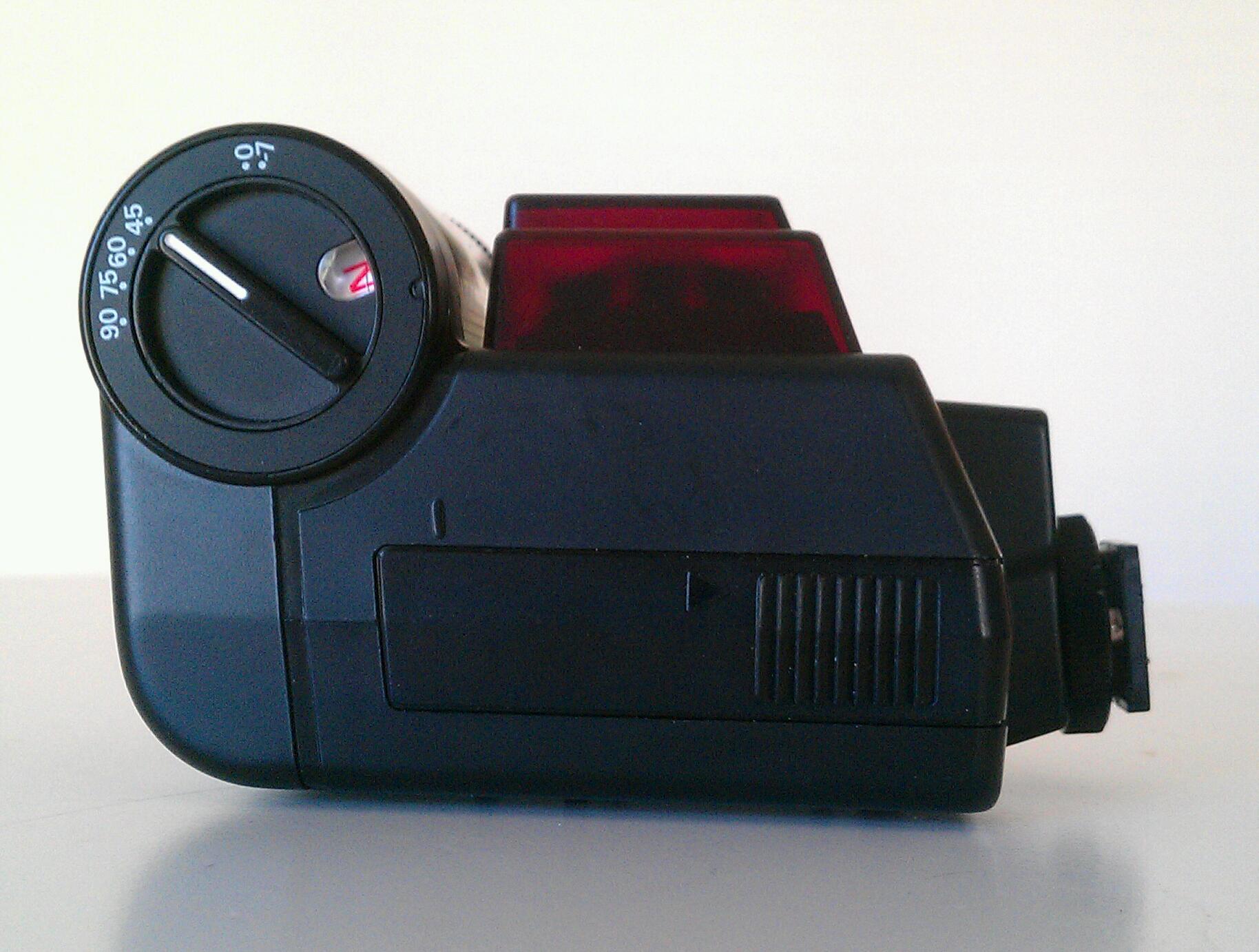

You mentioned the SB-20, these allow control over power output and can be bought inexpensively.
(in manual mode, you can select power from 1/16 to full).
Since these are old, before buying ensure it will still flash by testing it via the red button.
