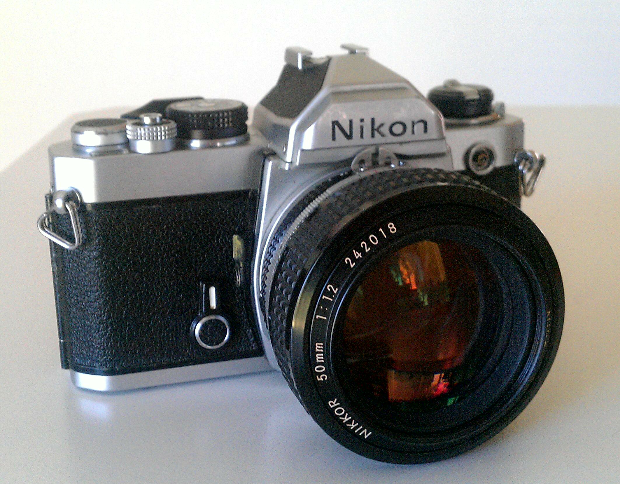

The FM Series has (i think) the same meter that people so covet in the SB and AS..... so i was thinking i might give that a try. I have a pair of FM and one FM2n.
I have hardly used them. Mostly, i guess, because of the way Nikon has the shutter activation linked to the film advance handle. Its needing to "stick out" for the shutter to fire is an annoying feature.
There is always something i guess.:wondering:
... have a pair of FM and one FM2n.
Agree. But if you get a "first version" FM (identifiable by knurled release collar), you can release the shutter with the wind lever pushed flush with the body.
Behold!
