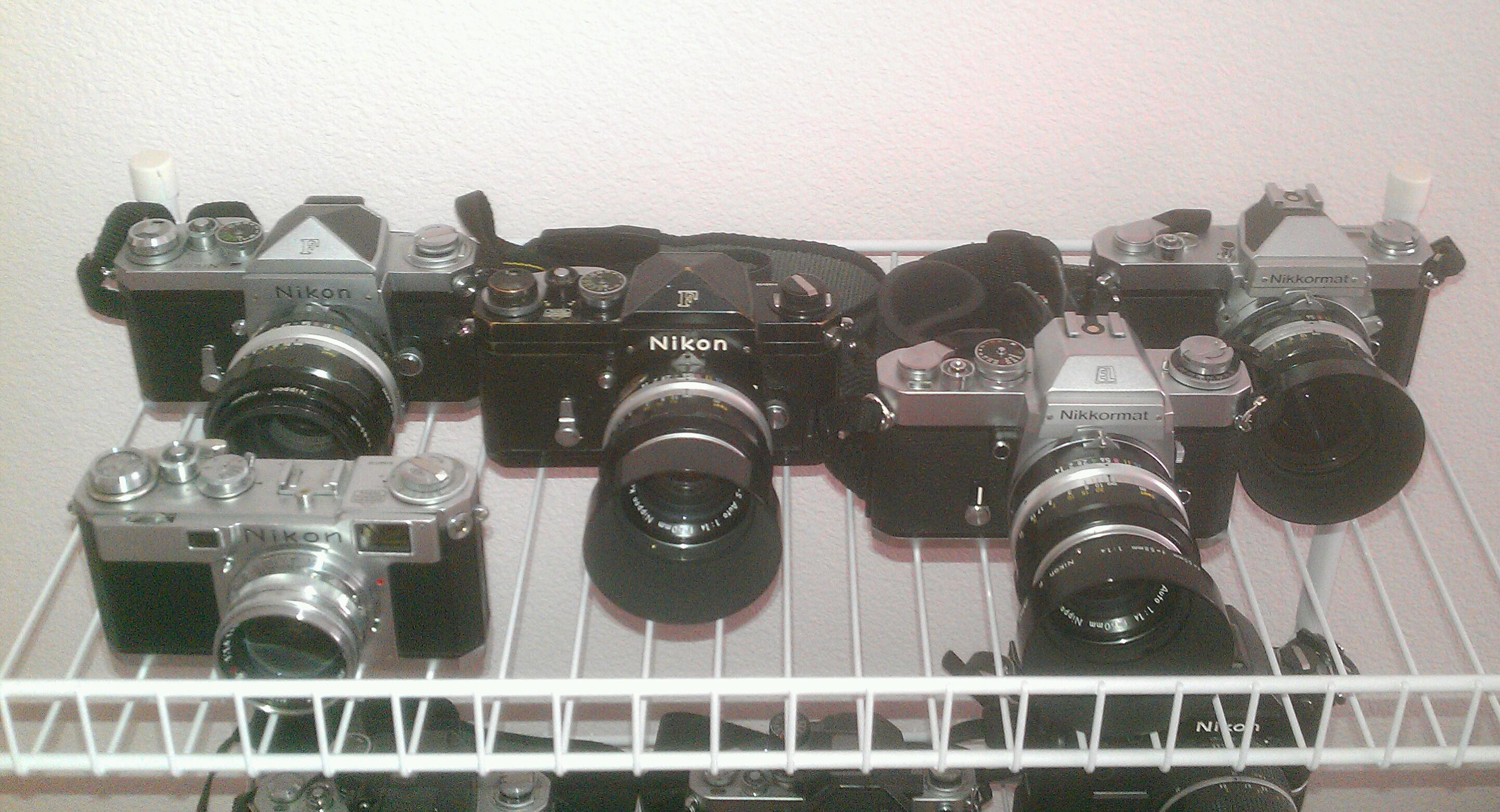

For simplicity, my manual focus Nikons are placed into two camps: the bodies with which I use only pre-AI (F, F2, FT2, EM) .....
The EM doesn't really fit in here. I guess you meant the (Nikkormat) EL?
regards,
chris
Theo Sulphate
Jul 3, 2014
6,489
Gig Harbor
Oops. Yes, Nikkormat EL.
I'm very fond of the EL's finder and display - which evolved into that used by the FE2 and FM3a. The weak point of the EL (and FT2) is the ring resistor for metering , which wears ever so slightly as the aperture is changed.
