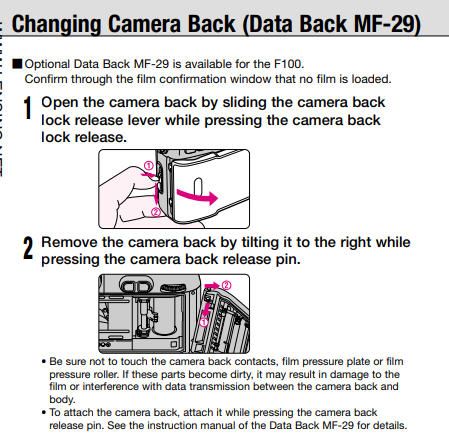

It is a simple procedure the remove the back, to mount the optional data back. From the owner manual:
The back itself (not the data back) is priced at about $71 - 80, as there is no added labor charge, nor need for a camera technicians skills!
