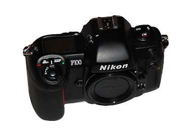

Hello. I have a Nikon F100 with the grip. I would like to use it without it. Serarching the internet I found what I need. It is called MS-13. It uses CR123A batteries. The problem, it cost more than 100€ (at ebay), half of what cost me the camera. It is sold out everywhere. Any idea where I can get it?

Thank you.
Here are the alternatives:
1) Based on dimension of CR123 and your camera battery compartment you can design your own and 3D print it. I have no idea what's the cost but my guess is you can get it cheaper if you have access to the printer.
2) Search on eBay for a used F100 or parts camera that comes with it.

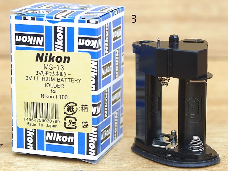

I believe there was a battery holder for AA batteries, which might be easier to find.
Well, the MS-12. I found it but more expensive.
I got the AA holder for mine off eBay for £20 or £25 .

The MS-12 AA battery holder is way too flimsy designed by Nikon. It just breaks on the edge when you push in the battery a couple times.
The F90X used almost the same design ( not the quarter turn lock but a coin screw) though this one is far more sturdier.
I was trying to find a MS-12 as I like a light camera without a battery pack underneath. Nowhere to find anymore, sadly. The big battery grip
MB-15 High Power Pack can be found easily, costing 100-200€, a lot of money for a plastic part.​
I'm now so far as to get rid of the F100 and stay on the F90X forever because of the battery holder issues.

It would far cheaper and easier to come up with a repair kit for the existing battery holder than manufacturing a new one. Is there a common failure mode for the battery holder?
Honestly, I don't think the AA battery holder for the F100 should break while you're putting batteries into it. It's not super beefy, but you also shouldn't be pushing that hard. I can see doing this if one were a pro photographer in the 1990s trying to change batteries in a hurry, but a user in 2024-25 is probably a hobbyist who can take a little more time.
The AA holders for the F100, N90, and N8008 are all kind of a problem spot because they are necessary, not made any more, and a relatively complex plastic shape. I have some broken holders for the N90 and N8008 that were weakened by battery corrosion and/or stressed by battery swelling. A failure point tends to be the vertical spines breaking, but you can also get breakage of little bits that hold a metal contact.

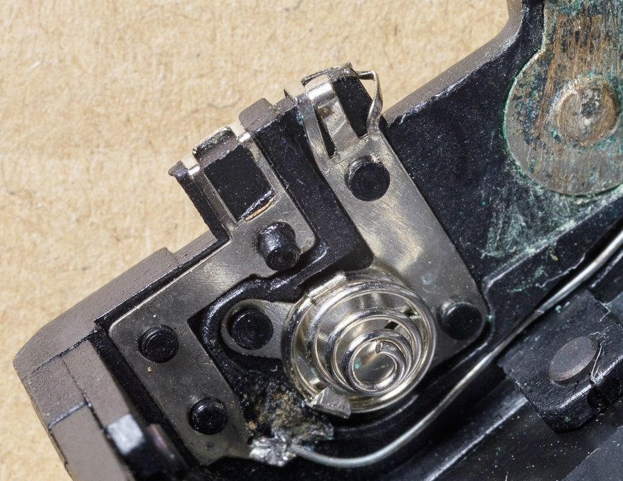

I have thought about trying to 3D-scan a battery holder to create a crude model that could be refined by somebody and printed, but the printer I have that is supposed to 3D-scan is not behaving. The yet more modern way may be to take a bunch of 2D photos and feed them into a AI reconstructor that attempts to reproduce the 3D shape - a colleague had good success with this for a flattish part, but it was a less complex shape.
I did notice someone is selling the 3d model for printing of a battery holder.
The catch is you have to transfer all the metal contacts/spring/etc.. over to the new holder.

One does not have to fabricate exact replacements for the metal parts. They just need to provide metal surfaces that make firm contact between the battery ends, and from the batteries to the body contacts. Although not for the Nikons discussed in this thread, I have repaired other battery contacts, to function if not to a professional standard, with bendable stiff copper wire and/or pieces cut from thin stainless steel. There is an example here for the replacement button battery holder for the Bronica SQ-Ai that I designed, and put on Thingiverse for free download: https://www.thingiverse.com/thing:5256045 (Another person designed one of these SQ-Ai holders first, but their stl file has some problems that make it not work on many printers, so I made a new one from scratch.)
If you click to the second picture of the Bronica holder, you can see the bent metal tabs. They're not nearly as finished a product as the original, but they work well. However, though many people could bend steel or copper wire to fit into a 3D printed holder, I can't guarantee that everyone can, especially if the user has already broken a previous plastic holder. I mean, the AA holders are not the strongest, but most of the broken ones I've seen were already damaged by battery corrosion. They shouldn't quickly fall apart in normal handling.

No doubt you are correct. Once upon a time, I made jewelry from sheet silver and copper wire. But that was a half-century ago, and my eyes are not as good as they were then.
I have not yet tried to repair the contacts on this Konica FT-1 battery grip. I think I can probably bend the twisted part back into shape. However, if the thin metal breaks, I doubt if I would want to try to fabricate a replacement part from sheet stock. It is not clear to me just how much I could deviate from the original design and still make a reliable electrical contact with the sockets in the camera body.
If someone were to 3D print the plastic part, would they try to replicate the plastic "pins" that hold the metal parts in place? Or would we forget about the pins and just epoxy the metal parts in place? I use epoxy for many different repairs, and I know there are a few plastics which epoxy does easily bond to.
I would imagine that the pins should be replicated. It helps position the metal contacts. I would then epoxy over the pin to hold the contact in place.
