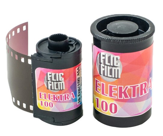

These cassettes look different than others I've used, the cassette looks like it snaps together in the middle rather than the end(s) screwing on. I couldn't find an image of the Popho but its the same one that Flic uses for their spooled Aerocolor IV. I have some of those also but haven't shot with them yet.
