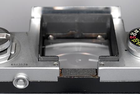

I have a late 1961 or early 1962 Nikon F with the standard prism finder. As I recall on the earliest F models, a factory retrofit modification had to be made to the screen box before one of the later Photomic finders could be mounted on the camera. What year model or serial number designation was the cutoff where no modification needed to be made to fit the Photomic finder? And once new model manufacture no longer required a modification, were all subsequent Photomic finders compatible? Thank you.

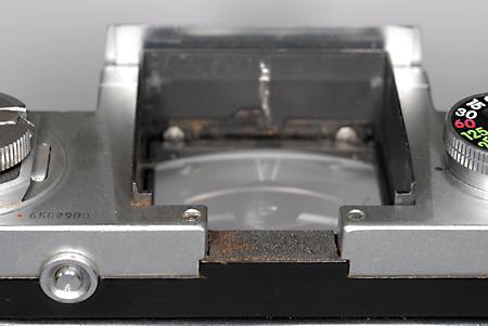

The difference is in the rear lip around the top of the mirror box.
This change first appeared on Nikon F bodies around the 657xxxx serial number (early 1965) and until it was standardized there would be a red dot next to the serial number to indicate that the body could use the new Photomic T finder
There are four main types of Photomic finder:
1962 Photomic (flag and switch types), with the "eye" on the front, these are not thru-the-lens meters and can be used on ANY Nikon F body.
1965 Photomic T and the later 1967 Photomic Tn, these are the first thru-the-lens meters and require the back of the mirror box lip to have the cutout

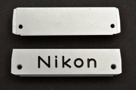

1968 Photomic FTn, this type requires both the mirror box cut out AND a later front nameplate with angled bottom edges for the claws to lock onto.
All of this info and more can be found at Richard DeStouz's wonderful Nikon F website: https://www.destoutz.ch/nikon-f.html

Thank you. Mine is 6457494 and is the un-modified early type. And the name plate bottom corners are as square as they can be.So I guess that is the end of that idea. Oh well. That means to always keep my Luna Pro in my pocket. The camera and finder are in mint condition and I just finished a nice CLA on it. Nice machine.
