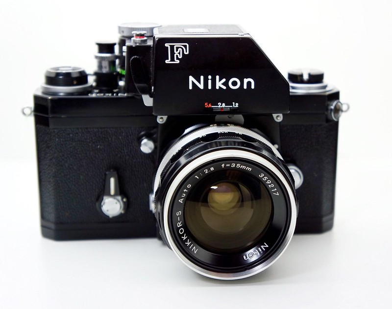

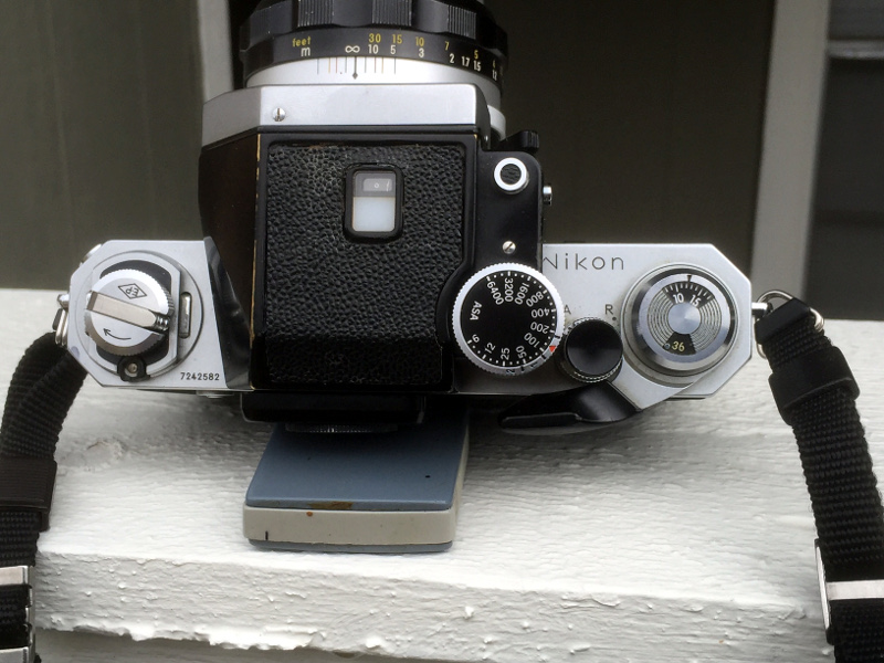

I was reading that the so-called Nikon F Apollo started sometime during the 73xxxx serial number range. However I have one with a 72xxxx serial number and I am the second owner of it. I bought it several months after the original owner bought it in the military exchange (EP marked). Supposedly it had not had a top cover replacement so I am wondering if maybe some 72-series may have had this change..
Here are a couple of images of the camera..

It looks pretty familiar.:smile: There's only one nagging problem with mine. As you look through the viewfinder at the meter to center the needle for exposure, there appears to be a very tiny bit of trash/dust of some sort right in the middle of the "V" where the needle would be. I've taken the finder off, sprayed in every nook and cranny I could find but it hasn't budged. It doesn't seem to affect the needle movement at all but it's hard to overlook.
It's probably under the white translucent window below the needle that's visible at the top. There's a little bump in the prism glass on a Photomic finder that reflects the needle downward into the prism. So, cleaning it would be something to get done when the finder gets overhauled.
-J
The meter is fine, just that pesky piece of whatever it is. Would that be something I could do?
Unfortunately, to gain access to the metering window area, everything has to come out. If you're ok with it being there, even though it's annoying to look at, I'd leave it and have someone clean it out when it does come time to overhaul the prism.
