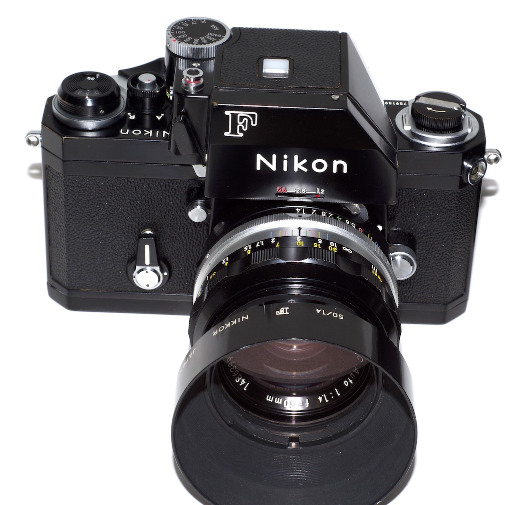

Ok. So this one has shutter speeds all messed up. There is an orderly method depending on speeds above the X synch speed or below.
Above X-synch the speeds are controlled by curtain timing which varies slit width. Below X synch the escapement times the shutter. The escapement; usually 3 or 4 steps both with and without the pallet (which slows it considerably) giving a total of 6 to 8 slow speeds.
I recently acquired a well-used F + lens at a local camera show. The shutter clearly operated, but on a brief test of it, 1/8 and 1/15 were really slow, like 3 stops slow. 1-1/4 were fine and the faster speeds were decent. Yes, that meant that 1/8 and 1/15 were slower than 1/4. I think that 1/8 and 1/15 are governed by a slightly different mechanism of the slow speed governor (I think that's what you refer to about engaging the pallet or not). I opened up the bottom cover of the body and it didn't seem dirty (I don't think you can really see the slow speed governor from there), so I blew on it, gave it a stern glare, and closed it back up. After exercising the shutter through many speeds and firings, the 1/8 and 1/15 are almost up to speed. The rest of the speeds are within 1/3 stop.
OTOH, my first F that I've had since 1985 - so it hasn't been abused, or serviced, for several decades - has speeds that are dead-on today using a photoplug-type tester. I got it because I wanted a reliable SLR after my first one broke. Unlike a lot of things I do, that worked out.
Pre, the shutter speeds are all slow. 1 sec is about 1.5 sec and 1/1000 was about 1/350
Pre, the opening curtain was 15.2ms and the closing curtain was 19.96ms. Both should be 14.5ms.
After setting the curtain speeds (14.3ms/14.48ms*), the rest of the speeds fell in line.
*Curtain times a tad fast, but I don't have all day. I wanted to get out and shoot some film. Each time one curtain is adjusted all the speeds get messed up until the other curtan is adjusted.
1000 -0.1
500 -0.1
250 -0.3
125 -0.1
60 0
30 0
15 0
8 -0.2
4 -0.1
2 -0.1
1 -0.2
Checking in from my post that you replied to, did you clean and lube the pivots prior to adjusting the curtain speeds? Did you need to adjust any of the eccentric screws?
I only adjusted the shutter curtain travel times. No other adjustments needed.
