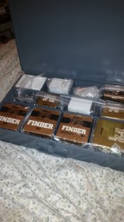

What you say is true. I have had many, many Nikon F & F2 prisms, plain and metered (50-plus, at least). (I am always the odd-man out in that I consider the Nikon standard eye-level prisms to be god-awful eyesores compared to any of their metered counterparts. )
Anyway, I'd estimate that nearly 50% of all the standard prisms I've owned have experienced the advent of the dreaded "line down the middle" roof desilvering, and almost all of those have been of the older "F-syle" vintage. The condition worsens with age. The standard "F" vintage eye-level prisms WILL desilver -- starting at the prism apex -- regardless of use or environmental conditions.
Marc
(PS: I have to repeat that, just like other camera-brand finders made in the 60's & 70's which incorporated foam-packing in their manufacture, Nikon metered AND non-metered prisms will fail progressively and -- beyond a certain point -- irreparably, as the deteriorating foam melts into a gooey-mess and becomes a voracious mirror-coat eating solvent.)
(PPS: I used to be a statistician for many years -- so please spare me from comments like "Well, MY prism is still just fine ..." MMT)
