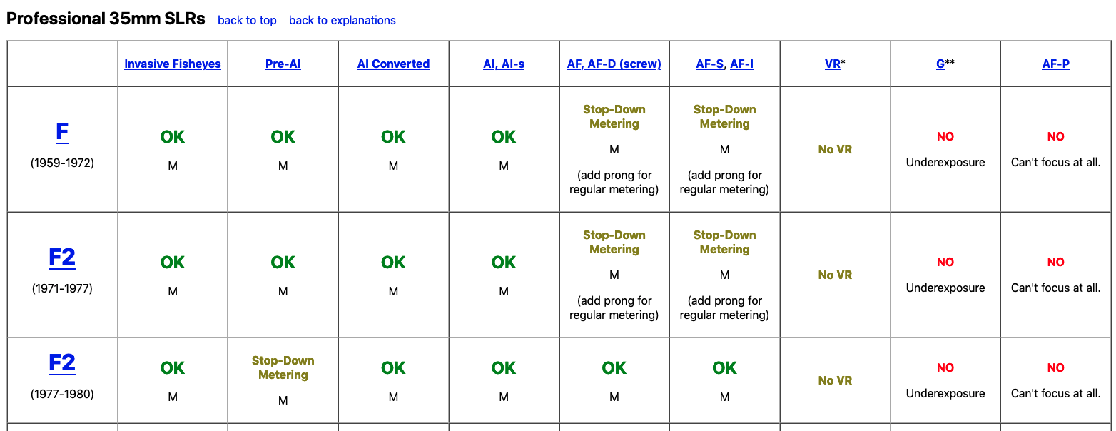

Many lenses are compatible if they have the F mount. Auto focus lenses will not work because the needed battery and circuity is not in the camera. You have a wonderful camera, enjoy.
This article may help you or add so confusion until you work your way through it and understand it.

The link Sirius posted is a fairly definitive chart. I also recommend reading the manual (download from butkus.org , etc) to understand how to use the camera. If you want to know everything about the Nikon F system, see http://www.mir.com.my/rb/photography/hardwares/classics/michaeliu/cameras/nikonf/index.htm
A couple of comments:
- Do you have a light-metered prism? If you do, and the meter works, then lenses need the "rabbit ears" silver prong on top to couple to the meter. Read a manual to understand how to couple the lenses to the meter. Other lenses will mount, you'll just not have metering (or use stop-down metering).
- Almost all manual focus lenses will mount and work on the F. Autofocus lenses that have an aperture ring will mount and work, but you won't get light metering. AF lenses that do not have an aperture ring (labeled "G") won't work - that is what Sirius meant to say.
One more thing: the 50/1.4 lens should be great for all general photography. You don't need to upgrade it. The reason to get more lenses would be if you feel the need for other focal lengths, like wide-angle or telephoto.

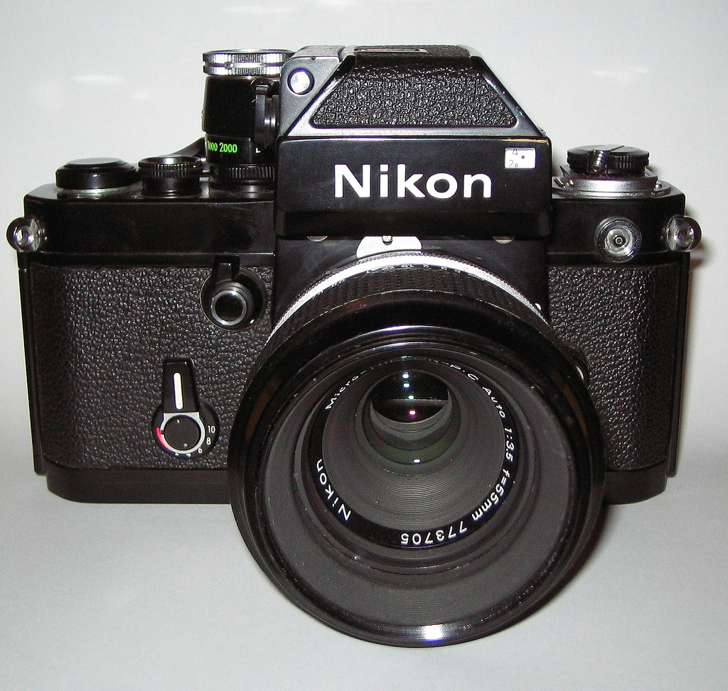

But let me get that straight. I only have Nikkor Autofocus lenses. I could actually use them on a later F2?

Great chart.
It depends on the lens and the camera's prism. If it is an AF lens with an aperture ring, you can mount, focus, and shoot it on an F2. However, you will only get metering if you have one of the F2 prisms (A or AS) that couple to the lens by the little tabs on the rear of the aperture ring, rather than by the rabbit ears.
Ken's chart is a little misleading because it's not the date of the body that matters, but the type of prism. Most of these Nikon compatibility issues are about "does the correct linkage exist on both the lens and the camera/prism," and you can tell by looking for the linkages.
