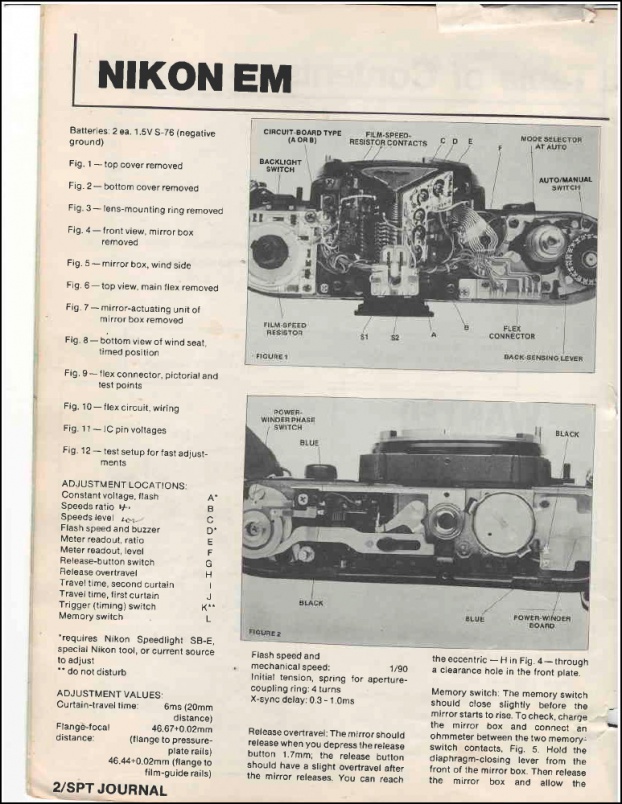

  • Technical article in the SPT Journal about the Nikon EM

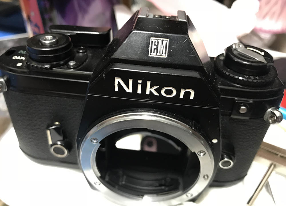

Of the four EMs available, I chose the front one for inspection because it is the most used and the dirtiest.
The case is intact. No cracks or broken parts.

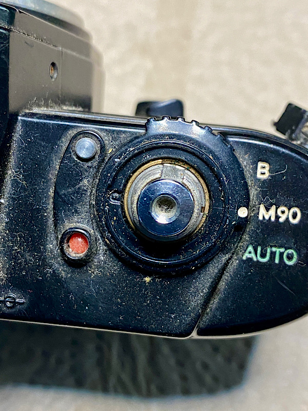

Very pleasing: The shutter can be cocked and released in M90 mode, which is the mechanical shutter speed of 1/90 second.

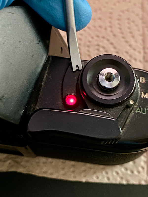

After I have cleaned the battery contacts in the base of the camera with electronic cleaner, inserted a 3 volts battery and moved the (not inserted) film up to 1 in the film counter, I test the exposure meter.
Also great: The measuring needle is not stuck (a known problem) and reacts to changes in light and to turning the aperture ring of the attached Nikon 50/1.8 Series E. This means that aperture priority works.
The backlight correction works and extends the exposure time by two f-stops as it should.
The battery control LED also works, but flickers when the test button is pressed.
The mechanical self-timer can be cocked and runs down, the shutter is released. It just doesn't manage the last part.
The coupling ring for the aperture simulator runs rough and a bit jerky.
The ASA setting works.
The leatherette is coming off in two places.
Lots of dust and dirt, light seals and mirror shock absorber should be replaced.

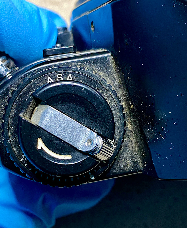

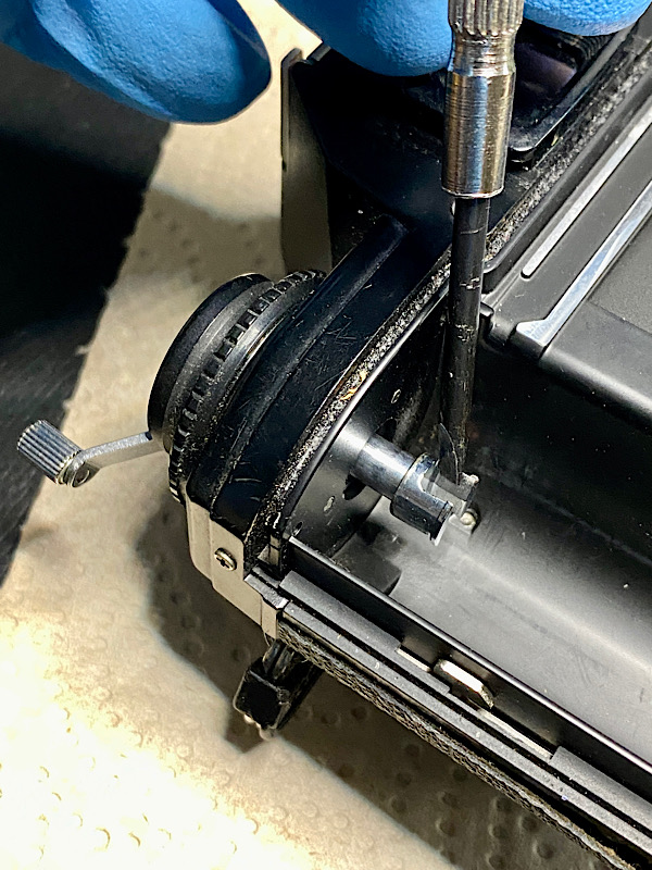

Remove the winding lever after loosening the small screw. The cover cap opens by turning clockwise.

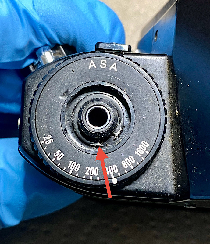

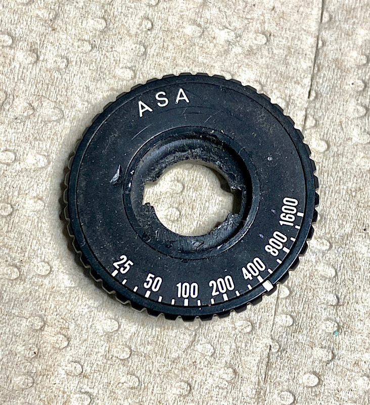

Dismounting of rewind crank and ASA wheel.

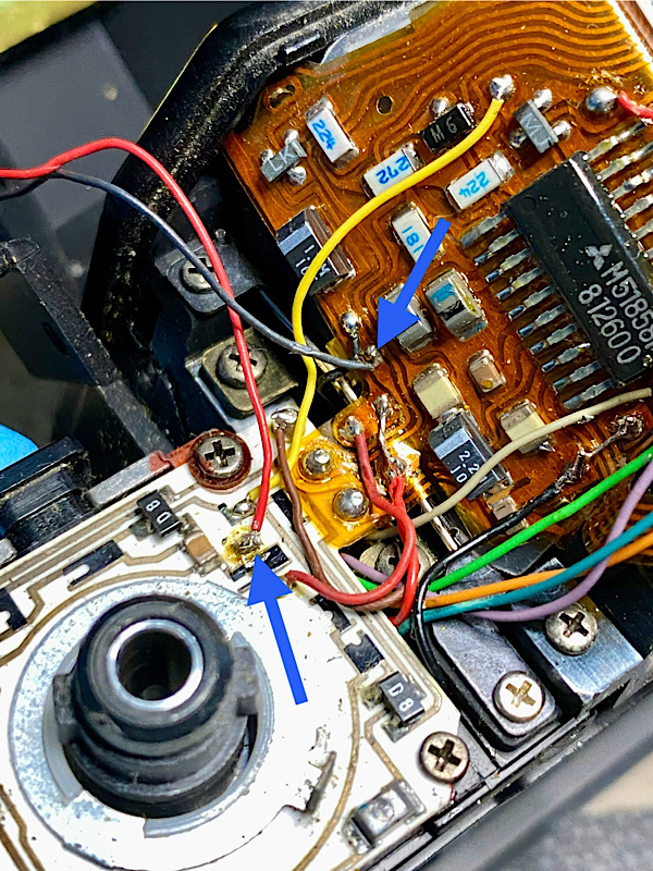

Two cables connect the piezo speaker to the circuit board.
Desoldering the two cables. As always, flux applied to the soldering points aids desoldering.

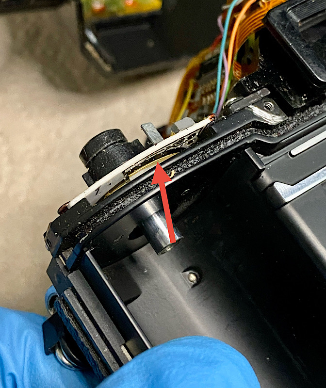

Contacts for battery testing with LED
This is where the push button for the battery test with LED contacts the circuit board.
I suspect that the contact under the push button (blue arrow) creates a connection to the other two permanent contacts when pressed. I will clean this with electronic cleaner.
ASA setting, contact tracks with wipers
The contact tracks with wipers are on the underside of the ceramic board. I will clean this as well.

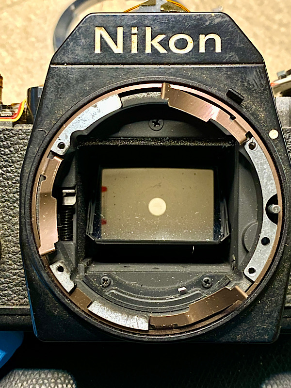

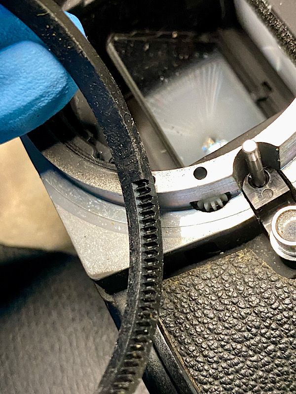

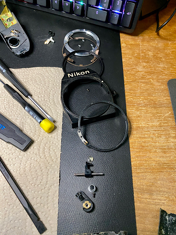

Remove the aperture simulator rings
Dismounting the bayonet ring.
The black ring with the lens coupling for the aperture simulator.
The copper-colored pressure spring in the bayonet can only be inserted in one position.
Here the black ring couples into the ring underneath with contacts (red arrow).
This ring moves left and right, following the aperture setting on the lens.
Removing the bayonet cover to get to the ring.
The ring with the contacts can be lifted out of its guide and only reinserted in the correct position.
The wipers at the ring.
The contact track.
The ring with the contacts is held under tension by this spring loaded gear.
When inserting the ring, it must be pre-tensioned approximately half a turn (estimated) anti-clockwise.
This is best done with a needle or fine probe ...
... so that the gear rim on the ring can take over the tension.
The lens locking mechanism.

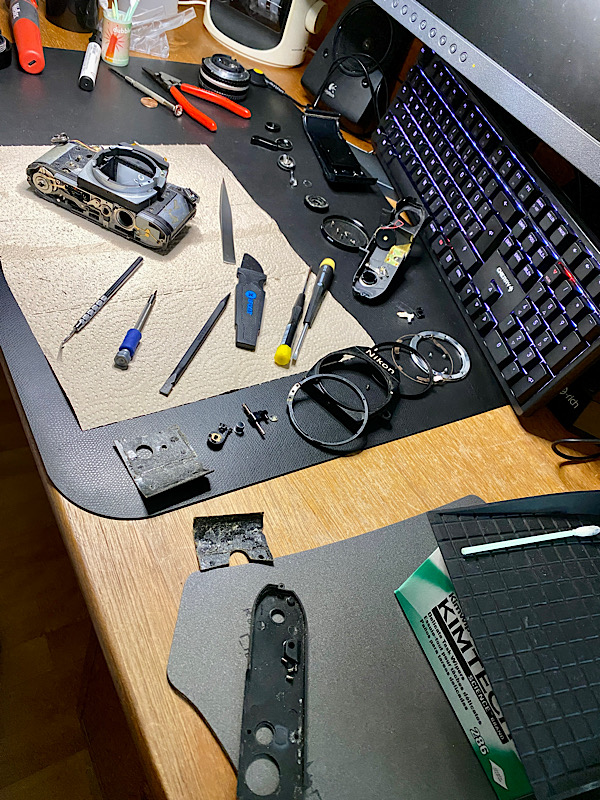

Ready for cleaning
The camera is now disassembled enough to start cleaning it.
You can see that the EM has a solid metal chassis.
The EM can be easily disassembled and the installation positions of the individual parts are largely self-explanatory.
A very carefully constructed and, so far, service-friendly camera.

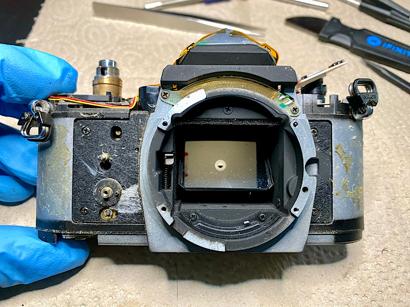

Since the EM has obviously come into contact with sand, I will definitely remove the front panel with the mirror box to clean if necessary. This will also give me access to the self-timer mechanism on the inside of the panel.
There are instructions for this in an issue of the SPT Journal.
Tomorrow will definitely be interesting 🙃

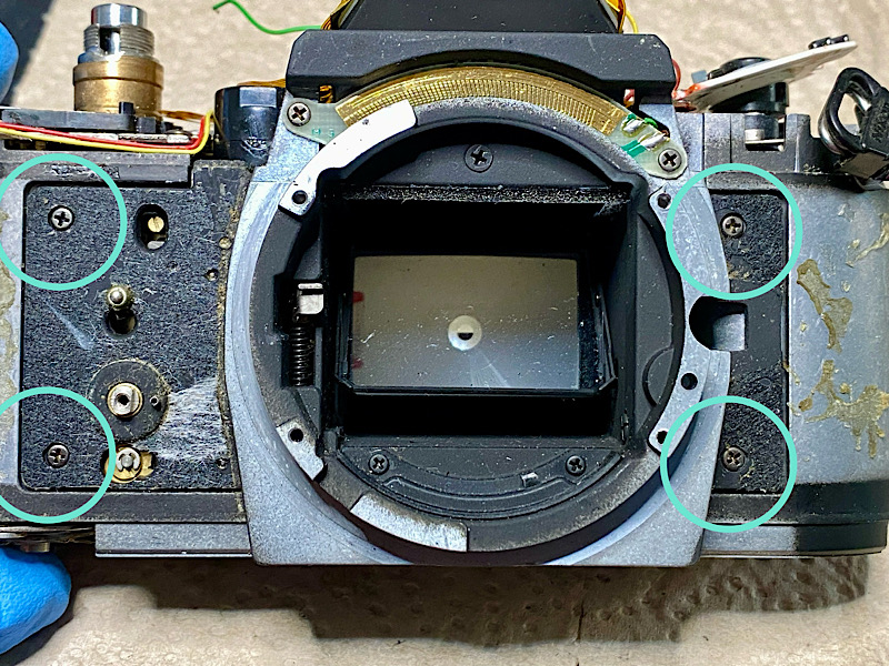

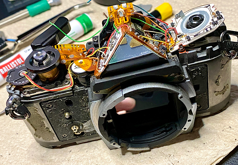

Removal of the front panel with mirror box
This requires the following steps, which are described in the SPT Journal:
Removing the ceramic plate with conductors and wipers under the ASA ring is also part of the process, but I have already done that before.
Desoldering the marked cables.
Desoldering and separating the flexible circuit boards on the connector.
Loosening screws.
Done
Rear panel with shutter.

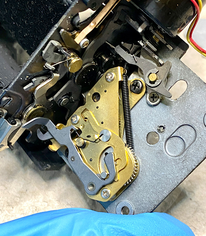

Views of the front panel with mirror box.
Index lever for largest aperture and part of the corresponding control electronics.
Mechanism of the self-timer.
Lever for tensioning the mirror.
Test assembly, which requires the shutter and mirror to be cocked.
It took me a few hours to solve a problem with the mirror. The mirror did not flip up completely after the shutter was released.
I found the solution in the service manual.
The front panel has to be inserted exactly as shown, then the four fastening screws can be screwed in without any problem.
I had a tiny misalignment that was enough to affect the mirror mechanism.

As best as possible in the assembled state, I cleaned the area behind the front panel as well as the rear panel and all accessible contacts.
I had previously cleaned the housing parts with cleaning foam and water.
The battery test LED no longer flickers after cleaning the contacts.
Some oiling and greasing
I oiled the bearings here and there and cleaned/lubricated where I could see traces of old grease.
This is better than nothing and of course is no substitute for thorough preparatory cleaning and systematic treatment.
Challenge on the flexible board
A conductor track on the flexible circuit board was broken. I bridged the spot with jumper wire.
I needed for this the strongest lens in my magnifying glasses and it worked 👍
A pragmatic solution for the self-timer lever
Since I didn't see any sensible way of reducing the friction with oil on the self-timer mechanism, I cut and filed the back of the plastic lever a little.
Now it moves fully back to its original position via the ball catch.

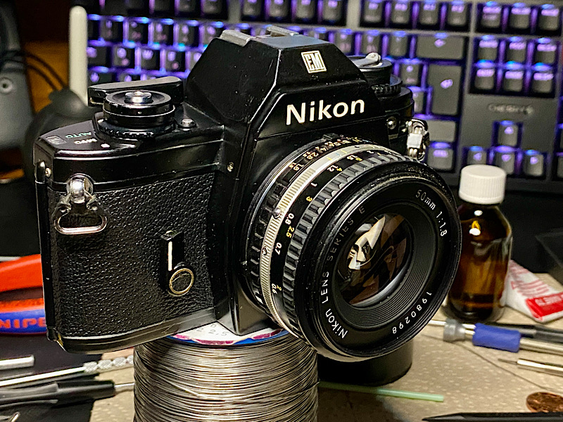

One long day follows the next, in Vienna it is now Saturday, 2:00 a.m.
The camera works, everything is plausible.
I am happy with the result of my work.
We will continue with shutter/lightmeter test, flash and winder soon.
