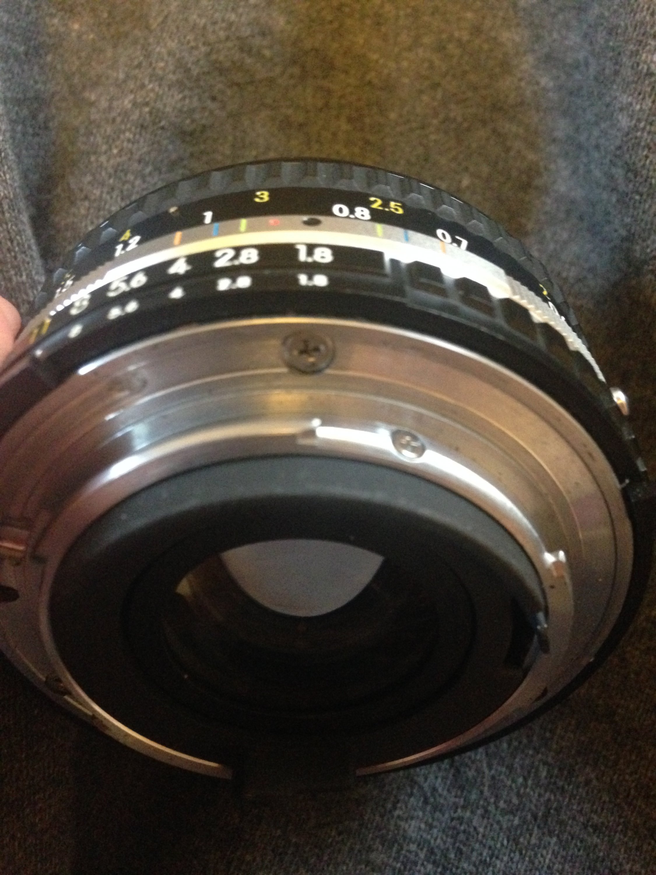

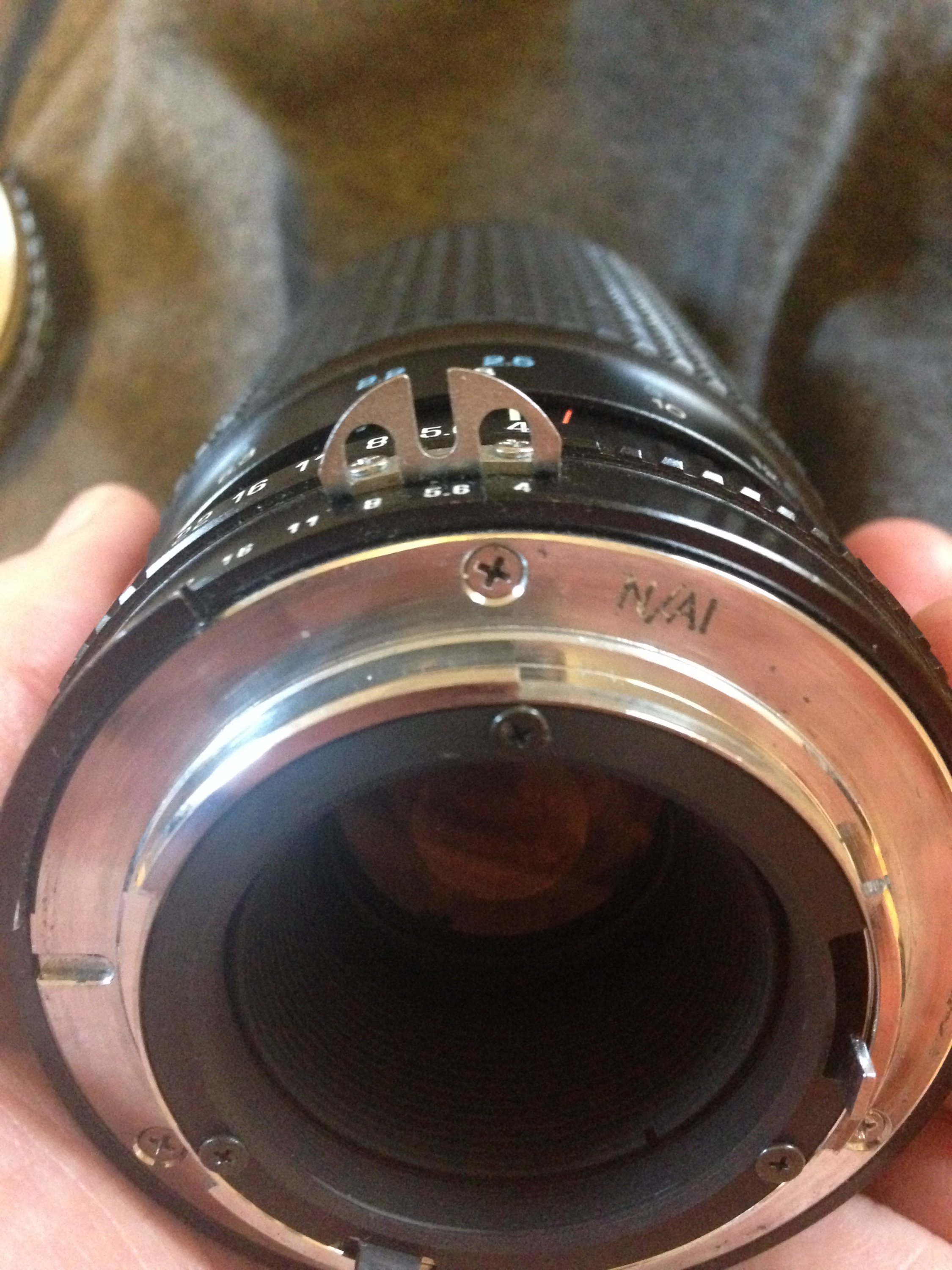

I think I've figured it out. As far as I can tell, every lens will just nudge the follower slightly. I had misunderstood, thinking that the feeler communicated an absolute aperture value to the camera, but it doesn't; it communicates a value relative to the starting point, the maximum value. So when you turn the ring, the camera doesn't know (and doesn't need to know) that you're going to close down to 4 from 1.8, it just knows that you're closing down roughly 2.3 stops. What changes from lens to lens appears to be the position of the aperture ring relative to the mount. I'm probably not phrasing that well, but if you look at different lenses with different maximum apertures you can see that a different f number sits directly above the flange edge when fully open, but the ridge starts at the same point relative to the flange. Pics are of my slowest and fastest to make the difference more visible.
