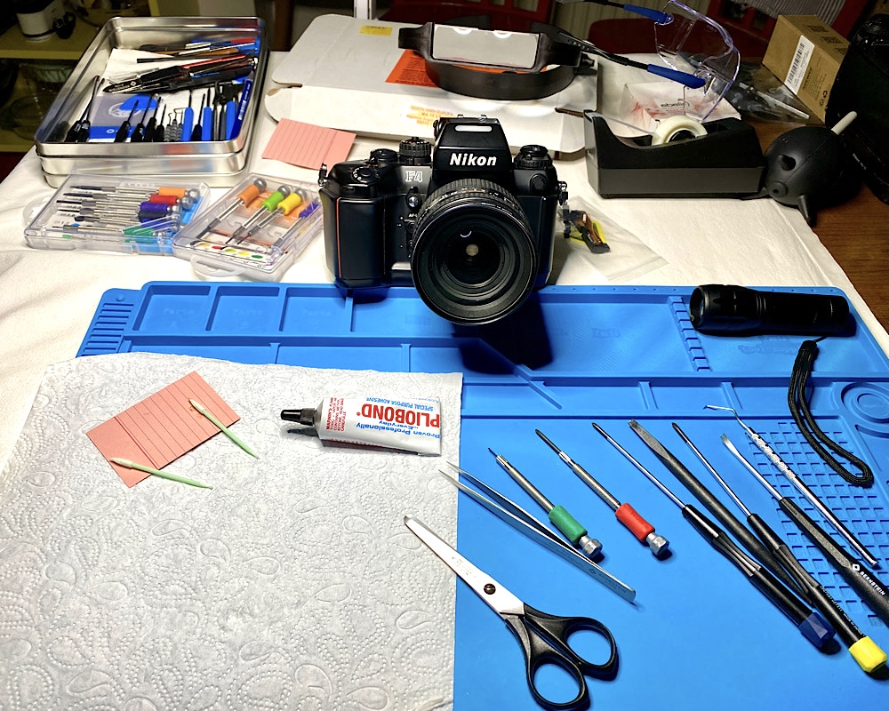

After replacing the top LCD in the viewfinder of a Nikon F4, I wanted to know what the procedure is for the bottom LCD.
To do this, I dismantled a functional DP-20, the standard viewfinder for the F4, whose display is badly bleeding. It has black and green spots that partially cover the displayed digits.
After a quick look at the Nikon Service Manual for the DP-20 and reading a report on fungus removal in this viewfinder, I got to work.

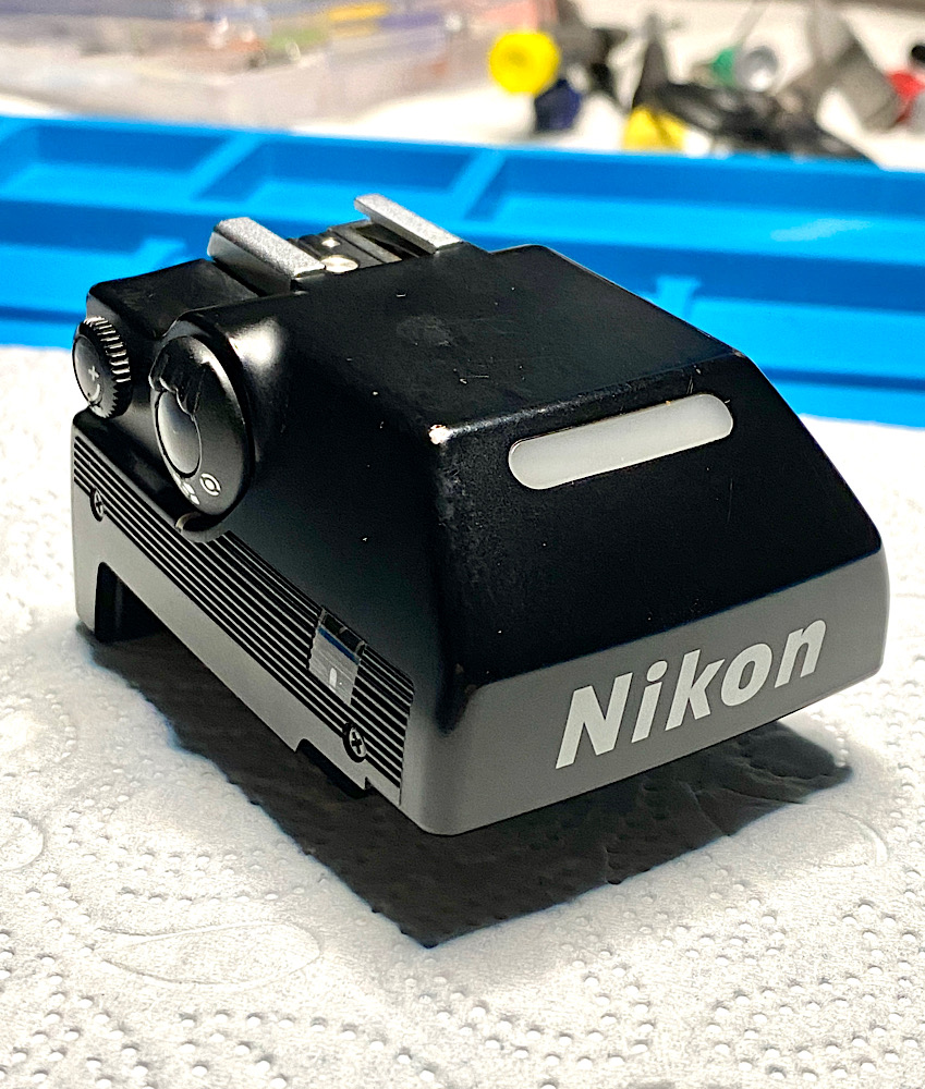

The candidate in beautiful external condition.

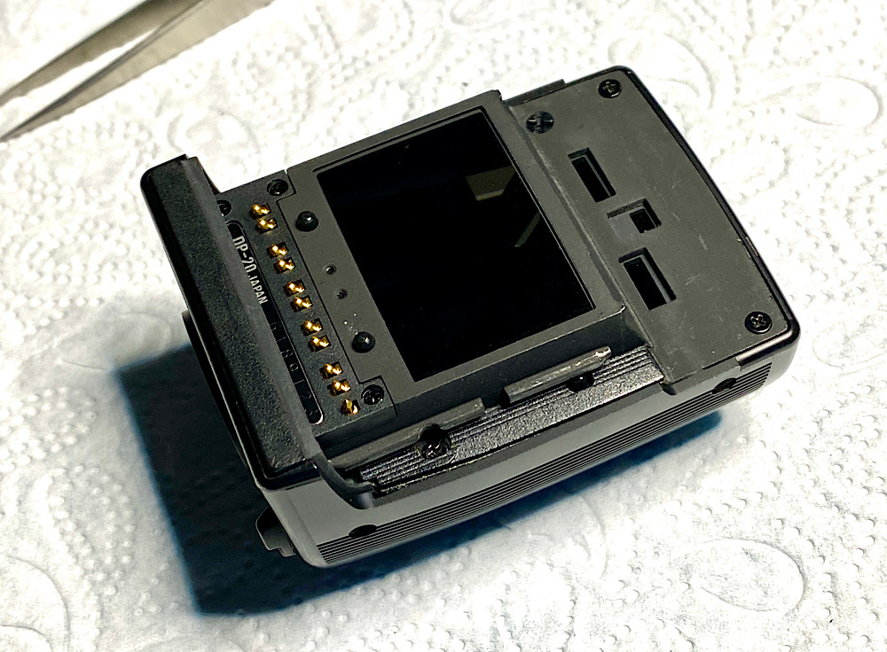

Loosen the screws on the bottom and side (2 x 4 screws).

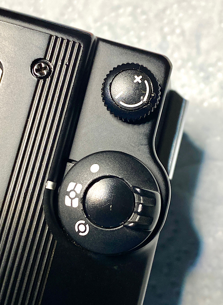

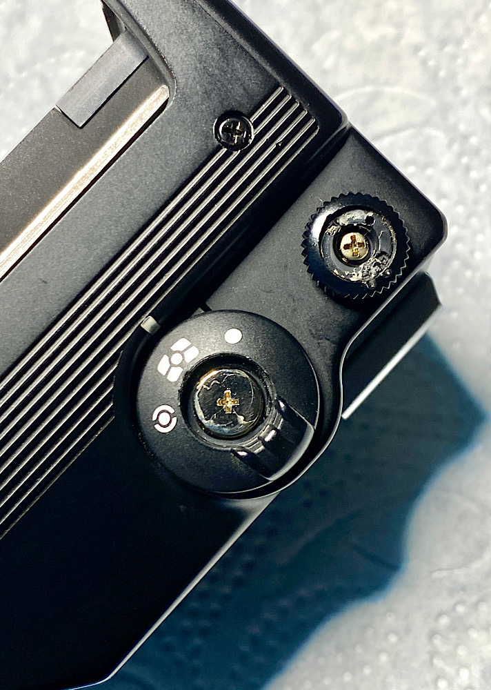

I have already removed the two cover caps on the rotary switches for the diopter corrector and the exposure metering mode. The screws underneath must be loosened so that the top cover can be removed.
The cover caps, as well as the two rotary switches, are made of soft plastic.
The caps are glued in. They can only be levered out, leaving unavoidable marks.
I used a flathead screwdriver with a small blade for this.
The screws are loosened.

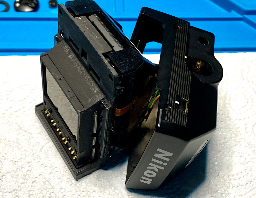

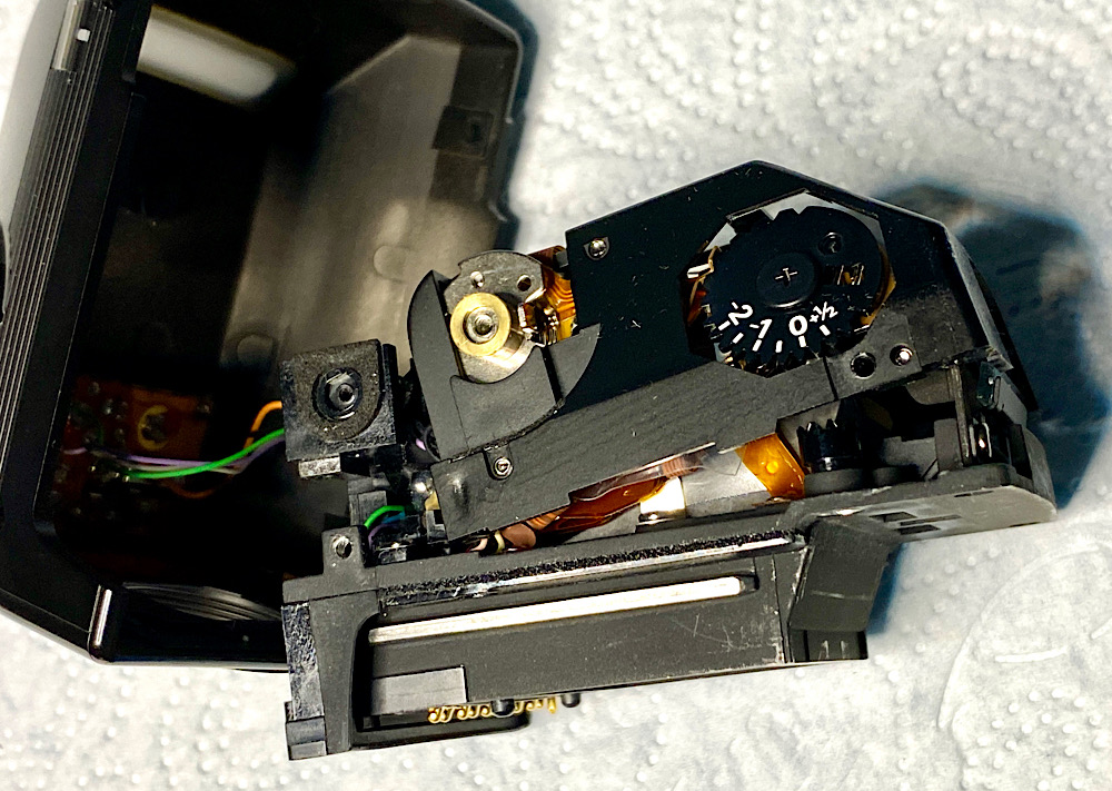

Under the cover
The front of the viewfinder.
On the left is the rotary wheel for adapting the exposure metering system to different focusing screens. The wheel is operated via an adjusting screw on the underside of the viewfinder.

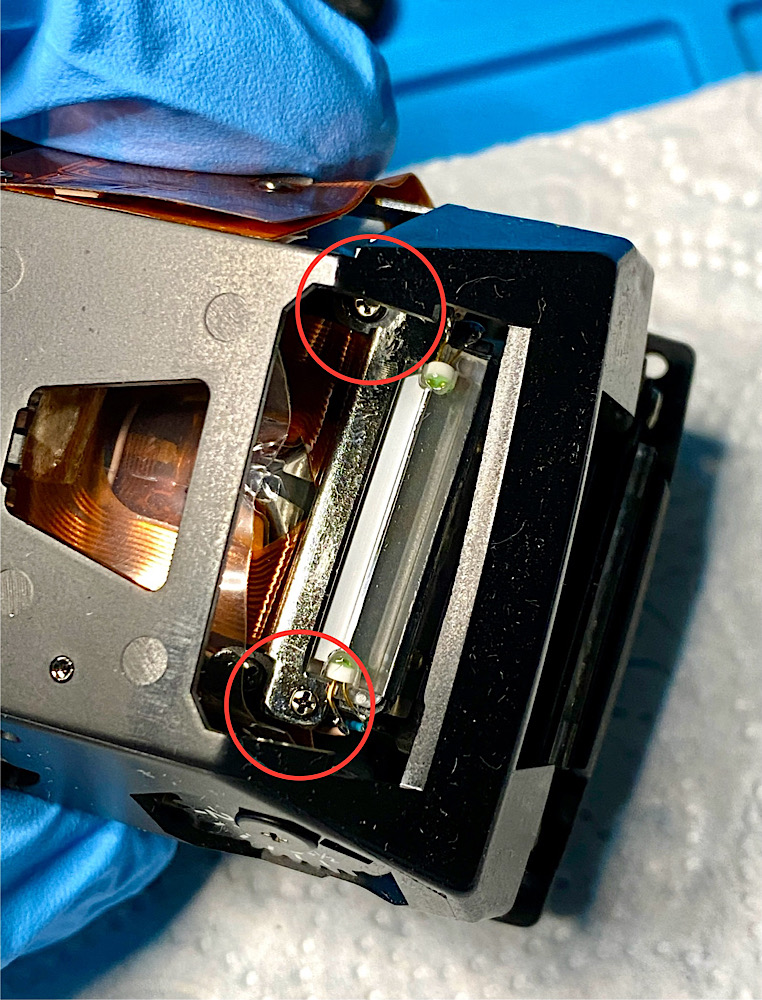

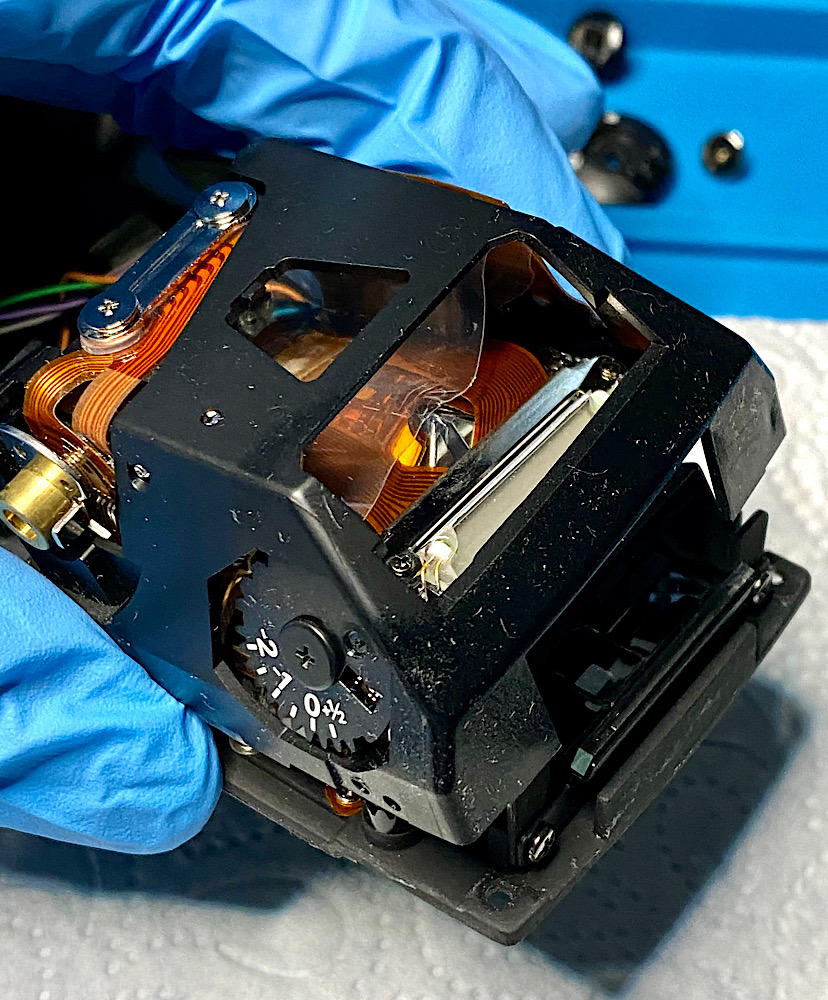

The LCD is located on the front of the viewfinder.
Above it is the illuminator with two turquoise LEDs on the left and right, which consists of a prism.
In order to access the LCD, a bracket, which is held in place by two screws, must be removed.
The bracket and its two screws.
The prism hangs on two cables and can be lifted.
Below is the LCD, which sits with its two conductive rubbers on contacts on the flexible circuit board.
The LCD can be carefully removed from the contacts using the angled probe.

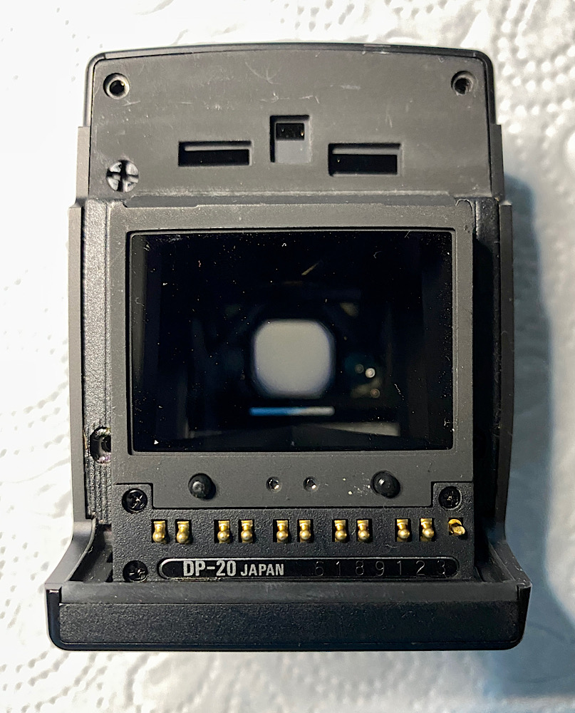

Here you can see the drive for the diopter correction of the eyepiece, which is operated from the outside using a rotary switch.
As you rotate, part of the eyepiece inside the viewfinder moves back and forth
The red slats of the eyepiece shutter, which is activated via a lever on the outside.
The case is reassembled.

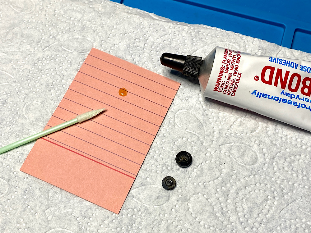

The two cover caps for the rotary switches are fixed with Pliobond.
The damage caused by prying it out beforehand was limited; I was able to smooth out the areas with the blade of the screwdriver.

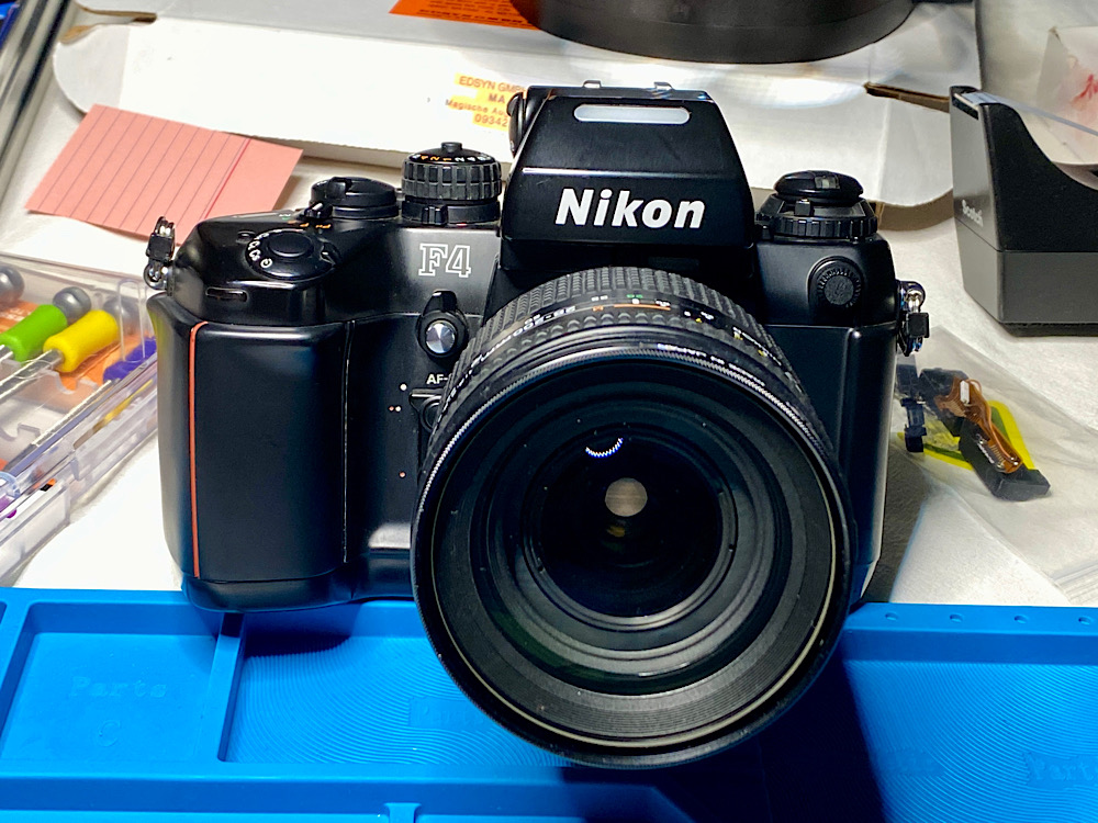

Testing the reassembled viewfinder on the F4.
Both displays work.
The upper display is integrated into the camera housing and is reflected.
The lower LCD that I examined earlier and is part of the viewfinder shows severe bleeding. But you can still work with it.
The test run to replace the lower LCD was successful 👍

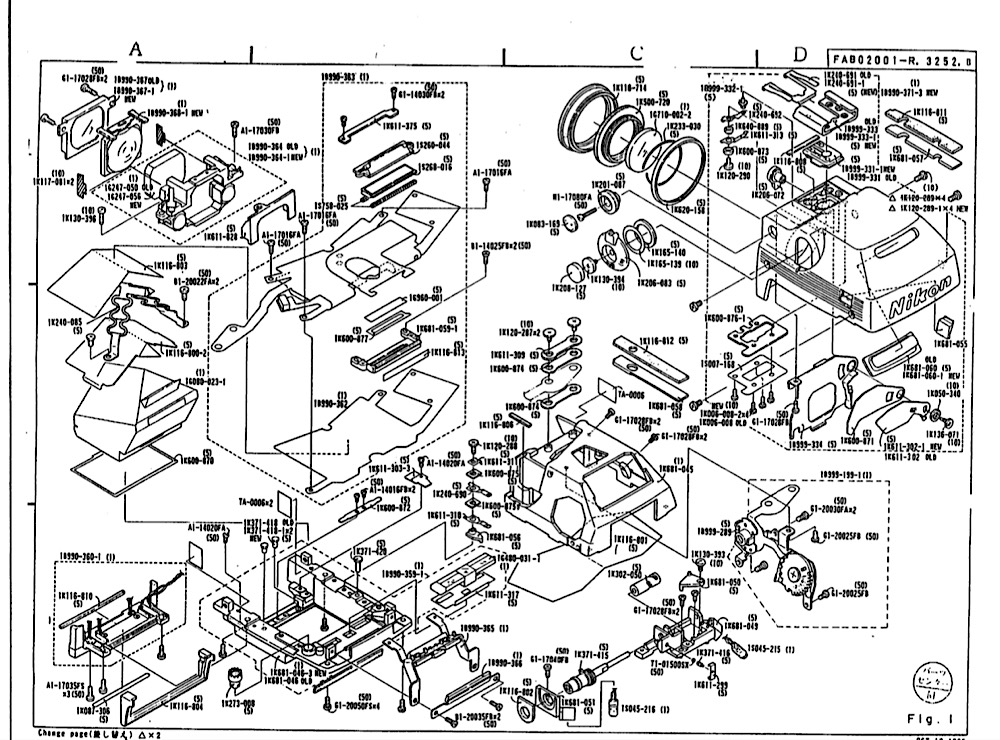

The complex structure of the DP-20 viewfinder.
(Page 47, PDF)
