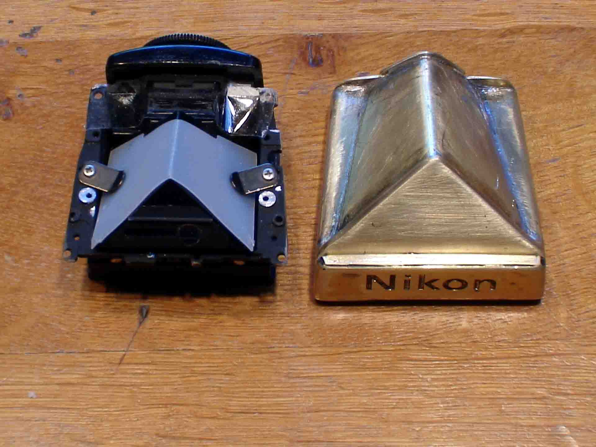

First step was to remove the vinyl covering from the top and remove the top cover.

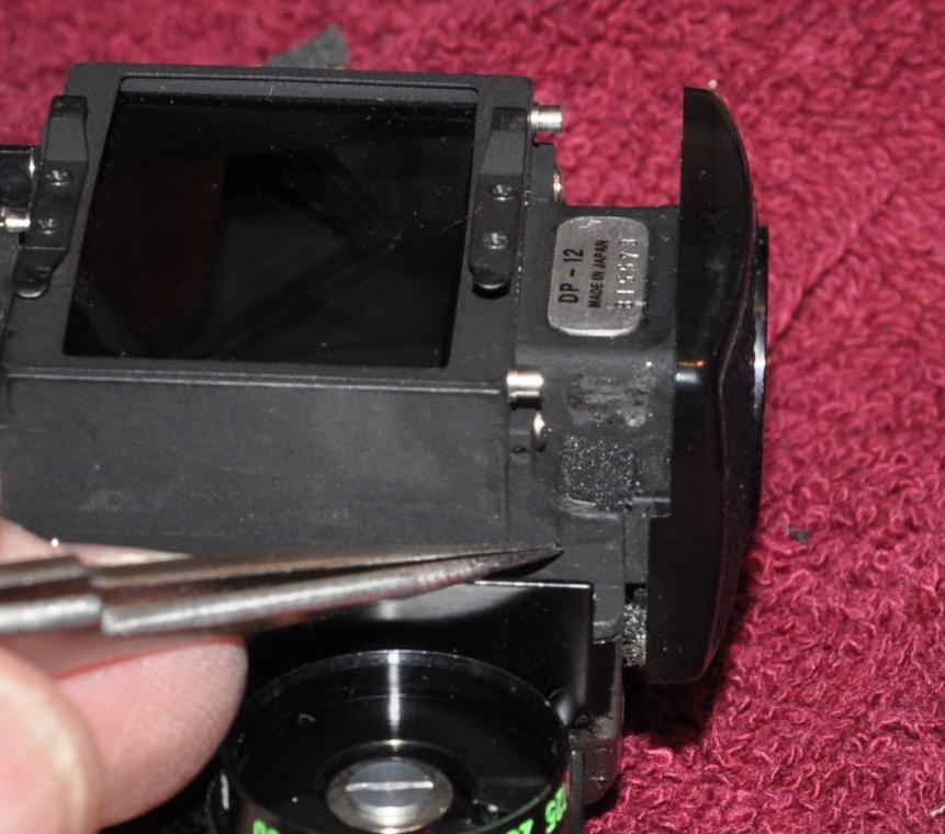

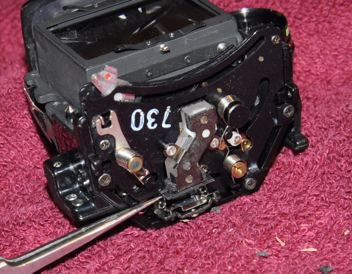

There is a piece of foam rubber covering the indicator LEDs. Remove that and replace it later with a new piece.

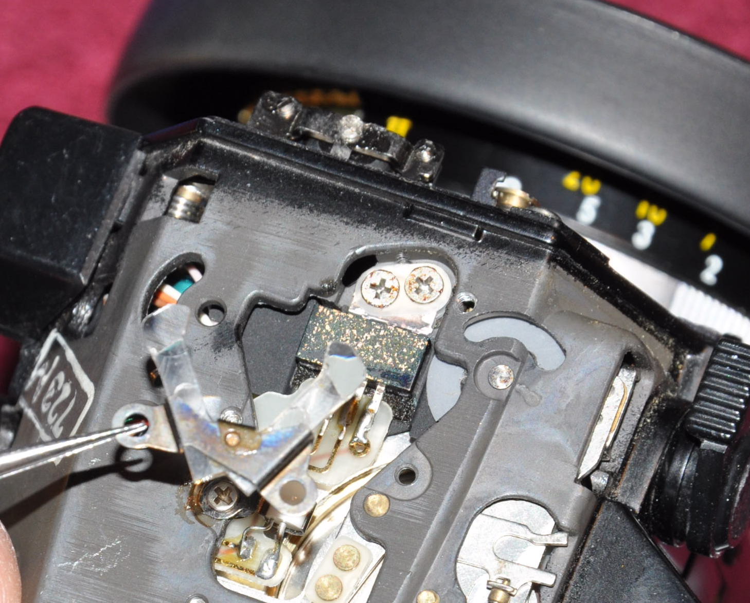

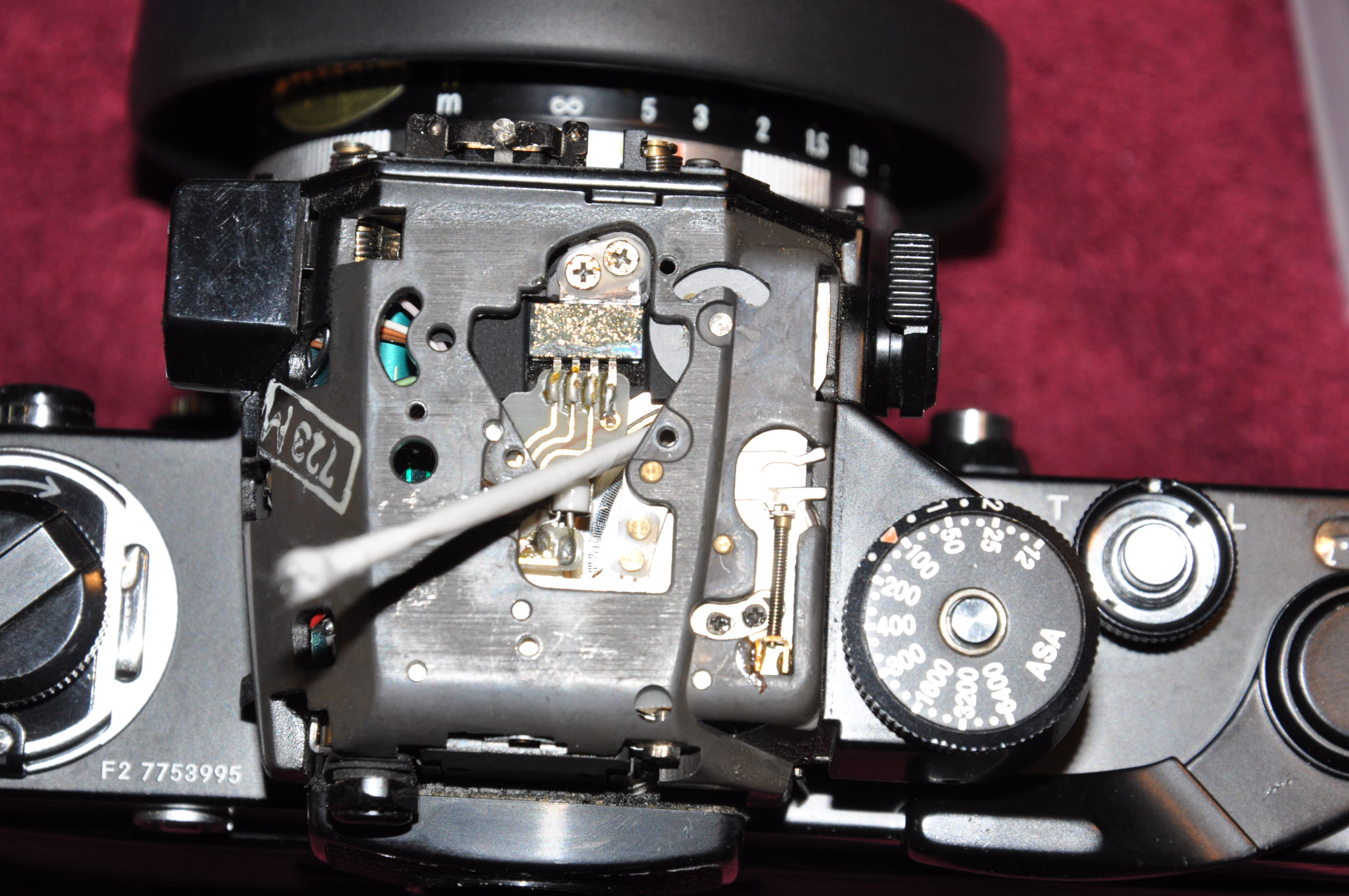

There is not any access to the FRE from inside the unit. So we will access it from the top. Remove the V-shaped LED light pipe.
It is a tight fit, but the end of a soft cleaning stick can reach the FRE. I used ethyl alcohol and DeOxit to clean it.
In my case cleaning the FRE solved the issue of the (-) light staying illuminated at shutter speeds greater than 1/125.

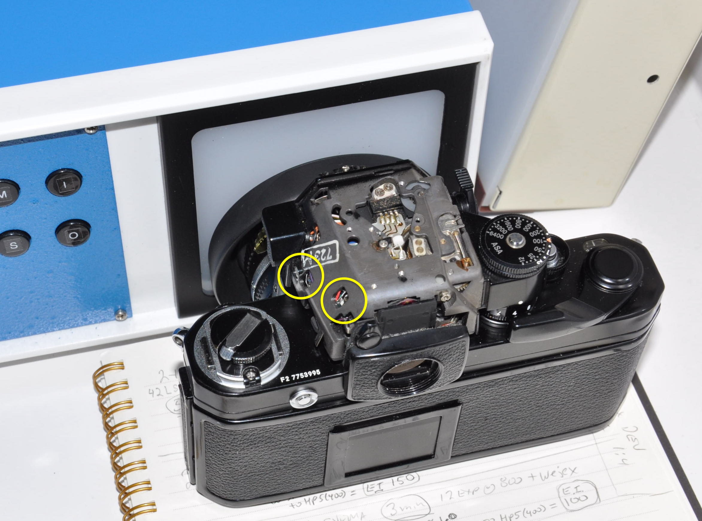

Fine tuning the light meter's response with a calibrated light source. The Nikon DP-12 service manual documents how to do the adjustment. Basically the front most trimmer outlined in yellow is the overall gain and the rear one adjusts the slope of the response. In my clase only a small tweak was needed.
I calibrated at EV5, 9 and 16. The manual asks for calibration at 0EV but who has a calibrated light source that dim?
BTW: don't adjust the trimmer at the very front (not circled).

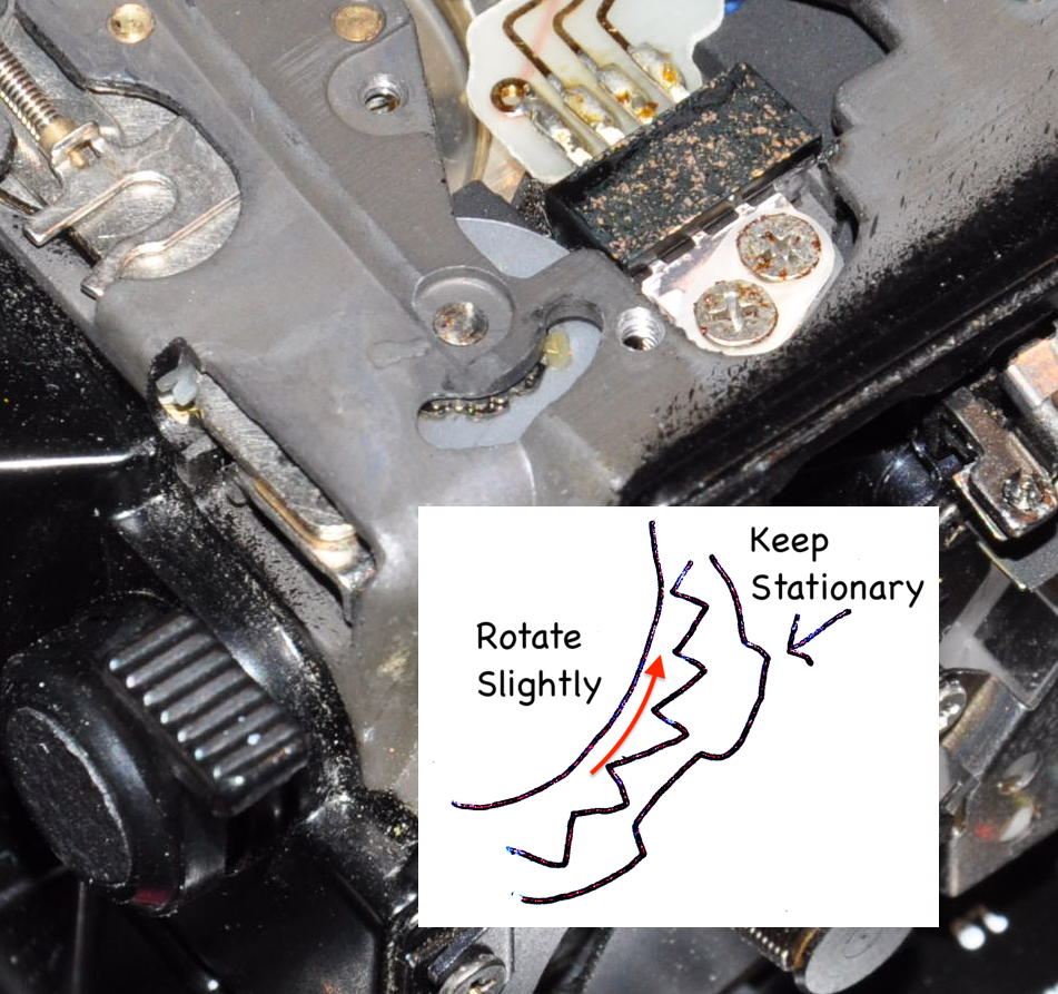

Alignment of the shutter speed numbers in the viewfinder is the same as DP-2, DP-3 and DP-12. The adjustment is outlined in the service manual, but may not be entirely clear as to what to do.
There are two overlapping disks. One with teeth like a gear (#104) and the other with ridges and grooves (#107). They are not glued together and are touching only with friction.
The idea is to hold #107 stationary and tweak #104 one way or the other to align the numbers. A little trial and error is needed.
These are both very, very small. I used a 1mm screw driver and a needle tipped pickup. Unless the numers are way off, only a tiny nudge is needed.

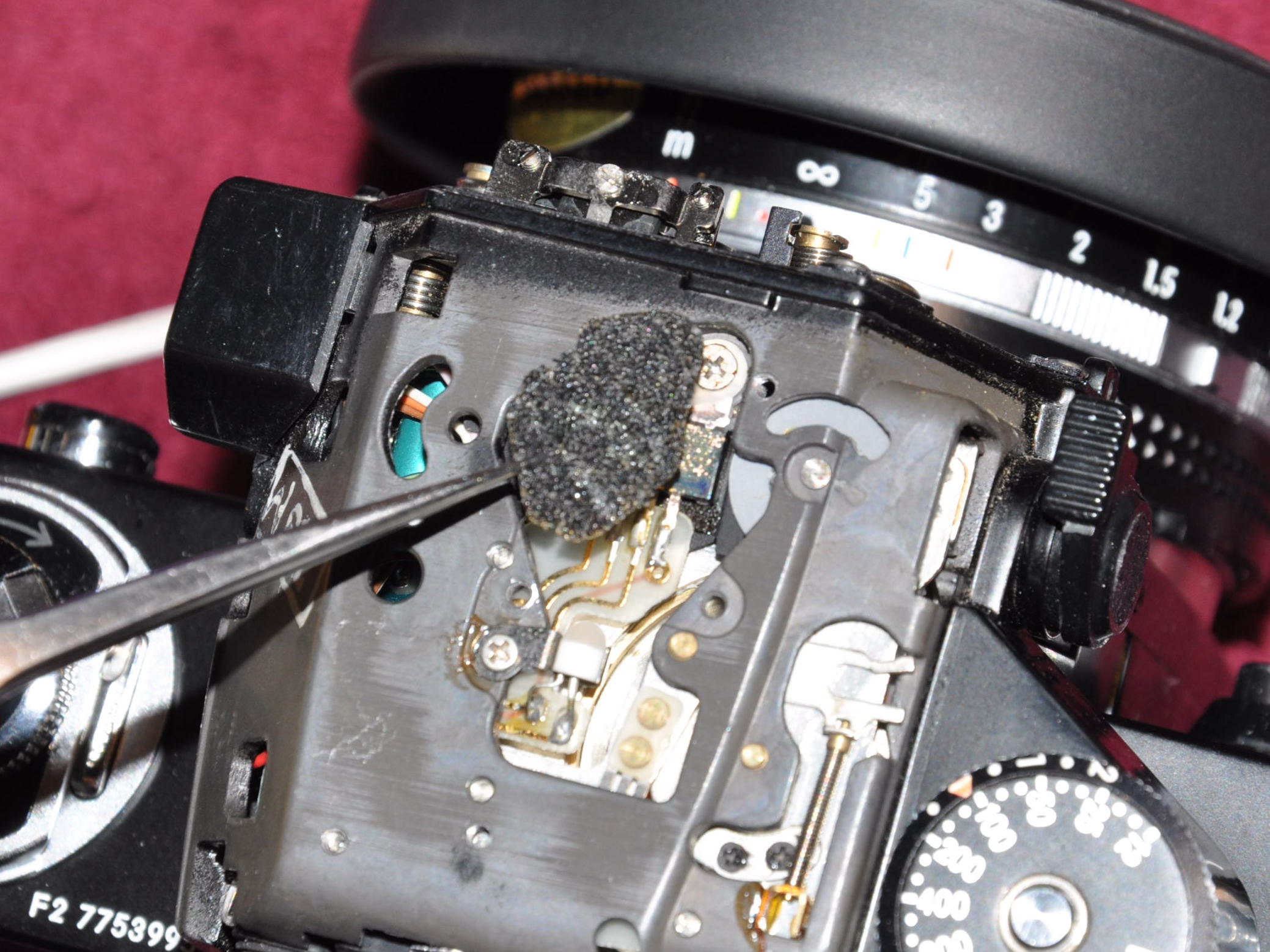

I replaced two tiny strips of foam rubber here.
I replaced the foam here and on the other side.

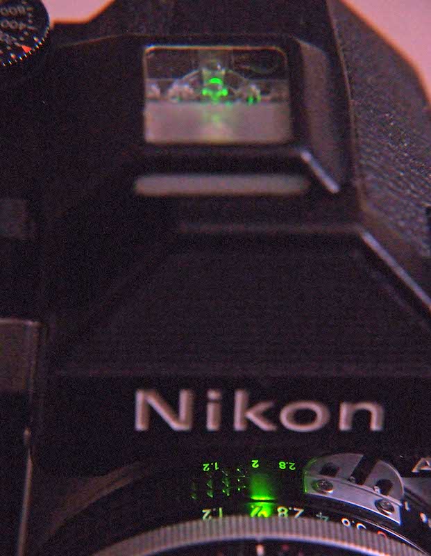

Little know fact, when the AI lever is flipped up into the finder to use pre-AI lenses, a red filter moves over the f-stop indicator in the viewfinder, making the numbers red. Yes, normally one would not know this because pre-AI lenses don't have the little numbers. But, if you do flip the tab up, and mount an AI lens to use in Stop-Down meter mode, you will see the numbers are now red to indicate your AI lever is flipped up.
Another cool feature. When the viewfinder shutter is closed, the little red light on top becomes active and will illuminate when correct exposure is set. Otherwise, when the viewfinder shutter is open, the top light is a combinatyion battey check light and low-light shutter-speed illuminator. Too bad it does not also shine on the aperture ring.

Good question. Not sure, but I did see on Sover's site a DP-1 to kind of DE-1 conversion in metal. When I saw that I thought it might not be difficult to come up with a 3d printed cap for a failed DP-1 to make it more like the DE-1.

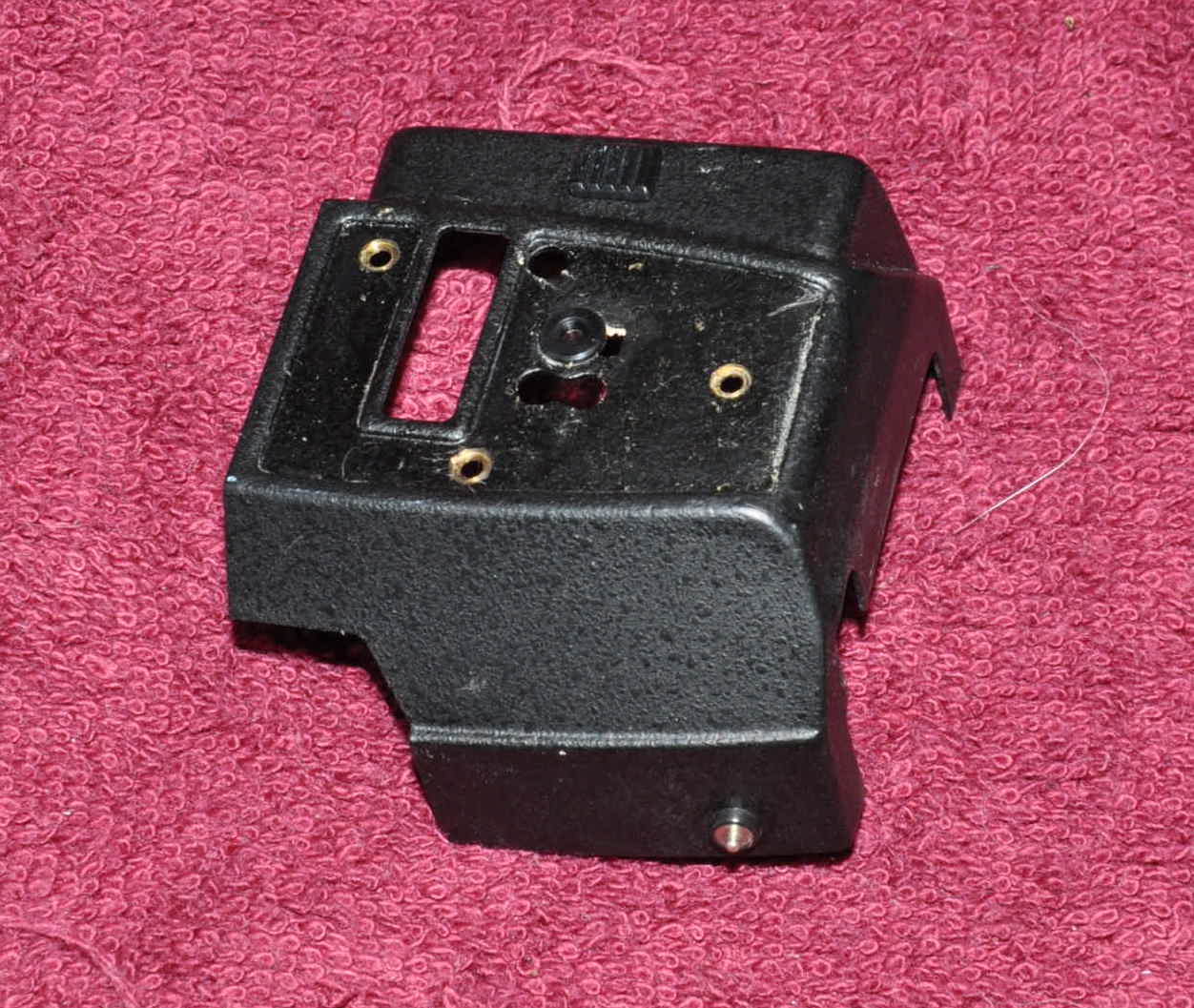

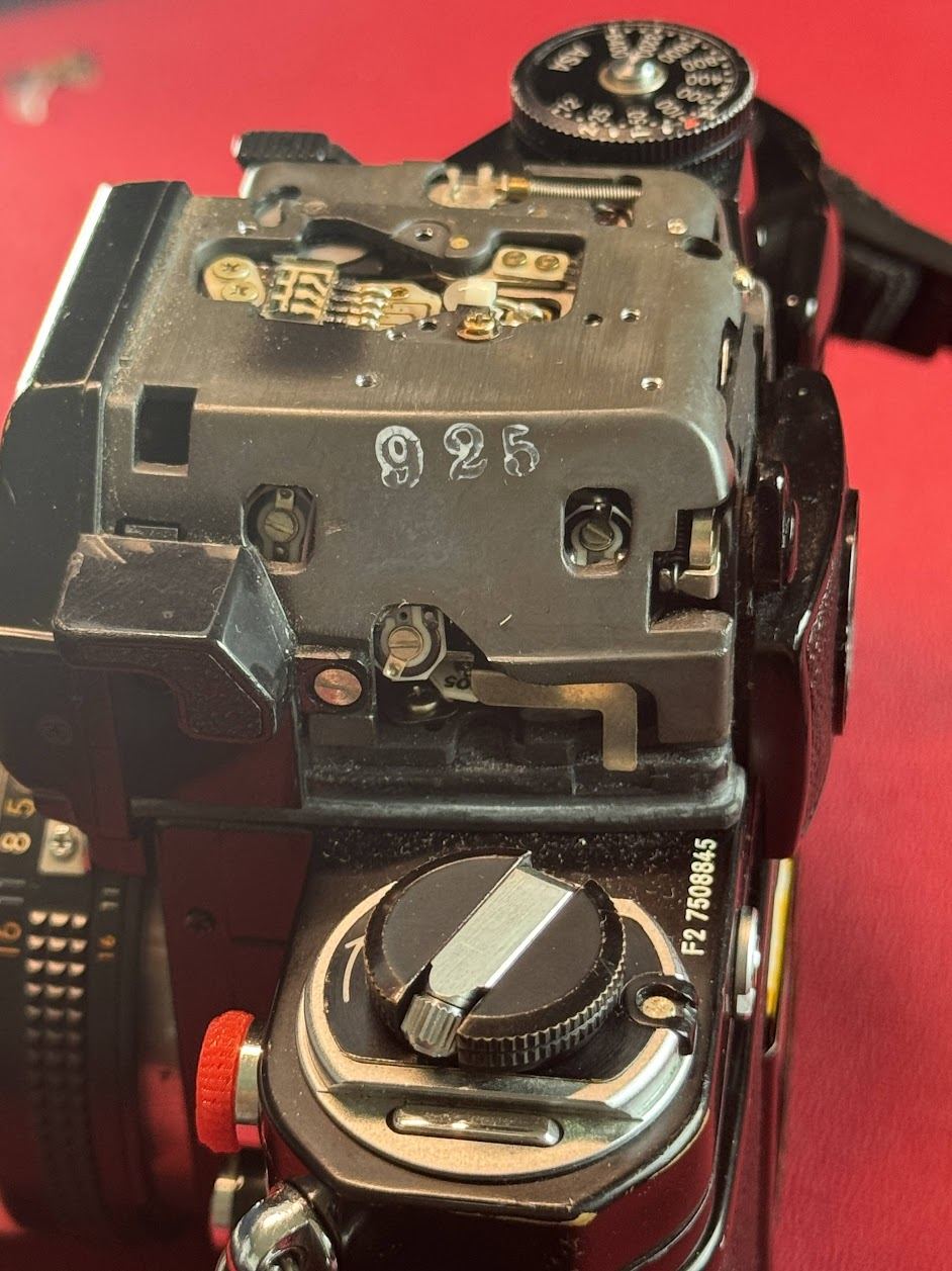

I'm curious how you were able to remove the top cover. After removing the four visible screws under the vinyl, no part of the top cover showed any sign of loosening.
Why four screws? There are only three screws under the leatherette at the top that need to be removed. If you look at the picture in post #1, you can see the three holes.
Also check out this screenshot from the official repair manual:
There are four screws under the leatherette. Not knowing that only three of the four need to be removed, or which three, I removed all four. The top cover did not loosen or come free. So I asked here, to see if there were some further operation needed to free to top cover. It may be that my DP-12 is a variation from the one described here, it does look a bit different under the leatherette.
You also have to remove the front cover with the "Nikon" logo.
I did that, but didn't touch anything under it. I wonder if one or more of those secure the top cover as well. But really, there was absolutely no give whatsoever after removing the screws under the top leatherette so I sort of wonder if something is glued in place, maybe by a previous inept repairer. (not like the current inept repairer!)

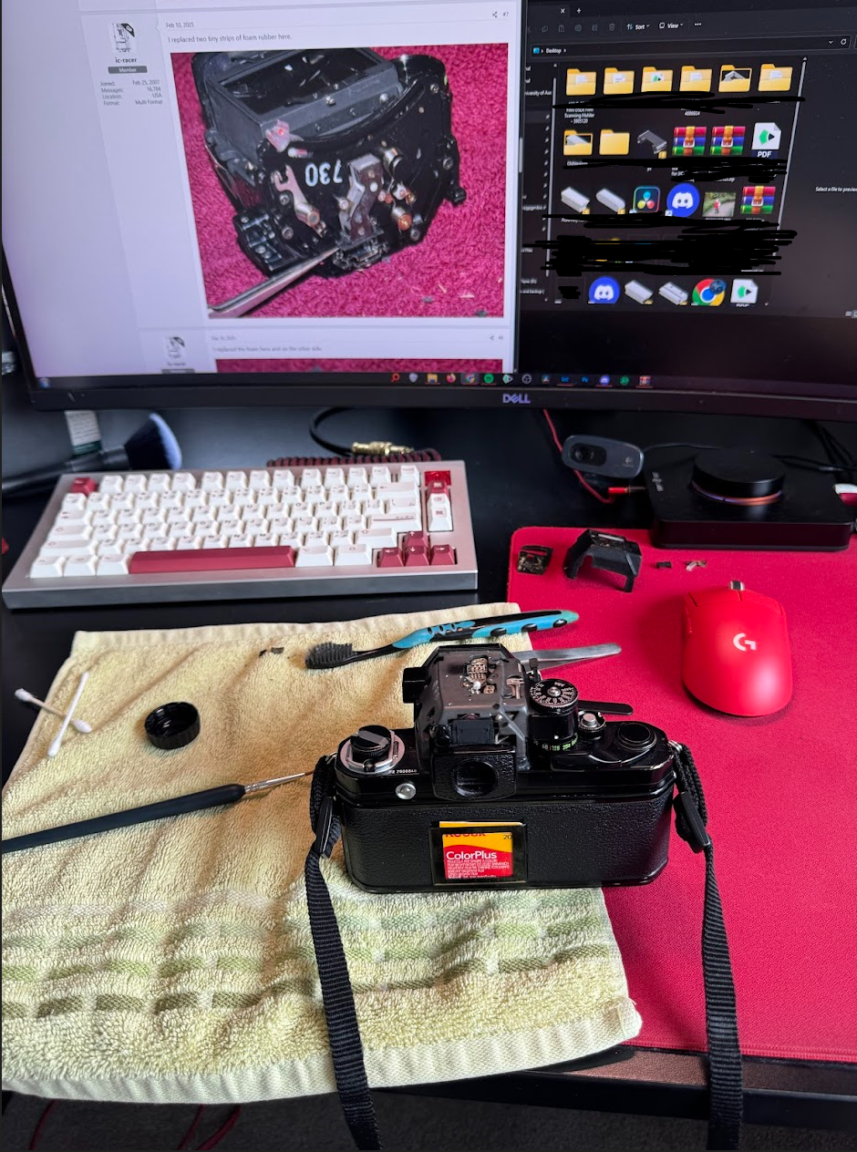

Just wanted to say that this really helped with repairing my Nikon DP-12!
Mine was telling me it was 5 stops overexposed at all times and seeing how easy it is to disassemble and adjust the metering gave me confidence to take it apart.
My meter is close enough to what my DSLR gives me when pointed at the same objects (I don't have a calibrated light source lol) which is good enough for me.
Also, to remove the top cover, I removed the leatherette and unscrewed the three screws, the top part wriggled off easily. I didn't have to remove the front Nikon logo.
