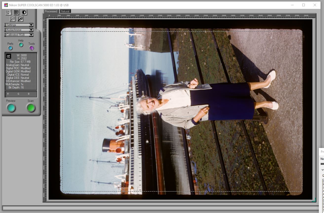

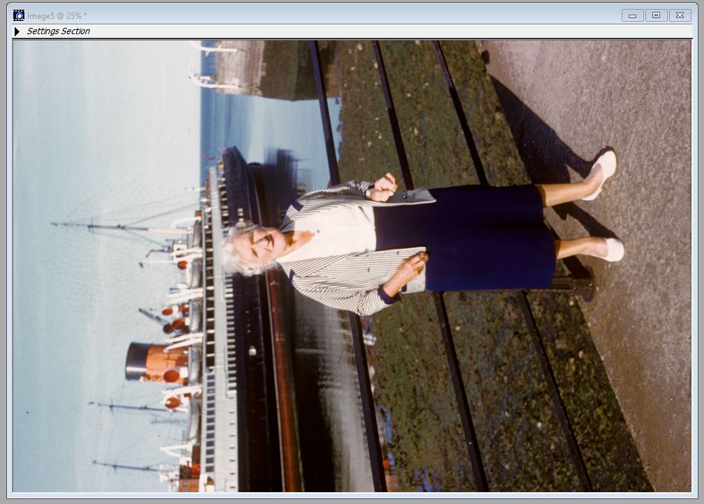

If I scan an adequately exposed slide, the preview and the scan look about the same. Here's an example of my grandmother. The preview:
The scan:

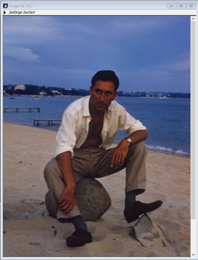

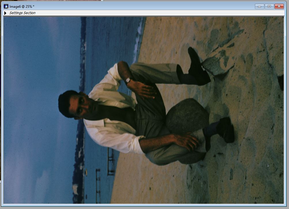

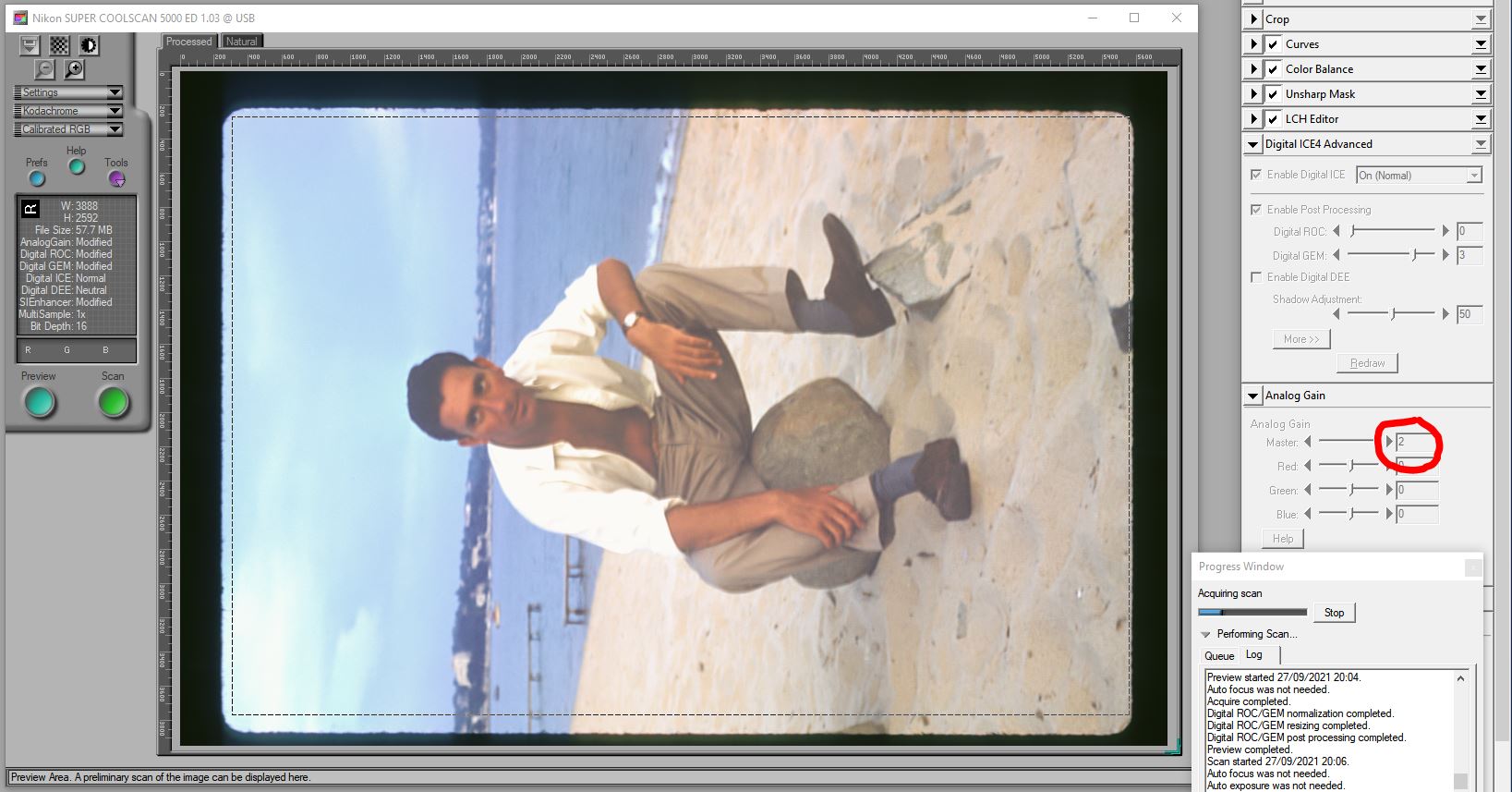

They're roughly the same. But I've also got a couple of slides (of my father) which are pretty underexposed. I can get the preview looking fairly OK by setting the Analog Gain Master to 2 but the result of the scan remains very dark - almost as if the change to the gain has been ignored. Here's the preview:
Here's the actual scan:
Does anybody know what I might be doing wrong? I'm reaching the end of my tether! Any help would be gratefully received and help that solves my problem would solicit eternal gratitude. Or something like that.

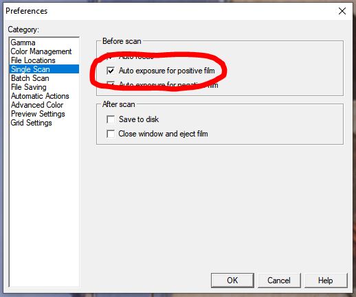

Thanks Kino. By auto exposure, you mean this?

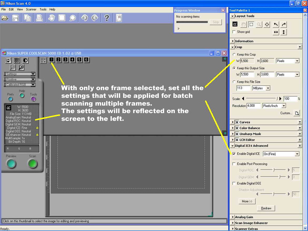

That does seem odd to me as I've never seen the result not closely matching the resulting scan in thousands of scan using Nikonscan since 2000 to present. I also use Analog Gain Master quite a bit and I still don't recall ever seeing this discrepancy..
Is "Enable post processing" enabled/selected? In my default setting, I always disable it - on in Nikonscan, not select/enable it. This is what that screen shows right below Enable Digital ICE . . .
#3 by Les DMess, on Flickr
In my flickr album, I show my normal default setting to create a setting to save (#1 - #5) and how to apply a saved settiit to seelcted frames (#6 - #13) -> https://flic.kr/s/aHsmWLJmWJ
I will try to find a very underexposed slide and see if I can replicate your settings if this doesn't correct it.
Thanks for all your help. I've had a bit of a breakthrough. Although the slides are Kodachrome, I've set the film type to positive - that led to a marked improvement both in overall colour and exposure. Also, the preview pane matches the scan result.
Setting the master gain to 2 and the individual R, G and B ones to 1, gives me something I think I can work with in Lightroom.
(My father, early 1960s.)
That's pretty good considering how dense Kodachrome gets being that underexposed. Does the preview match the scan now?
Righty ho! I think I've tamed the beast. I'd overlooked "Scan Image Enhancer". With "Auto exposure for positive film" turned off (aside: does anybody know how this works in relation to "Scan Image Enhancer"?) I found that there was a massive discrepancy between the preview and the real scan for both Kodachrome and standard Positive film when SIE was turned on; the real scans were very dark. With SIE off, the scans matched the preview and were pretty good in terms of exposure.
All of this was with the defaults for Analog Gain (i.e. 0, 0, 0 and 0).

I don't have a scanner that supports scan image enhancer and haven't used Nikon Scan in a long time. However, from reading the description, I think SIE is doing an auto contrast adjustment (and hue etc) after preview and during scanning. In the case of your problem slide, I suspect what is happening is that it is setting the contrast to accommodate the whitest levels of the white shirt, which unfortunately then puts the majority of the scene too far down the curve - too dark to deal with. Compare to the preview, which is blowing out the highlights of the white shirt but leaves the rest of the scene at a workable level.
I think you're absolutely right - thanks for the explanation. There's also a case of RTFM; "... note this may not have the desired effect on dark images." So I think I'll usually have it on but turn it off for dark images.
