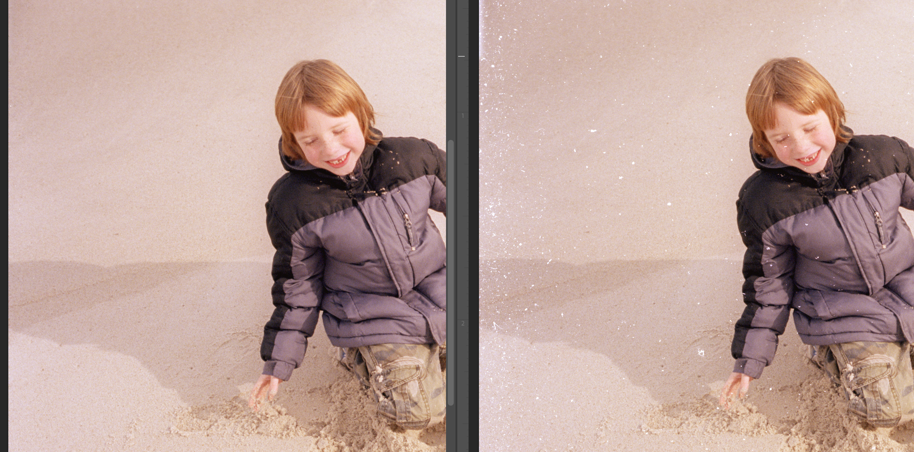

Please do report back, if possible with examples. Here's a portion of a damaged 35mm Ektar negative (less than 1/3 of the negative) from maybe 15 years ago. (Nikon Coolscan IV ED) I see some softening of the image from Vuescan's "infrared cleaning" which I have not corrected with sharpening. If I had Nikonscan I'd do a direct comparison but I can't to that. Soon you will be able to do the comparison though so please do share.
It's best to never need or use ICE of course and thankfully I've not needed it for more than a handful of negatives in the last 20 years but still it's interesting to learn about it.
View attachment 366254View attachment 366257
