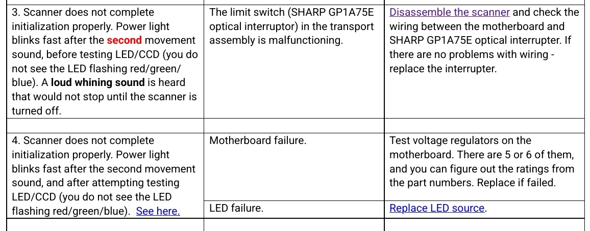

I don't remember the order of the steps in the calibration, but it will abort when it comes to a step that fails. Have you established that it is the LED test that fails and not a test before that?
Ok, that was a good webpage. My scanner failed on step 3. It wasn't the optical interruptor. It was a mechanical problem that prevented the carriage to trigger the interruptor. And it was possible to fix.
If your scanner has problems on step 4 then it could be more serious. Hard to know.
That's interesting about that source naming failure at this step as either LED failure or motherboard VRM. Because it seems less likely to me that an LED would failure intermittently, but a VRM certainly would. I hope they're surface mounted rather than pad mounted.
