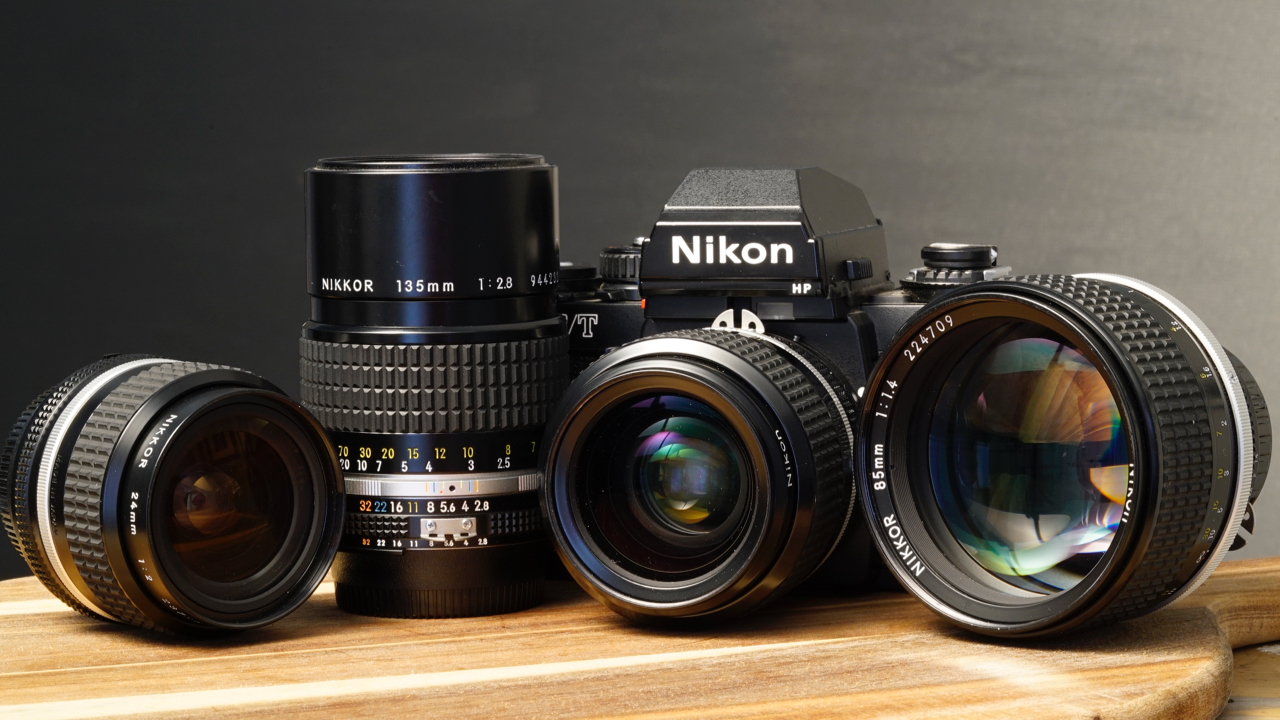

You might find this short video I did on building a system useful. You've made great choices so far. I like the manual focus versions because I enjoy using a manual focus camera. However if I was still shooting with the F5 or F6, I would likely only have AF versions.
https://youtu.be/3sBf0vURdUU
