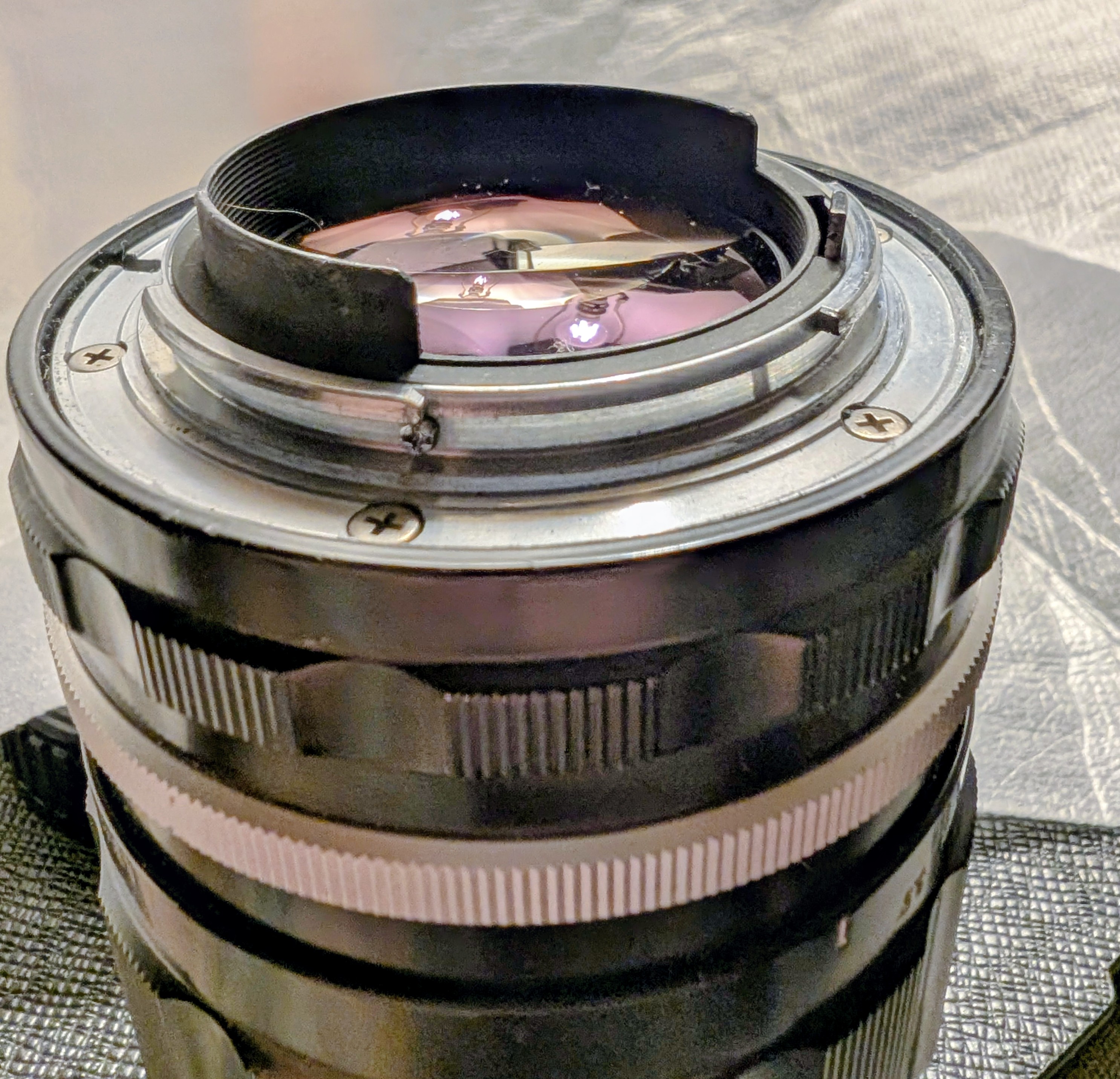

But my question is this... The attached photo is the back office end of a Nikkor PC Auto 105mm 2.5 lens Serial: 525011, which to my knowledge is a non-AI lens. So what is this large cutout in the black section about? My Nikkor Q 135mm 3.5 doesn't have it....has it been AI'd or is the cutout for some other reason?

I think the cutout is something from the late pre-AI lenses on, to prevent the rear element from getting scratched when being put down.
The black ring you're speaking of likely has two uses: as a baffle to reduce internal reflections within the camera body, and as mentioned above, to allow you to set the lens down on its base without scratching the rear element or damaging the aperture stop down lever that protrudes from the rear of the lens. The reason for the cutout is that there is a lever inside the camera body for stopping down the aperture that interfaces with the lever on the back of the lens; when you attach the lens and rotate it to lock it in place, that cutout keeps the baffle from damaging/interfering with the stop-down lever inside the camera body.
I also have both the 105 and 135mm lenses you have. I don't think the 135 needs the cutout, because its rear element is of smaller diameter than that of the 105. So that baffle is very, very slightly smaller in diameter than the one on the 105, which I assume means the stop down lever doesn't need the clearance to keep from hitting the baffle. According to my digital calipers, the outer diameter of the baffle on the 135mm is 36.2mm, while the one on the 105mm is 38.1mm. So that's probably why the cutout is necessary on that lens, but not the 135.

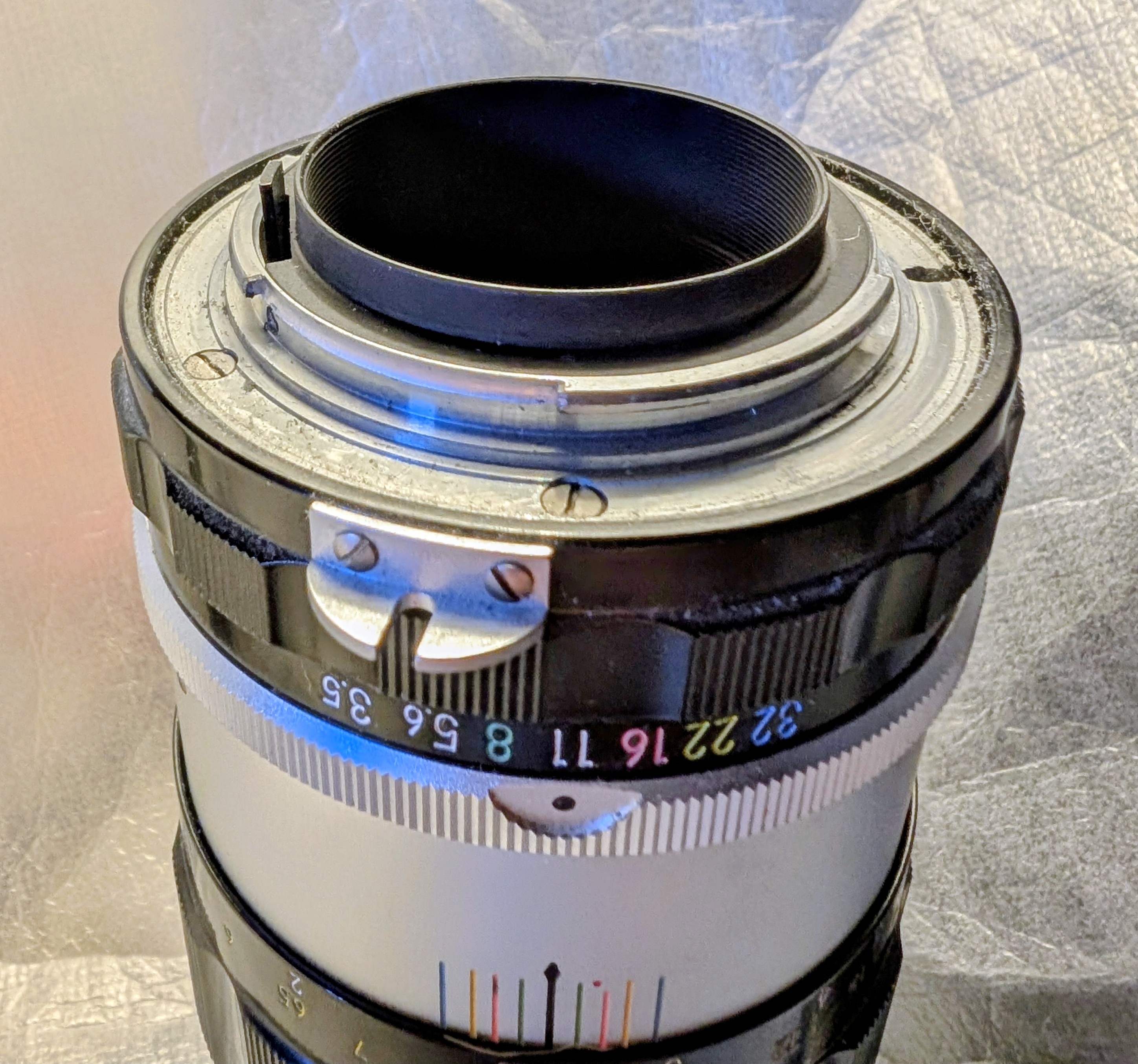

That makes a lot of sense! For the benefit of anyone wondering what we're talking about, herewith the same view of the Nikkor Q 135/3.5...
Yes, this is the correct explanation. If you look at the original picture of your 105, at the 3 o'clock position you can see the aperture stop-down lever tucked into the bottom edge of the black baffle. If you look at an AI capable body, you will see the corresponding body-side stop-down lever at the 9 o'clock position. When mounting the lens you need to rotate it approximately 60 degrees counter-clockwise, so the cutout in the lens baffle is there to allow the body-side stop-down lever to clear the baffle and engage with the lens-side stop-down lever when fully mounted.
Later on, when Nikon brought out the AiS mount variant, these lens baffles got even more convoluted as there's another body-side lever to detect lenses with 135mm or longer focal length, and the baffle for shorter lenses needs an additional cutout to avoid engaging that lever. Only a few bodies even had the focal-length detection lever, notably the FA, but every lens got their rear-ends re-designed to support this feature.
