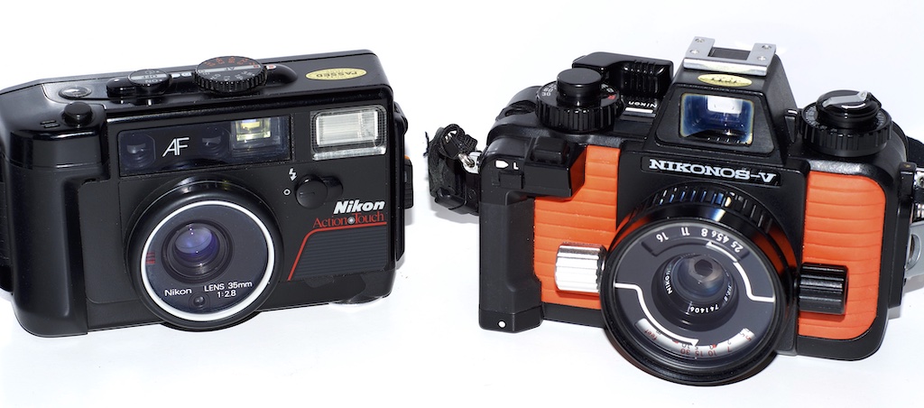

I had good results with my Nikon One Touch (LF35AF-3) so I picked up the underwater version (Action Touch LF35AW) to see how that one works. I use my Nikonos in bad weather, and the Action Touch seemed to have some features that the Nikonos does not have.
Here are some pictures:
Camera Nikonos V Action Touch
Lens Focal Length 35mm / 7 elements 35mm / 4 elements
Lens Aperture f2.5 f2.8
Focus Manual Only Manual or Autofocus (Land Only)
Exposure Auto and Manual Auto Only
Flash External Only Built-in Only
Film Winding Manual Only Automatic Only
Handling: The Action Touch is lighter than the Nikonos and heavier than the One Touch. The One Touch feels like cheap plastic to the Action Touch. The Action Touch has some heft to it that makes it feel like a more substantial camera. Kind of like the One Touch camera & 35/2.8 lens in more of a Prosumer package.

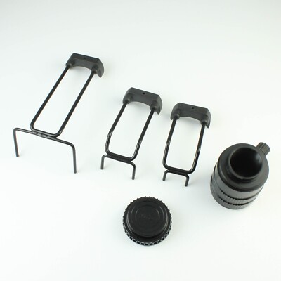

Yes, I have that kit but only tried it once or twice. It comes with three wire composition framers and a lens adapter to get macro shots with three selectable ratios 1:1, 2:1, 1:2. Here's a picture.
