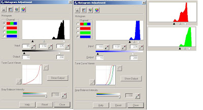

I see it at all magnifications. It default to 16% in my Scan 4 viewer when I do the scan, and the quality of the image doesn't change when I up the magnification to 50 or 100 or 200%.
ok ... anything like this?

I forgot to address this point:
The curve that Nikon Scan displays as a result of the scan is quite different than the curve Nikon Scan displays when retrieving the saved file: the peaks of the curve on the retrieved file are about 5-10% shorter (especially on the right side of the graph.
I feel you are getting terms mixed up ... do you mean the levels in the histogram? The histogram adjustment has both an input and an output level, I'm sorry but not having my nikon scanner here I can not start Nikonscan to show you on that, but on the Epson (which is similar) it is like this:
notice that there is both an input and an output line under the histogram? (hopefully that image links properly to a larger version from my blog) So in the case of that figure above I have specifically set my outputs to 0 and 255. This sets the levels of input to the levels of output. My scanner defaults to 10 and 245 which will result in the histogram having a blank set of data left and right when I open it in photoshop.
Note also that this remapping of the numbers can be linear or have a "curve" applied to it that is the number that exists in the middle of the input levels (1.00 in my case). Changing this will apply a curve (or gamma) to its mapping process. This is different to where you set the start and end points to.
