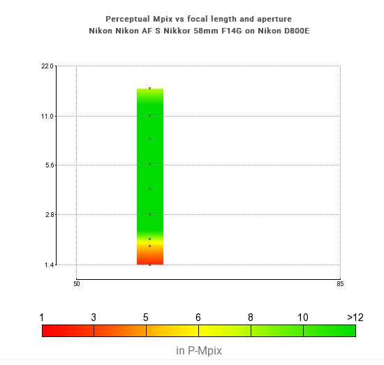

The 58mm is technical marvel because it avoid coma at F/1.4, not many glasses do that. For the rest it's like the 50mm 1.4G but with the drawbacks of slightly larger distortion and delivering focus breathing.
Here we see general sharpness vs aperture:
Also it's quite interesting to see here: https://www.dxomark.com/Lenses/Nikk...4G-mounted-on-Nikon-D800E---Measurements__814
The Sharpness/Field section, field at different apertures.
