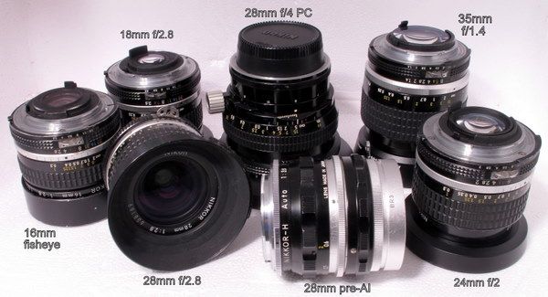

... my main interests is landscapes so a decent wide angle lens is very important to me...
I have the following wide-angle lenses for my Nikon 35mm cameras: 18mm, 24mm, 28mm, and 35mm.
For landscapes, my first choice is the 28mm.
https://flic.kr/p/aq4k62
