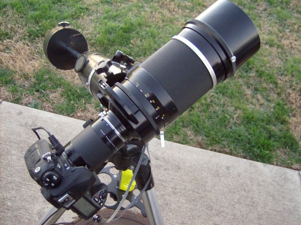

Since I have no experience with the Russian mirror lens, I cannot comment on it.
I have had years of experience with my Nikon f/11 mirror lens and have been very pleased with its performance. If I were looking for mirror lens for my Nikon camera, I would not consider any lens other than Nikon unless it had a bargain price, was optically superior, or both.
