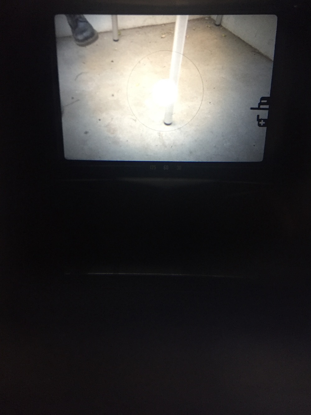

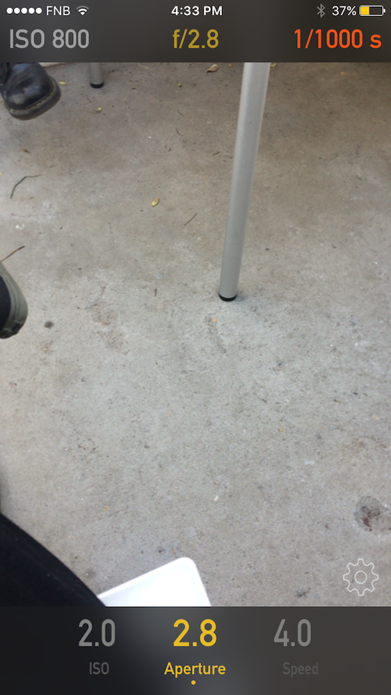

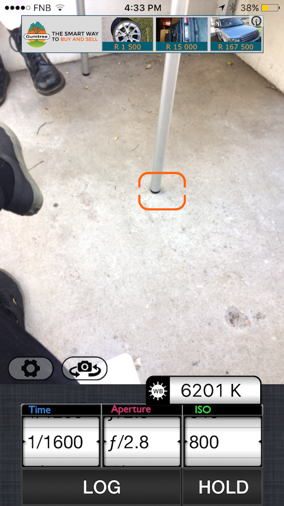

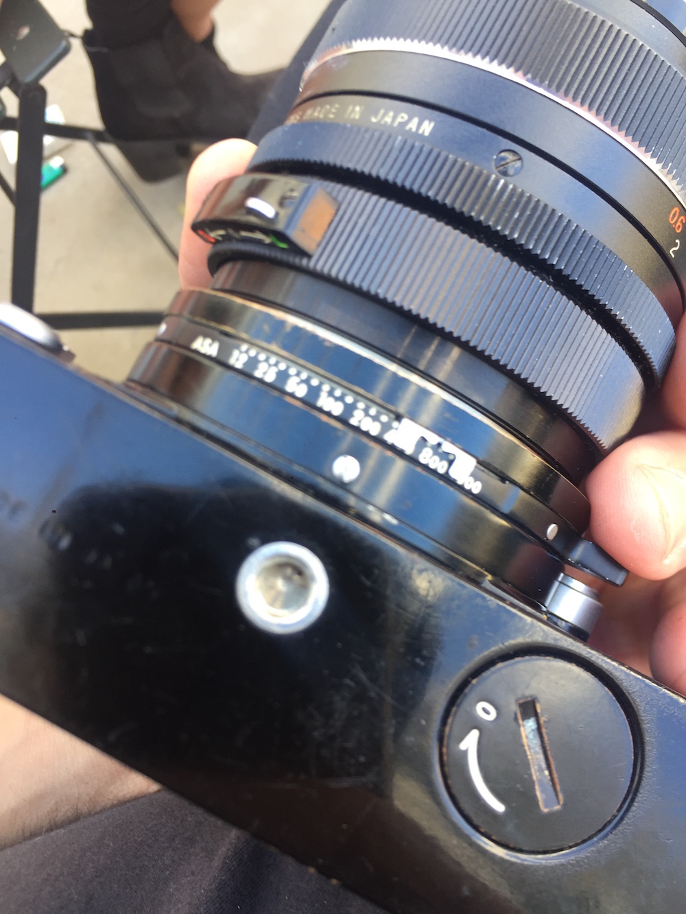

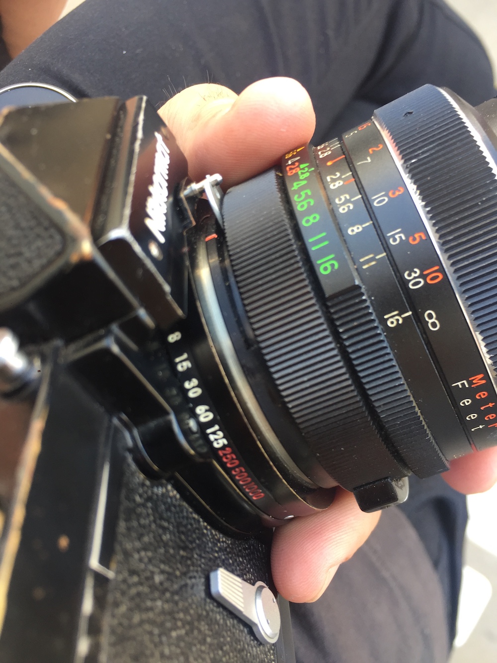

Hey There,
So I got a Nikkormat FT a few days ago but I think the light meter may be faulty,
I downloaded a few iPhone app to try and prove that the light meter is off.
Check the attached pics
With the camera set to 800 iso film and 2.8f is saying I should shoot at 1/60... when the apps all say over 1/1000 ???

- Are you indexing the lens after mounting it? Turning the aperture ring fully back & forth once to min and max apertures indexes the meter for the speed of the lens.
- This looks like a non-Nikkor lens you have mounted. Do you have a Nikon lens you can try this with?

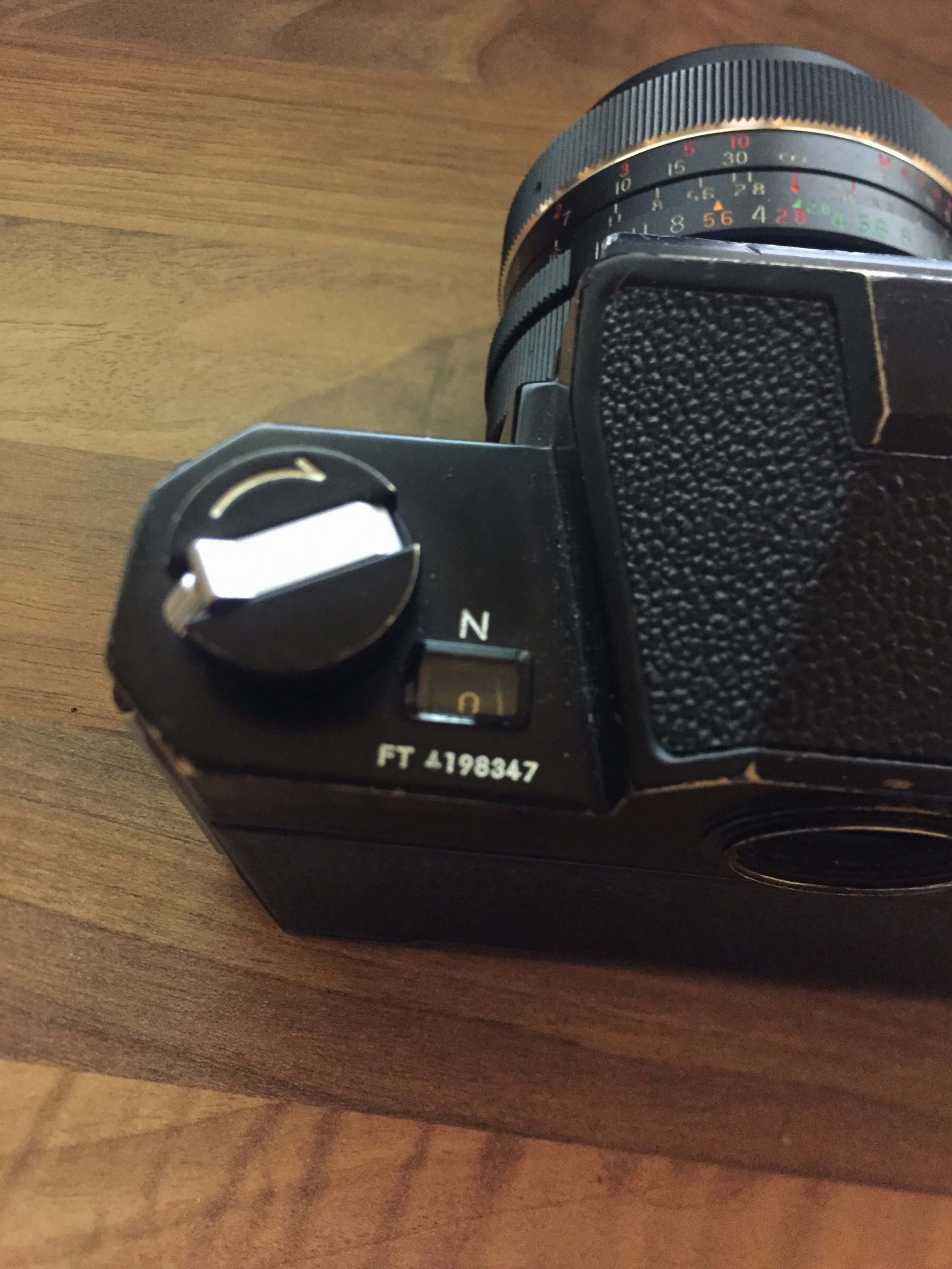

The photos are of an FTn though so the indexing does apply. Check the red line on the left of the mount is lining up with the correct maximum aperture after indexing.
Ronnie
It is an FT. The max f indicator on the bottom of the lens mount shows this. It must
be set manually.

It's easy enough for Callie to determine if it's an FT or FTn. The "n" has the plastic tip on the film crank and an "N" on the top plate.

Your meter reading in the FTn shows overexposure. It is meant to be in the middle, not touching the top of the bracket.
Looking at that scene I'd say the correct exposure is 1/250 at f4 with 800 ISO film. Or 1/500 at f2.8 for the aperture that you are using. Which means you are still overexposing by 3 stops, which is much more than what your VF needle indicates. If you center your needle you may be 'only' overexposing by 2 stops.

As for those apps screen shots - the second one looks decent, giving an exposure that is correct for a maybe low key look. What is the name of that app? The first one is junk - I'm guessing it is Pocket Light Meter? This is another example of why I gave up on that app.
I don't mean to pick nits here, but I'm pretty sure that the exposure difference between a centered needle and when its touching the top of the bracket (or bottom, far as that goes), this indicates 1/2 stop of difference. Thus overexposure would be more like 2-1/2 stops, not 2.
It also bears mentioning here that the chosen subject for metering appears to be a lightly colored concrete floor. Any meter will interpret its scene as 18% gray, thus this FT(n?)'s meter will be underexposing this scene by probably a full stop in order to achieve that middle-exposure value. So for proper exposure, one would want to open up things a full stop. (Note that the meter is already showing its opened things up by a half stop) A scene such as this is probably 3 or 4 stops off from "bight sun," so if we do the arithmetic, I'm getting about the same numbers as Huss. Open it up to counteract the meter's tendency to meter the scene as 18% gray, and it seems to be two to three stops off.
There is no way in the world I trust meter apps for cell phones. I've tried several, and they all just make me laugh, they are so inaccurate.

The plastic tip was the ft2
The plastic tip was introduced towards the end of the FTn production. I have one FTn with the plain metal wind lever and one with the plastic tip.

You have a FTN as they indicated.

The FTn went to the plastic tip stuff around 4435xxx, serial-wise. So, late 1972 or thereabouts. Leatherette changed at the same time.
