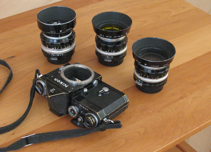

And a look-at-all-my-stuff shot
Hard to believe when digital first swept through these things were practically being thrown away. I imagine a 1.4/35 being tossed into the crusher at the ARC...
