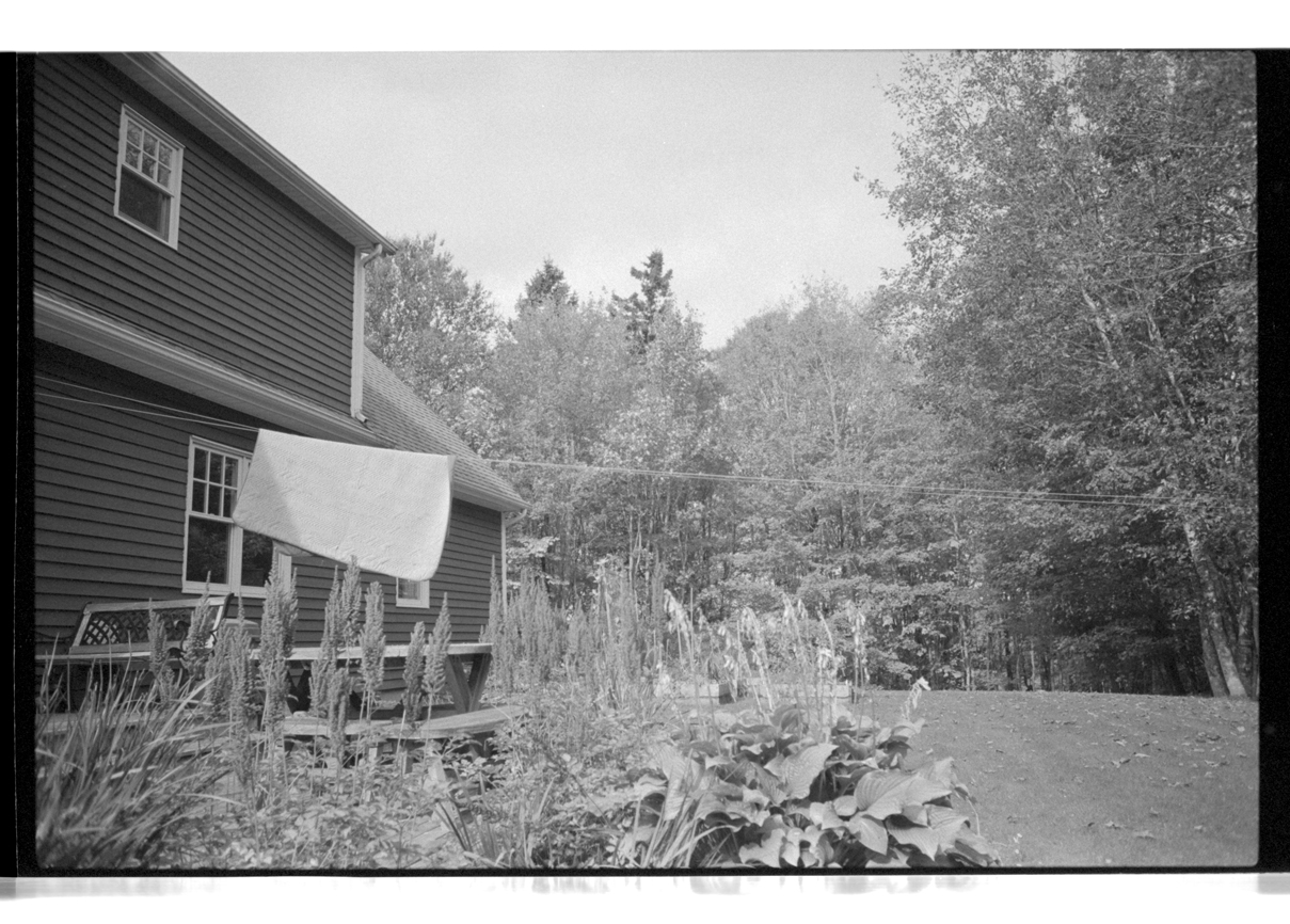

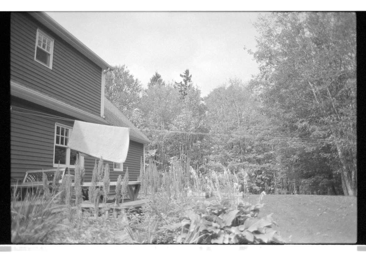

Hi everyone,
I have a Nikkor 28/3.5 which is a great little lens but I was hoping a 28/2 would be even better. I bought one used and it looked mint - no marks on the glass, little dust inside. However when used wide open at F2 the performance was terrible. I am attaching two photos of the lenses on a tripod wide open to show you how much worse the 28/2 was. Now I realize my old one wide open is F3.5 so it's not a true comparison, but there is something wrong with the 28/2, right?
The 28/2 didn't seem to have these problems once stopped down to 5.6 or so, but it did not seem to be quite as good as the 28/3.5 until after F8. Stopped way down it looked better that the 3.5 but this was due to improved micro-contrast rather than better resolution.
I returned the 28/2 but now I'm wondering if the image quality will be noticeably better than the 28/3.5 - it really is a nice little lens. Will I notice a big difference if I get a working 28/2 for real world use, or only if I shoot brick walls?
Thanks!

I shot the lens in all kinds of lighting conditions and it was the same story wide open. These two test shots both were taken with the sun behind the camera (partly sunny partly cloudy day), both on a tripod with cable release. Could someone have takenit apart at some point and put it back together wrong?

hmmm... so which of the two pix is "much worse" again?
the one with virtually no contrast, and extreme softness everywhere except the dead centre of the frame, and what looks like flare all around the edges of the negative.

Something seems wrong, both my 28mm f/2 don't look like this wide open. It does have front CRC like the 28mm f/2.8 Ai-s (which is an excellent refinement of the f/2 design BTW) and wide open you will see a bit of field curvature so make very sure what you have in focus is what you want, its not Flat Field and the later 3.5 is much better in this regards (and I think you're seeing some of this). Try the test again with more focus bracketing with f/2 you really have to nail the focus even if its a broad/landscape type shot. IMO the f/2 lens strength is mid to close distances (1-2.5 meters) when its wide open or close to it in low light.

thanks RidingWaves - I am pretty positive something was drastically wrong with the lens or else it would not have such a stellar reputation. FWIW I did extensive testing with all different focus distances and apertures and the thing was awful wide open and only rivalled the 3.5 after F8, as I said. In any case I am glad I returned it!

you picked a good real-world representation for your sample image test.th3.5 seems obviously better. Ithink, what you see is whar you'll get.

That 28/2 doesn't look right. Should be sharper and more contrasty even wide open. The 28/3.5 looks good. I have an Ai version of this lens and it's a great little lens and very affordable.
