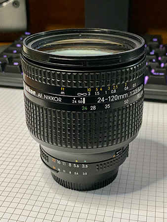

After my last repair project failed because I couldn't correct the focus infinity stop at the maximum zoom position, I'm wondering how to do this with Nikkor AF.
In particular, whether the focus stop is the same for all focal lengths.
With the Nikkor 24-120/3.5~5.6 AF-D (IF) I was not able to adjust the infinity stop.
My previous experience with MF zoom lenses from different manufacturers shows that this is solved differently for practically every lens.
In most cases, however, the adjustment should be possible without having to deeply disassemble the lens.

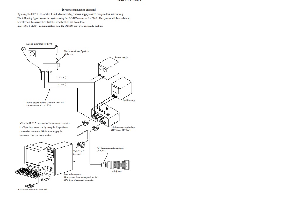

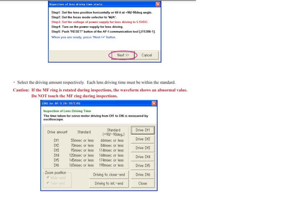

I suspect you have seen the service manuals for Nikon zoom lenses...
