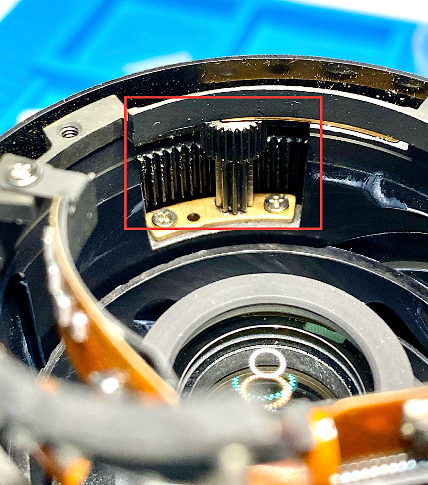

I can see both spots, but only from above at a steep angle. It's too narrow for a mirror.
What I can see looks ok. No deviations.

But I can't see whether the wipers and resistance tracks run parallel. To do that, I would have to be able to expose the part on which the tracks are applied.
Tricky
I opened the lens one last time to check the position of the wipers and the resistance tracks in relation to each other. I couldn't find any deviation.
However, to take a closer look I would have to dismantle the zoom further and I don't think that's a good idea. There is always the risk that the adjustment will no longer be correct afterwards.

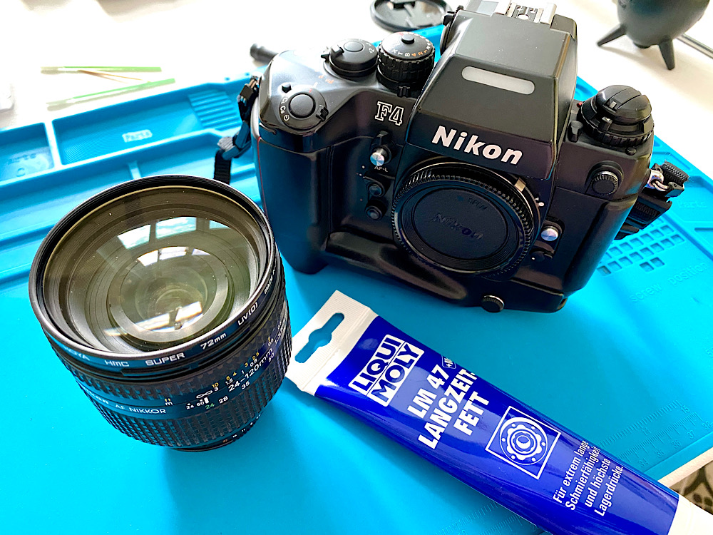

In order to be able to use the zoom in MF mode with some comfort - the focus ring is narrow and you can feel the gears of the AF mechanism when turning it - I lubricated the accessible gears and gear rings.
I used my toughest grease, Liqui Moly.
The focus ring now turns a little more smoothly and jerks less.

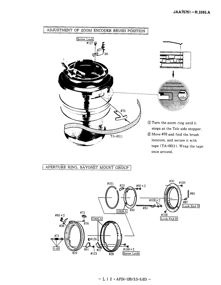

The solution regarding the stalling autofocus at the short end of the zoom was surprisingly simple after I looked through the repair manual again.

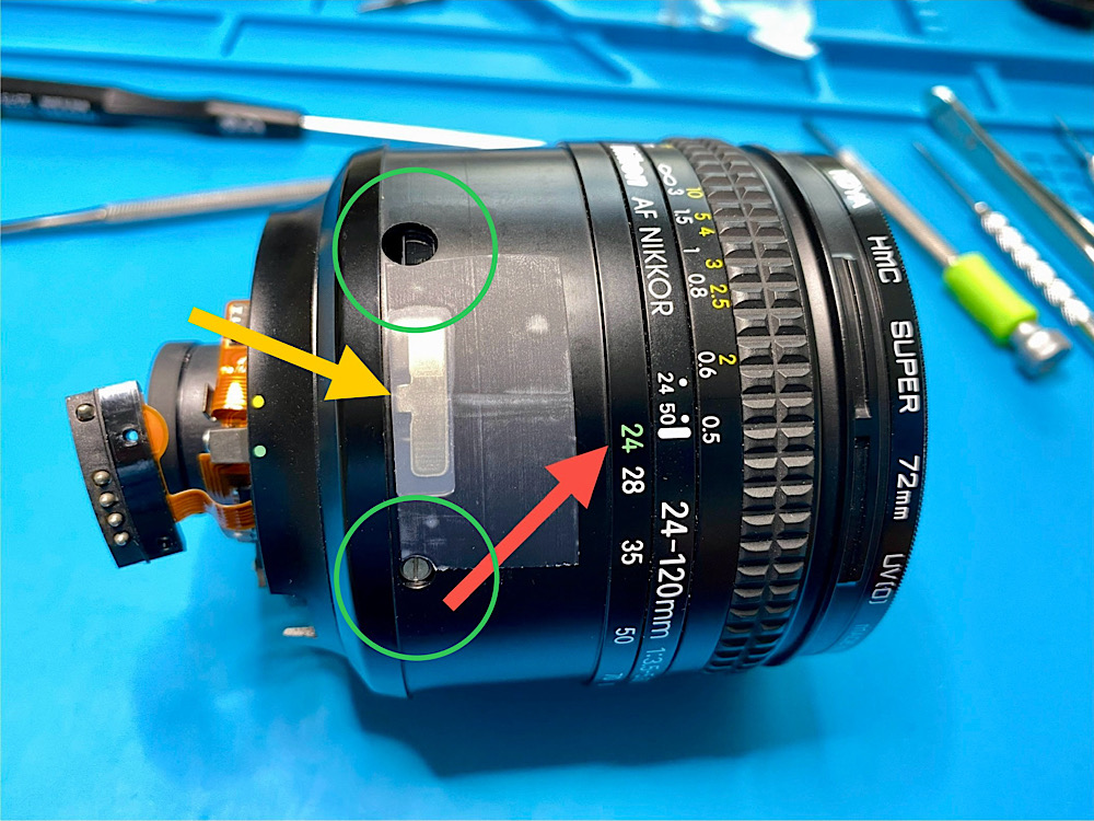

The wiper, which is moved with the zoom ring over the contact field in the tube, sits on a holder (see part #70 in the picture):
This holder is inserted into the zoom ring and can be moved. It is secured with an adhesive strip.

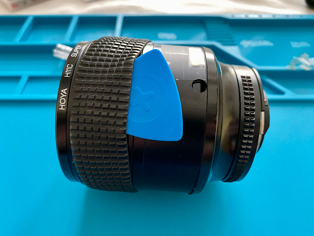

The holder is accessible when you remove the rubber coating from the zoom ring, which is easy to do here because it is not glued.
Here I have already removed the bayonet ring, which would not have been necessary:

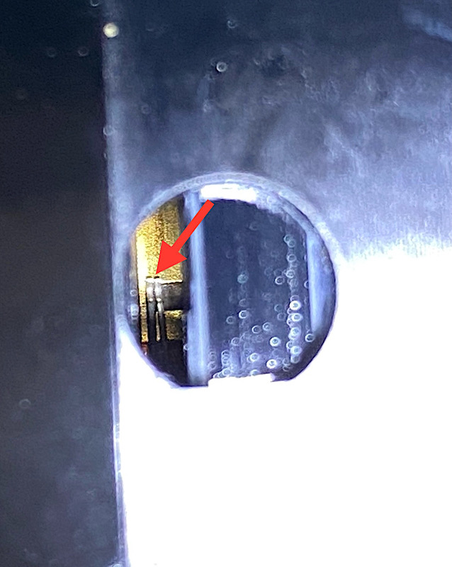

Through two openings (green circles in the picture) to the left and right of the holder (yellow arrow), the position of the wiper on the contact track can be observed:
This requires good lighting and a magnifying aid. I used my strongest magnifying glass.
I saw that when the zoom ring is set to the 24 mm stop, the two ends of the wiper are on a non-conductive surface. However, at all other zoom positions the wiper makes contact.
This matched my observation that the autofocus worked again without stalling when I turned the zoom ring a little towards the longer focal lengths.

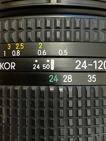

I also noticed that the 24 mm mark on the zoom ring is a bit below the white alignment line on the tube (red arrow):
Apparently the stop of the zoom ring at 24 mm was no longer correct. And this slight deviation meant that the slider coupled to the zoom ring no longer had contact.
There were three possible ways to correct the deviation:
  1. Adjust the glued contact track.
  2. Correct the stop of the zoom ring.
  3. Adjust the position of the slider.
ad 1: This would only be possible by removing the glue. This is not practical in the tight space, as neither solvent nor heat can be introduced in a controlled manner. In addition, the plastic construction rules out such measures.
ad 2: I could not identify the stop of the zoom ring, so it was not feasible.
ad 3: The solution, obviously also provided by Nikon

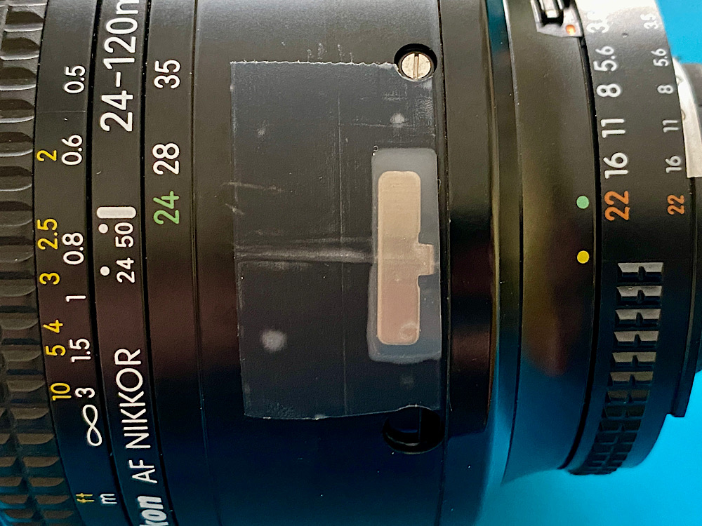

I removed the adhesive tape over the holder, levered it up a little with a screwdriver because it was stuck, and then visually adjusted the slider for the 24-millimeter position.
The wiper ends now sit just on the conductive gold contact track (and no longer on the non-conductive black surface underneath):
I fixed this new position of the holder again with adhesive tape:
I checked the position of the wiper at the maximum zoom position of 120 mm through the second opening.
Although the wiper is no longer centered on the contact track, the test showed that it makes perfect contact.

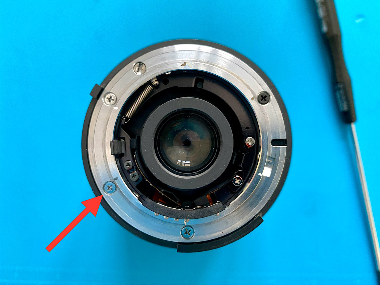

When tightening the bayonet ring, I overtightened one of the two short screws. This happened quickly because this screw engages a plastic thread:
Nevertheless, the bayonet ring is firmly in place, secured by the three other screws.

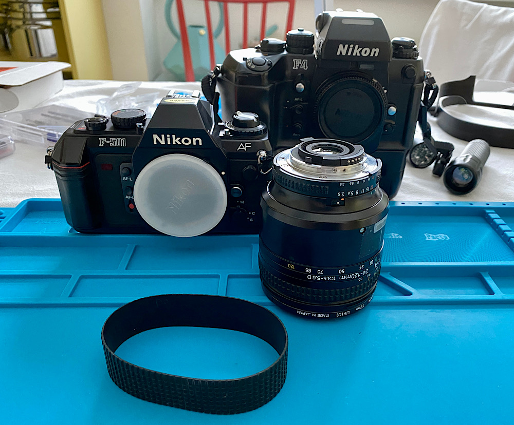

A test on my Nikon F-501 and Nikon F4 showed that the zoom focuses now without any problems:

Here you can see the deviation of the 24-millimeter mark from the alignment line to the right more clearly:
But you have to look closely.
I assume that the line has to be in the middle of the 24.
This difference from the target corresponds exactly to the small distance between the wiper ends and the start of the contact track.
The wiper is literally at zero.

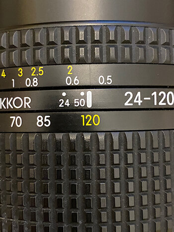

When set to maximum focal length, the line is in the middle of the 120:

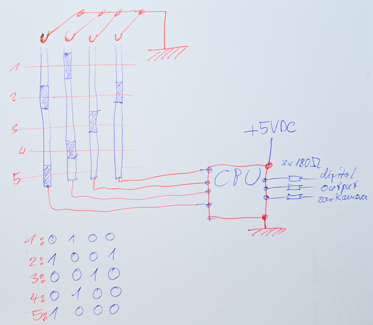

In the German Netzwerk Fotografie (NF) I asked Michael @forest bagger to explain the AF system here:
Michael, can you briefly explain the AF system, i.e. which signals the lens exchanges with the camera?
Beitrag im Thema 'Nikkor AF 24-120/3.5-5.6 D: langsamer Autofokus bei Brennweite 24 mm (Nikon F4S)'
https://www.nikon-fotografie.de/com...rennweite-24-mm-nikon-f4s.308788/post-2940418
His contribution in German with a hand sketch is worth reading, please use the translation function of your browser or Google Translate.
This 4 bit code is sufficient for the most zooms.
For some longer zooms there is a fifth track.
