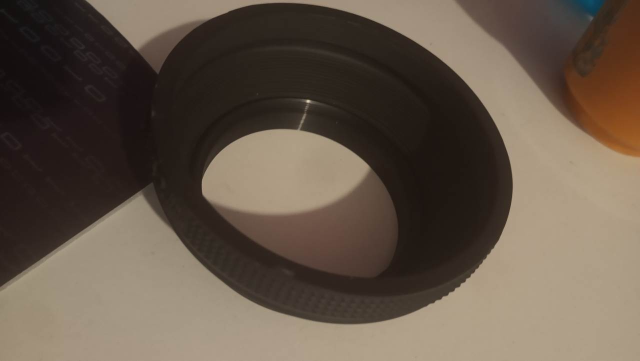

I have checked the curtains for pinholes and the viewfinder for leaks to the focal plane and this seems not to be the case. The hood might be the cause. Look at the metal ring how wide and reflective it seems (under room lamp):
Is that amount of reflection liable to cause that big of a burn on the film.?
