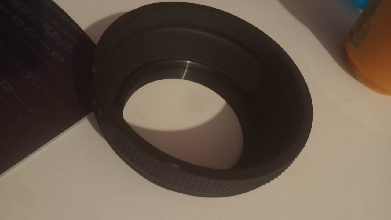

I have checked the curtains for pinholes and the viewfinder for leaks to the focal plane and this seems not to be the case. The hood might be the cause. Look at the metal ring how wide and reflective it seems (under room lamp):

The shadows in the second picture tell me that the sun was slightly behind him, so no direct sun on the shiny ring of the hood. I doubt it's that. I would think light leak from in front of the film, as shutterfinger suggests perhaps through the viewfinder. FA as a metal shutter, yes? These typically rely on the mirror blocking much of the light, a little light that sneaks in behind the mirror could get through between the metal blades.

The curtains are 100% light tight. Else there would had been marks on the negative in the space between the frames while advancing the film in sunlight with the lens uncovered. I tend to believe that this is a reflection of something shinny, perhaps from the sun reflecting from the lower metal part of the mount ring of the hood.
I think you might be right I suggest you get the correct Nikon lens hood for the lens, or paint the metal hood mount with matte black paint.
