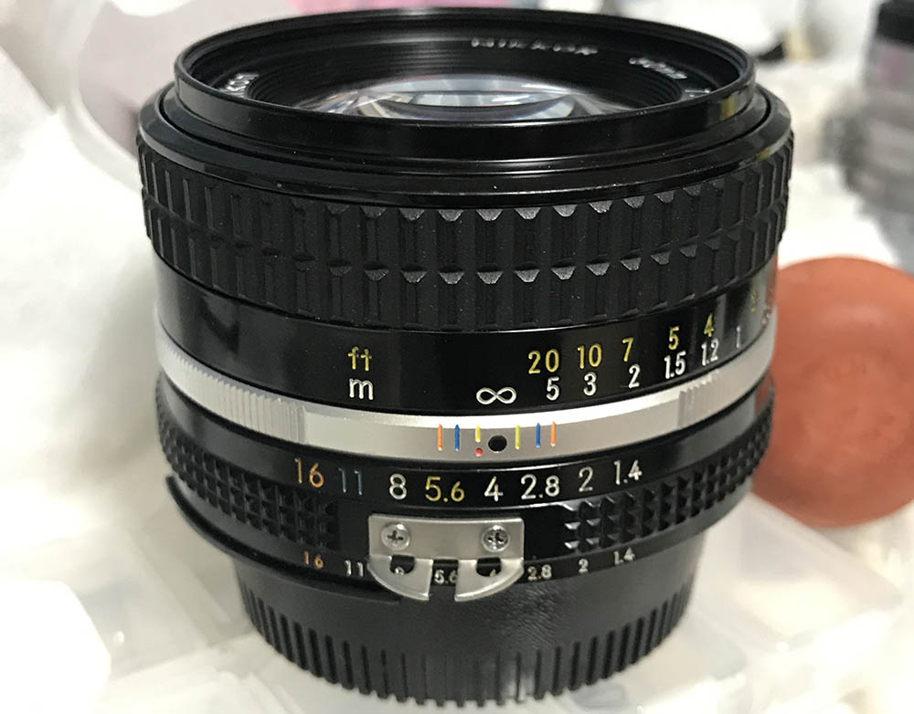

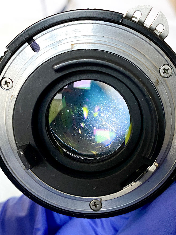

Convinced that helicoids do not always have to be separated for cleaning and re-greasing, I got to work.
A Nikkor 50/1.8 Ai turned quite dry when focusing.

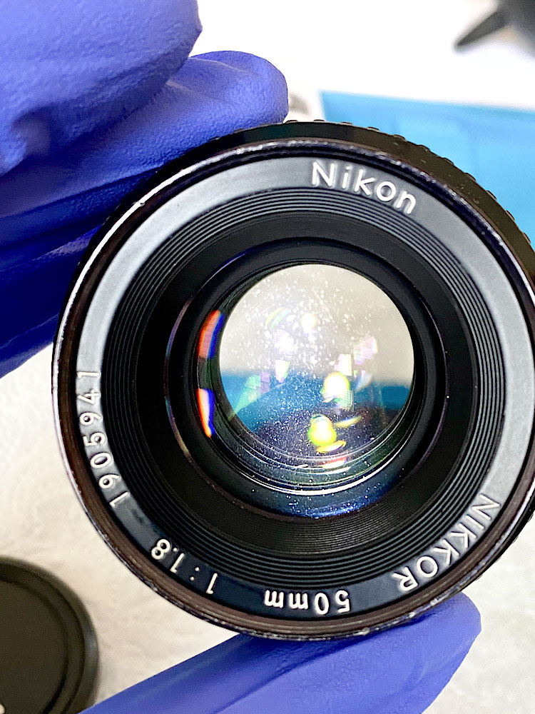

Some dust had also accumulated on the inner lenses over the years.
I wanted to remedy all of this.
Glow of dust in the LED light

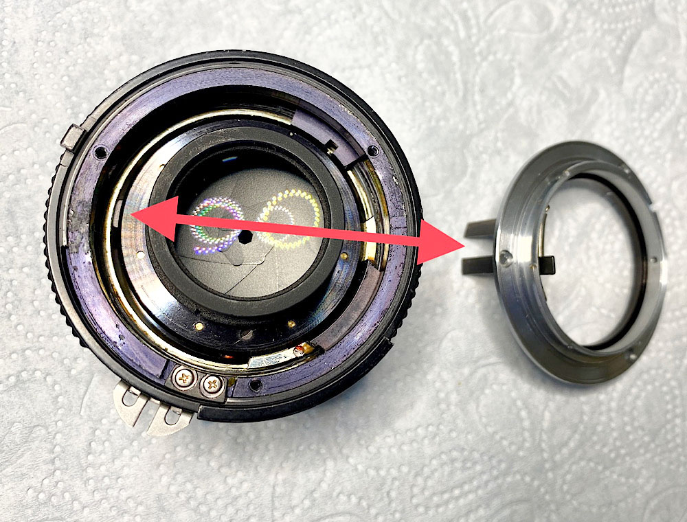

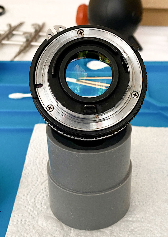

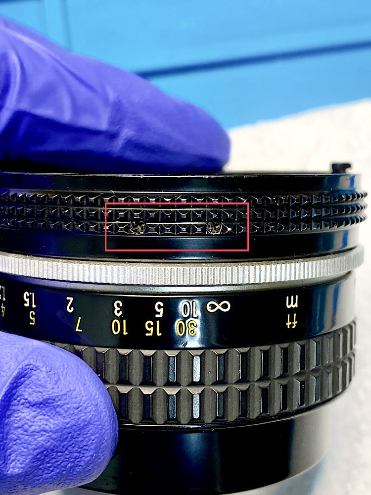

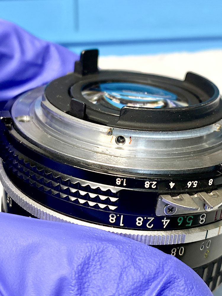

Fortunately and unexpectedly, these three bayonet screws could be removed without any problems.
The bayonet screws on a Nikkor are often very hard to loosen because they are secured with adhesive.
See on topic:

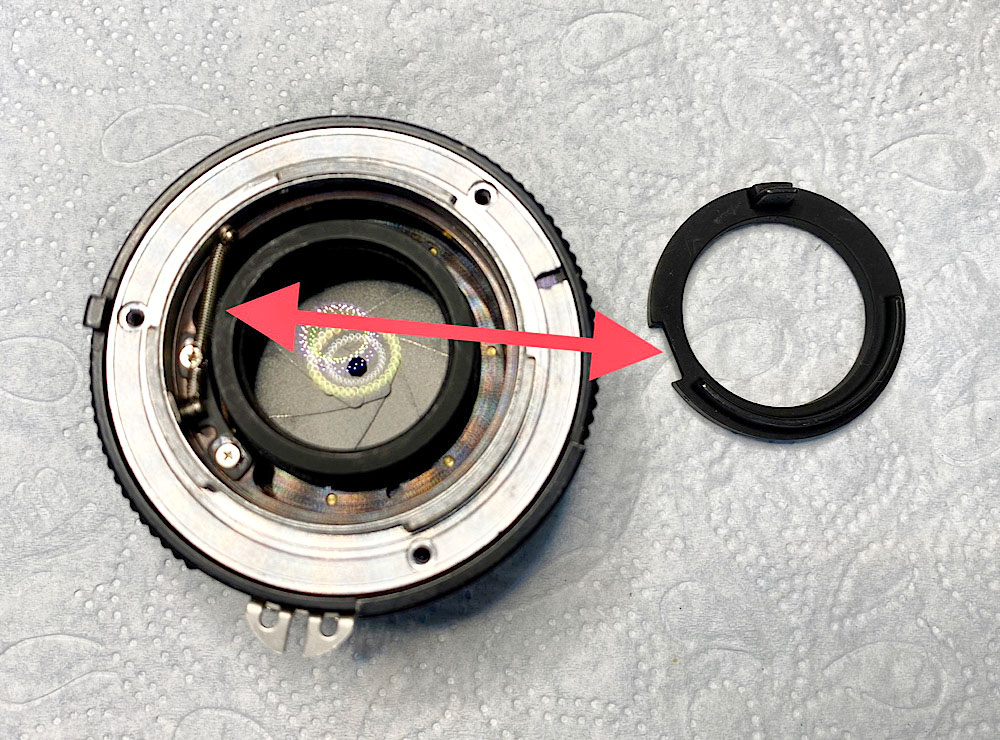

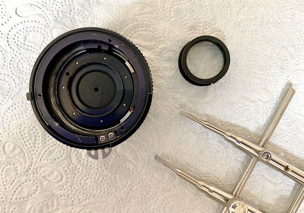

Three small screws hold the back cover in place, one of which is longer than the others.
A mark for assembly later can't hurt.
Photos for orientation as to what needs to be aligned with what.

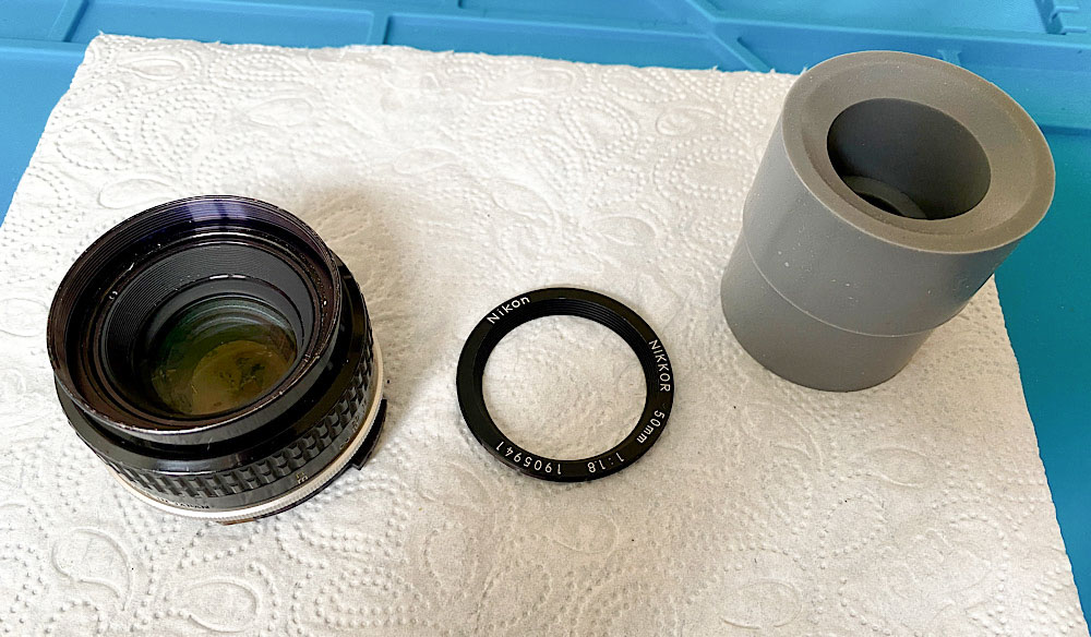

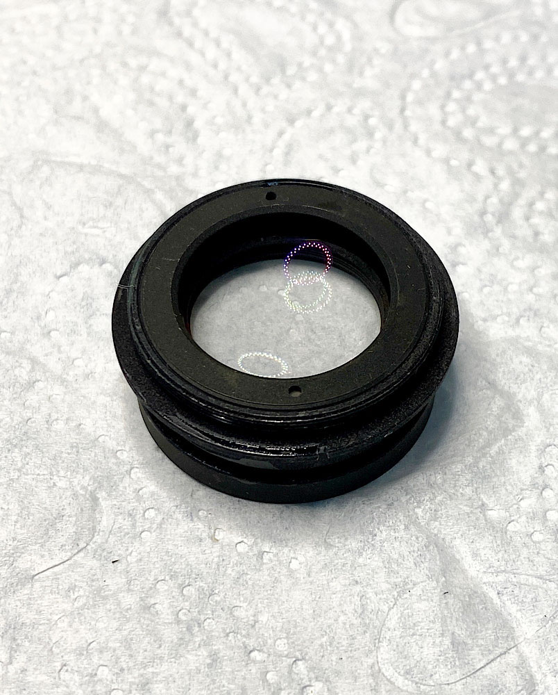

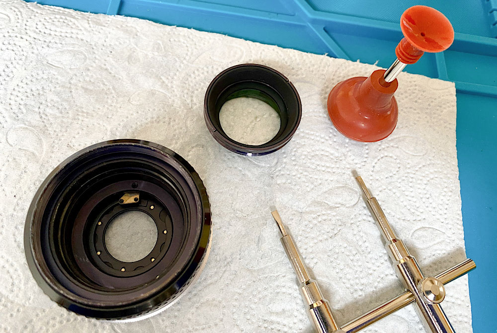

Using the spanner wrench, I take out the rear lens assembly.
It can be unscrewed after loosening.

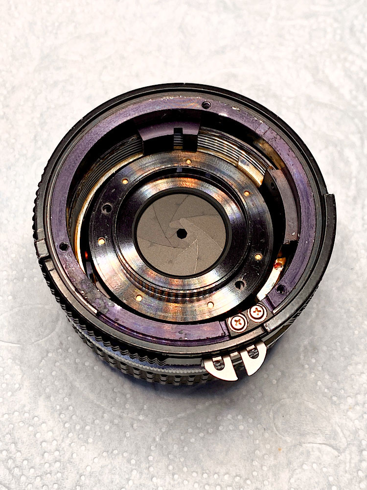

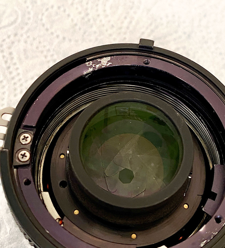

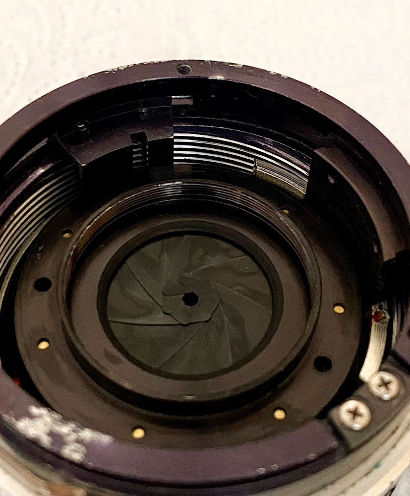

The rear side of the panel is exposed.

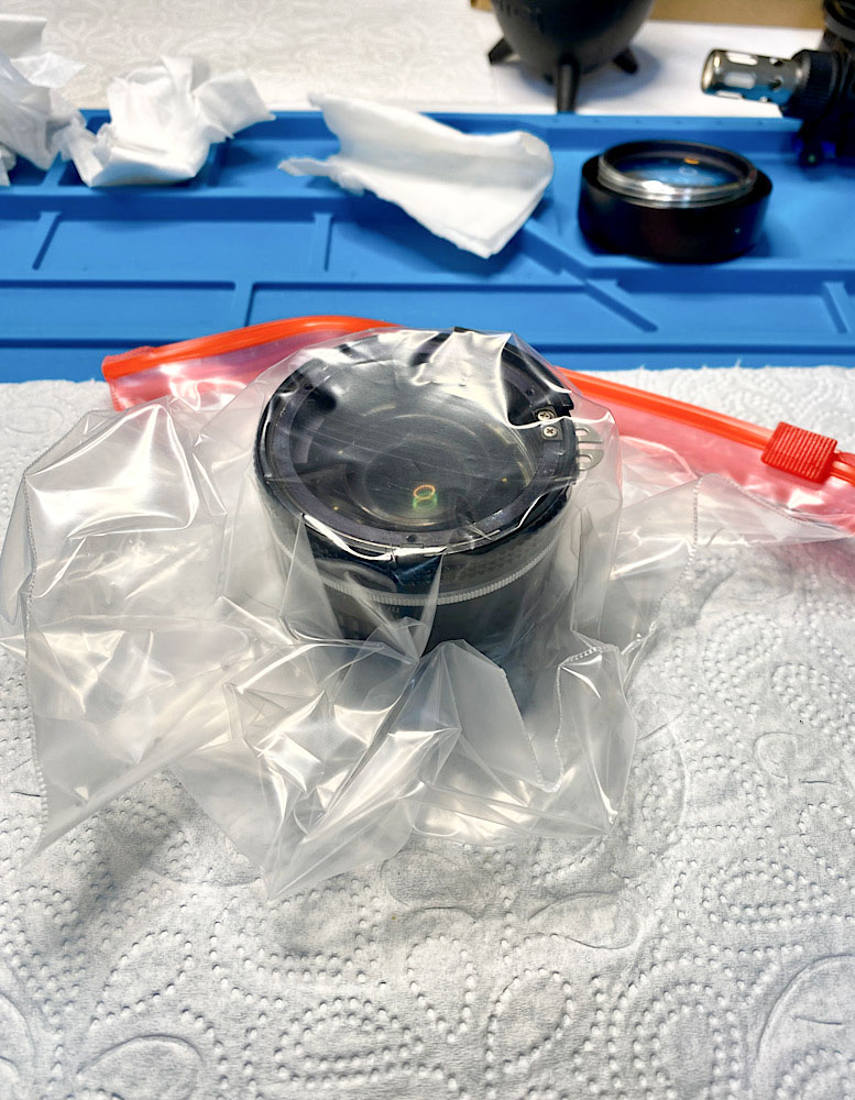

Take care, that the aperture locking ball, which is spring driven, does not jump away when the aperture ring
is removed.
A sealed plastic bag comes in handy for this.

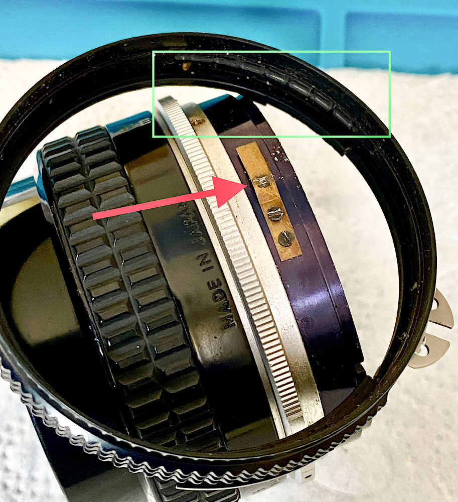

These two screws hold the aperture lever in the tube.
After loosening the aperture ring can be removed.
Ahh, there isn't a ball that is used to lock the aperture ring into place.
But rather a rocker that reaches into the recesses in the aperture ring.

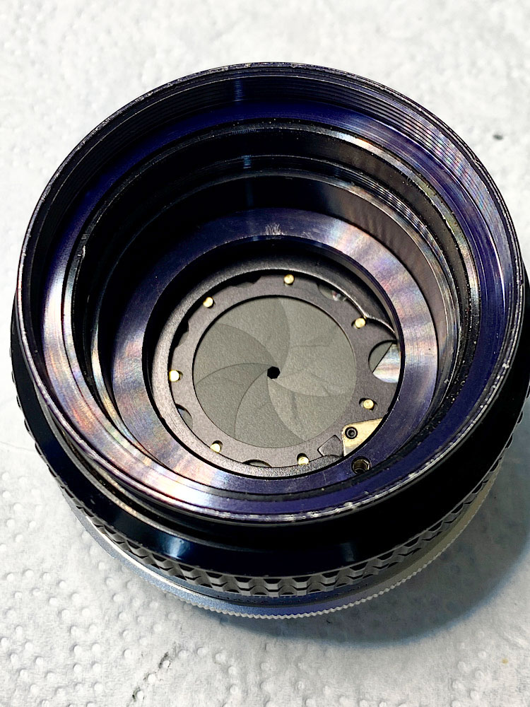

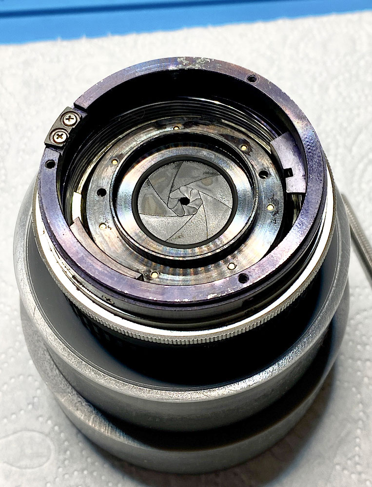

Removing the front lens unit.

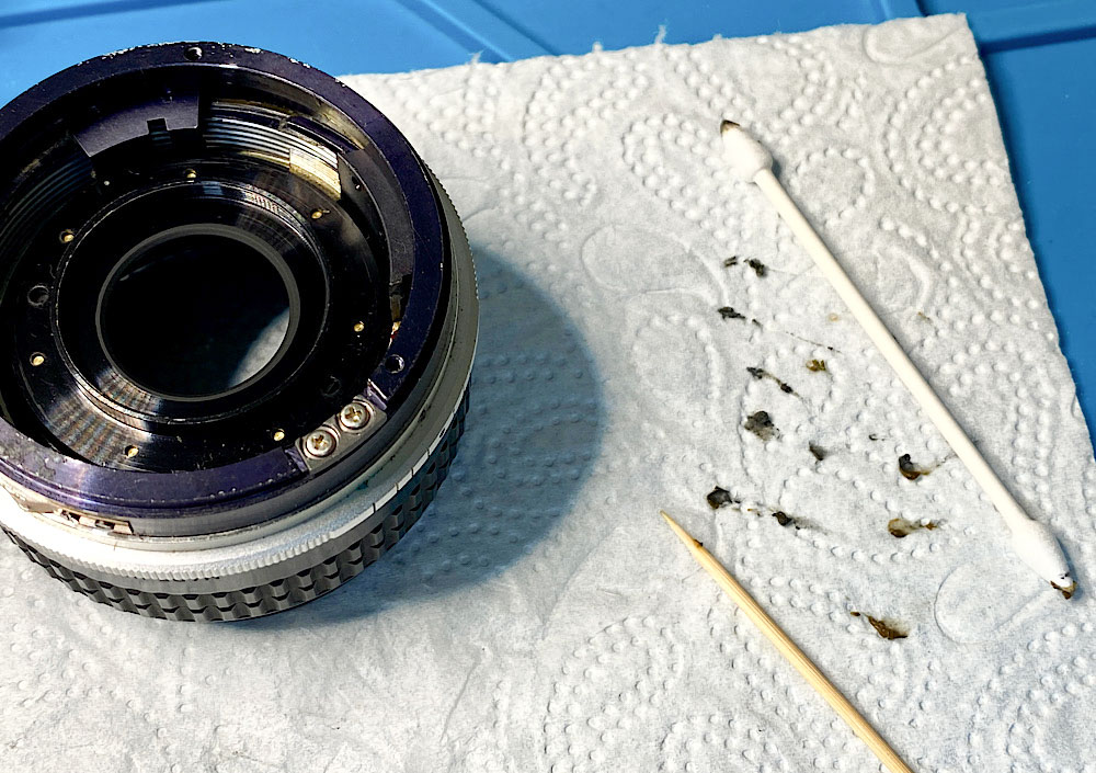

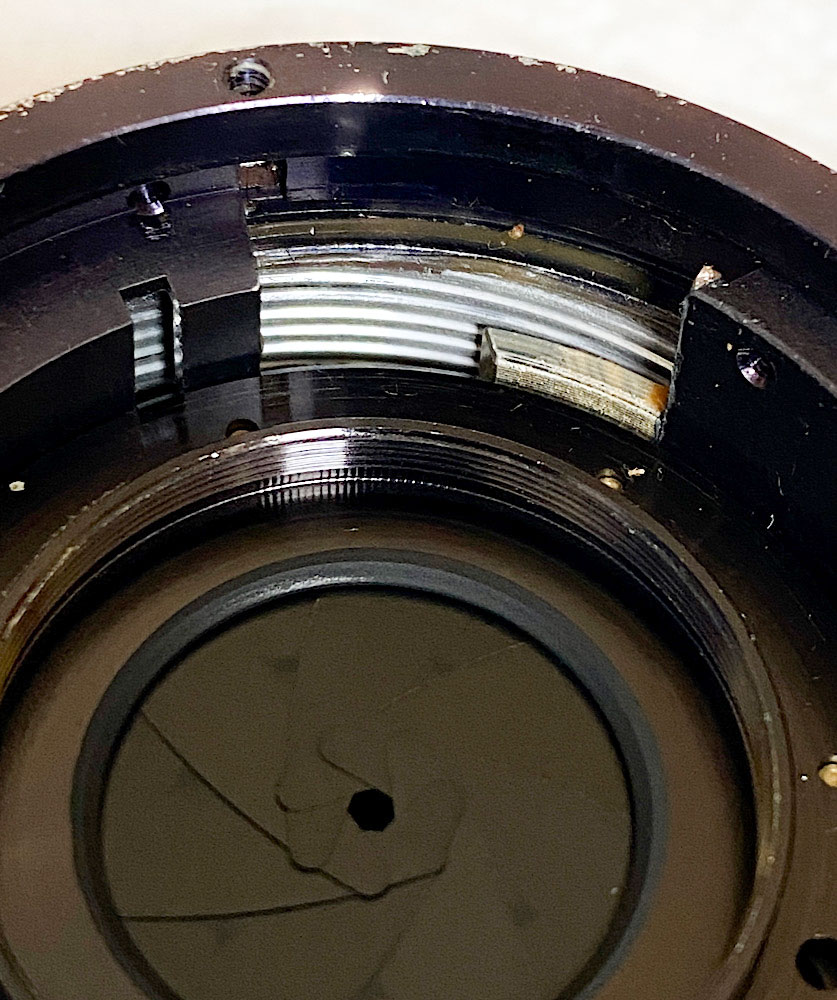

Old grease and dirt on one of the two helicoids.
That has to go.
View into the tube from the front.

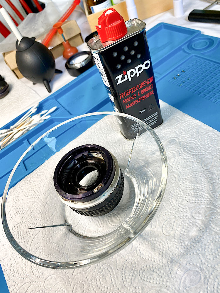

Mechanical degreasing 😉
Preparing the shower with Zippo lighter fluid 😀

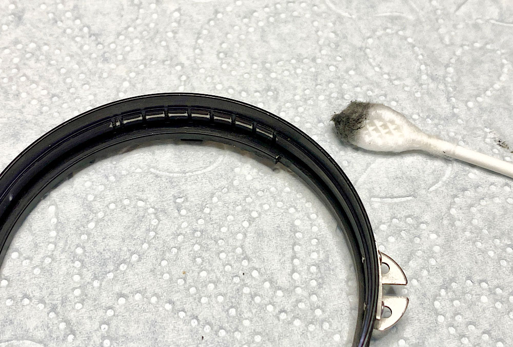

In several passes I rinse the helicoids with lighter fluid and turn the focus ring from lock to lock several times.
The grease dilutes and the lighter fluid-oil mixture runs off or is dabbed off with a cotton swab.
The aperture register also comes into play when flushing.
I dry the tube with the hot air blower and move the aperture blades until they are dry and run smoothly.
Process temperature is 80 degrees Celsius (= 176 degree Fahrenheit), the air jet is weak.

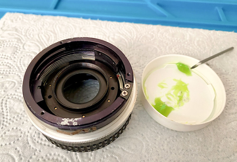

It's clean here now 👍

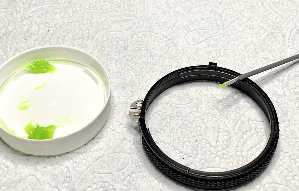

Apply Castrol LMX Li complex grease sparingly to the accessible part of the helicoids.
After turning it in and out several times, the focus ring runs smoothly.
The aperture ring is cleaned with Zippo, including the recesses for the rocker, where old grease is still found.
Then put some of the Castrol on here too.

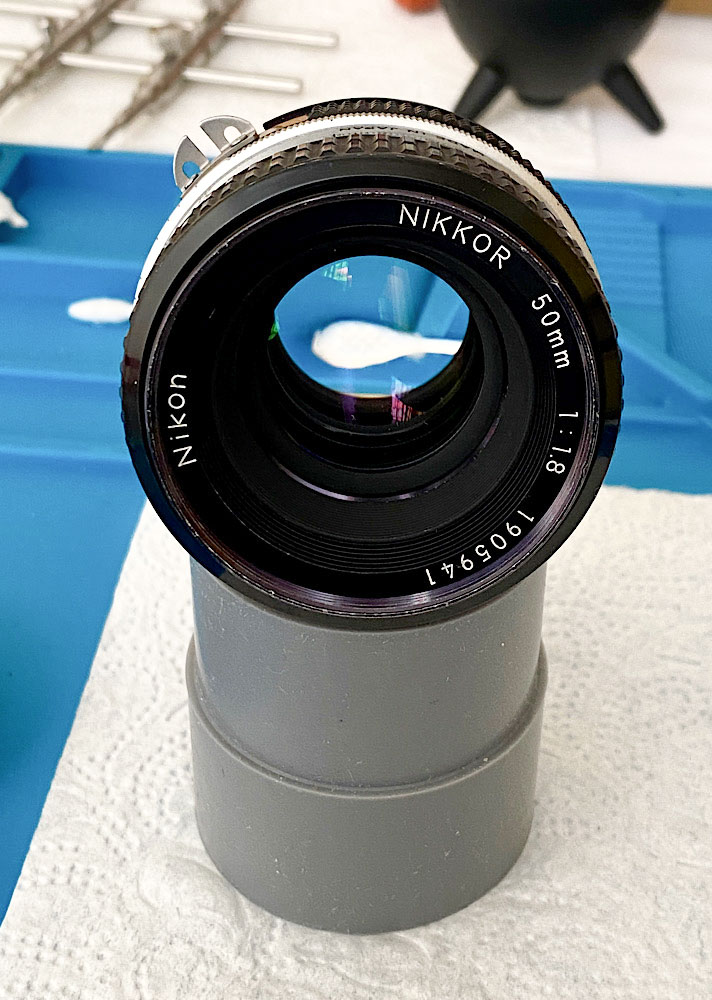

Assembly

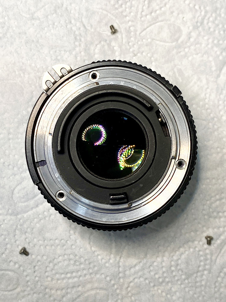

The rear lens assembly is back in place.
Lenses clear, focusing smooth again, nothing damaged.
Mission achieved 👍

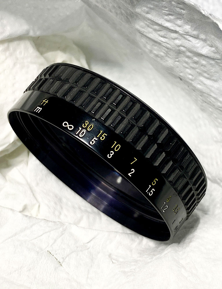

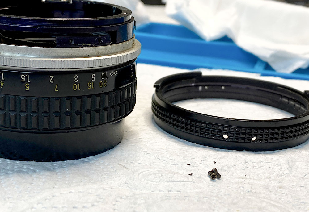

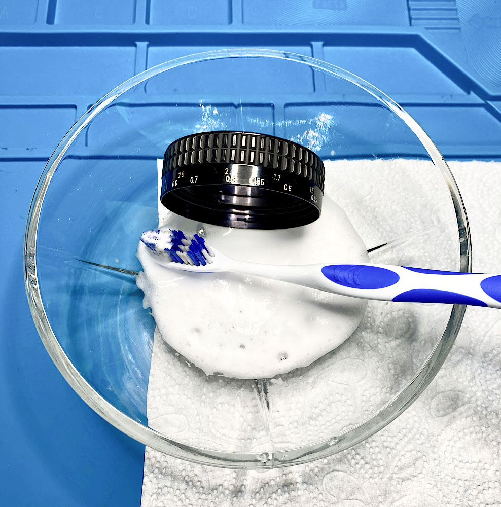

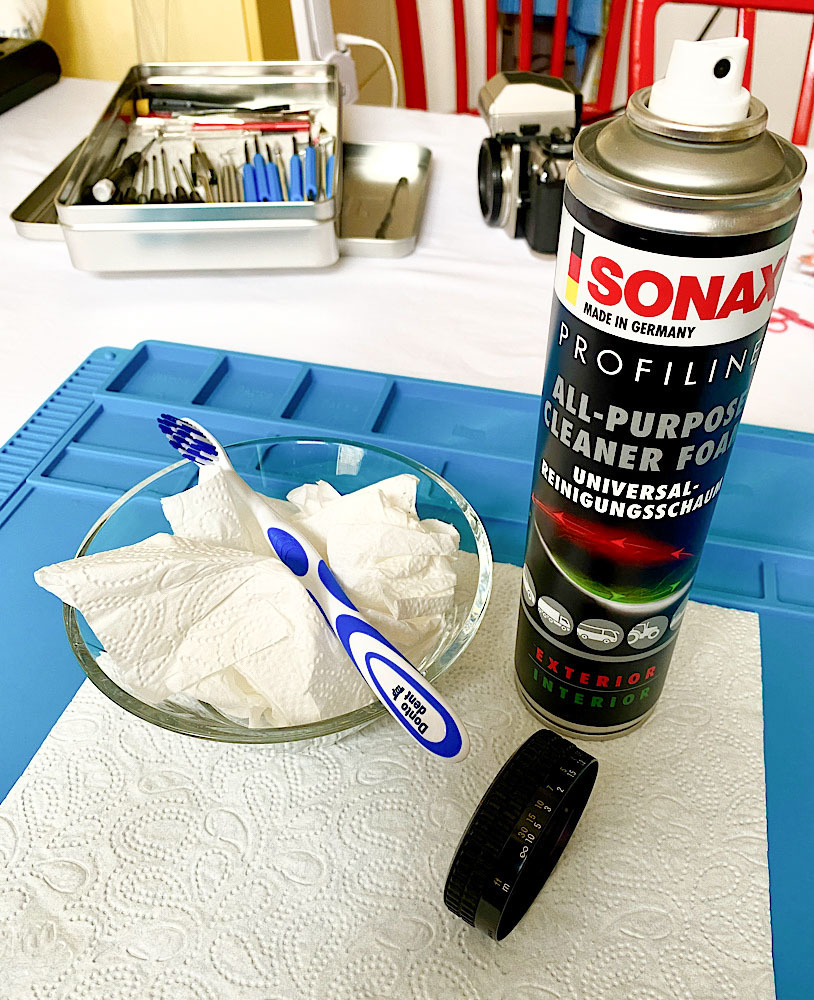

Later, I took the focus ring off again to check whether the new lubrication was ok.
On this occasion I cleaned the ring with Sonax Profiline All-Purpose Cleaner Foam using a toothbrush.
Drying is enough and the engravings shine again.
The rubber grip ring is also fresh again 🙂
