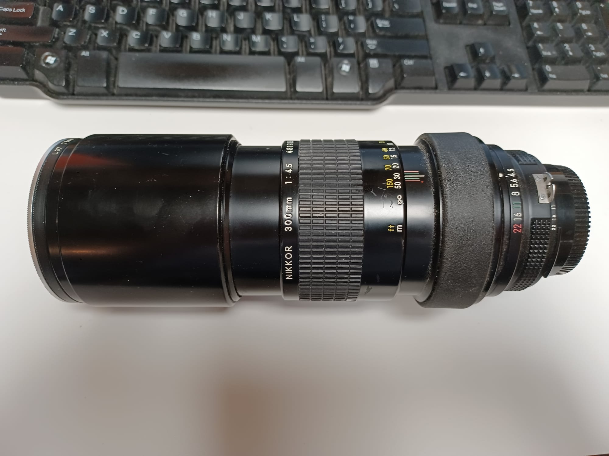

Hi
hard stop on focus adjust at infinity before focus achieved. Can this be adjusted? Lens focus great upto horizon.

Thanks for the info Kino. I did previously look at that web site but he didn’t have my 300 on it. He has an exteriorly similar 200, so I looked at that guide.
but the fix was simple (?), under the rubber focus grip the are 6 jis screws in slots. These were in mid range, so I loosened them and twisted barrel to allow infinity +. Focusing on objects 1km now show up much better.
