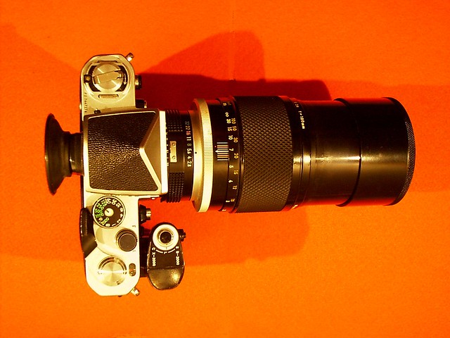

In 1971, I purchased a brand new 180mm f/2.8 Nikkor.
I have been using the same 180mm f/2.8 Nikkor lens since I purchased it from Altman's Camera in Chicago in 1971 for $386.
The 180mm f/2.8 Nikkor has been one of my three Nikkor lenses with the best image quality (55mm macro and 105mm macro were the other two).
In the early 1980s, when Nikon issued the AI version with ED glass, I decided not to upgrade but to have Nikon convert my pre-AI lens to an AI lens.
If I remember correctly, the 180mm ED glass version is 5 lenses in 5 groups while the pre-AI glass is 5 lenses in 4 groups.
Around 2005, I compared the Nikkor 180mm f/2.8 with the Nikkor 70-200mm f/2.8 and the 80-200mm f/2.8. I was surprised that at the 180mm focal length, the 80-200mm f/2.8 AF-S and the 70-200mm f/2.8 zooms were equal in image quality to my older 180mm prime.
