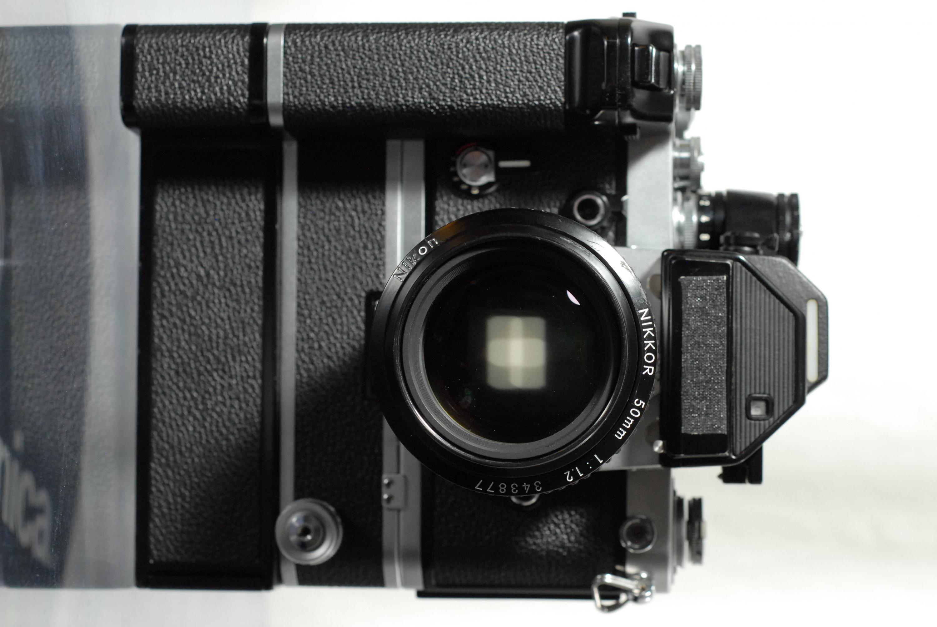

I was a little hesitant, but I decided to post an update. I have assembled and reassembled the outer-barrel so many times now, I could do it in my sleep. I received some really great instructions and advice for cleaning and regreasing the helical threads, which I followed. The focusing action was smoother afterward, but there was still “slop” or “play” when switching the direction of the focusing ring. And with the lens open, I could see that the slots and focusing keys were not mating properly—the keys jiggled back and forth with an audible clicking sound, even with a generous amount of helical grease applied to the slots that the keys travel in.
So I tried swapping the keys. There’s no play at all now, not even the tiniest bit. My lens is back together and I’m happy.
HKD_7904 by LJ Slater, on Flickr
Thanks everyone for your input and for not being too harsh on a novice who risked ruining his lens to get to the bottom of a maddeningly bothersome problem.
